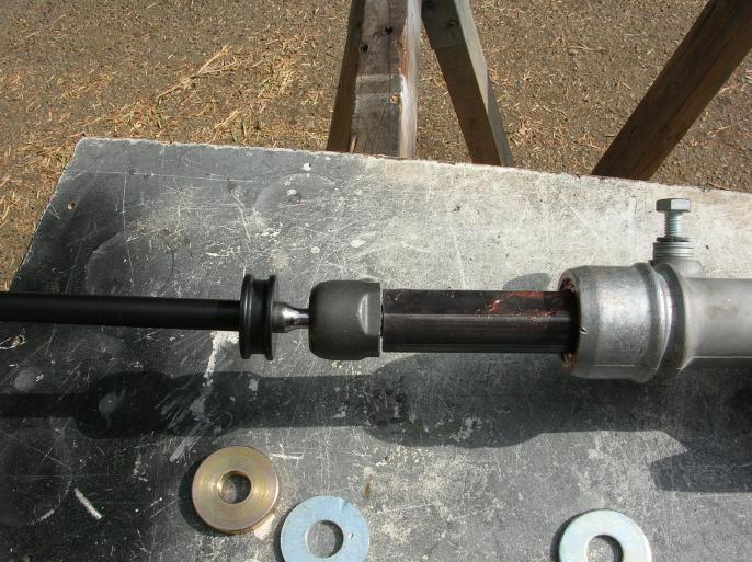

A thin washer will work just fine. Also note that in this case, the TTR didn't even seat correctly without a washer. (photo credit Wes V)

The thin washers pictured above have the same OD as the supplied thick washers. You'll want something with the same OD to act as a stop.
The factory washers are:
45mm OD
16.5mm ID
7.5mm thick
(quoted from another thread, I didn't measure one)

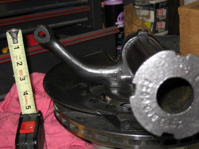

'69 T Struts.

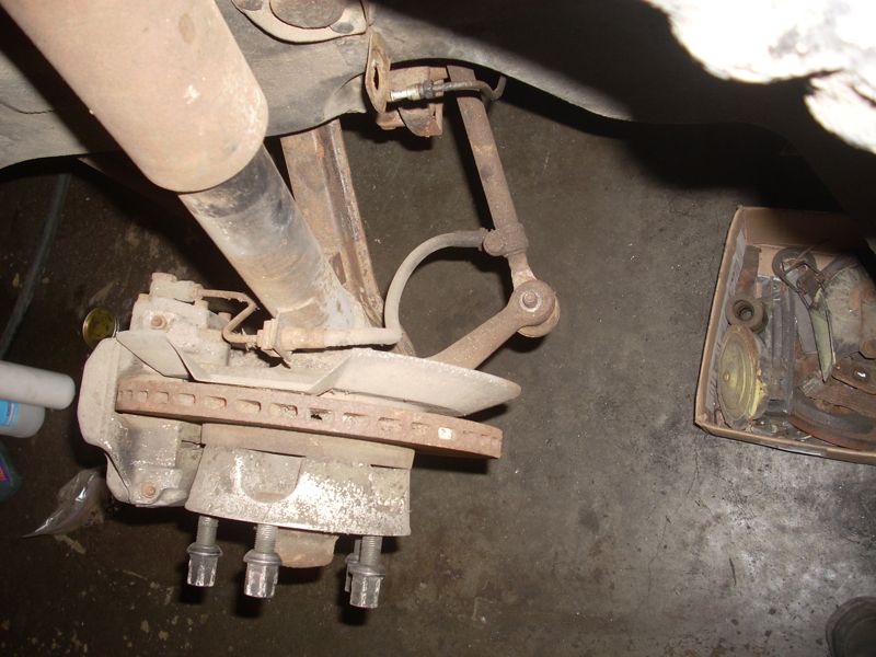

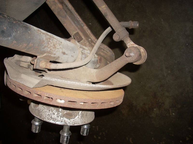

I believe this to be a 911T strut I'm putting on soon along with TTR's.
And my old 914 Bilstein strut
BTW, is there a special type of grease to use on the rack? I noticed a red colored grease in Wes' photo the McMark posted.

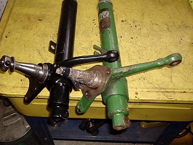

It would be nice to lay them on their backs, each with the spindle arm touching the ground and see if the spindle angles are all the same.

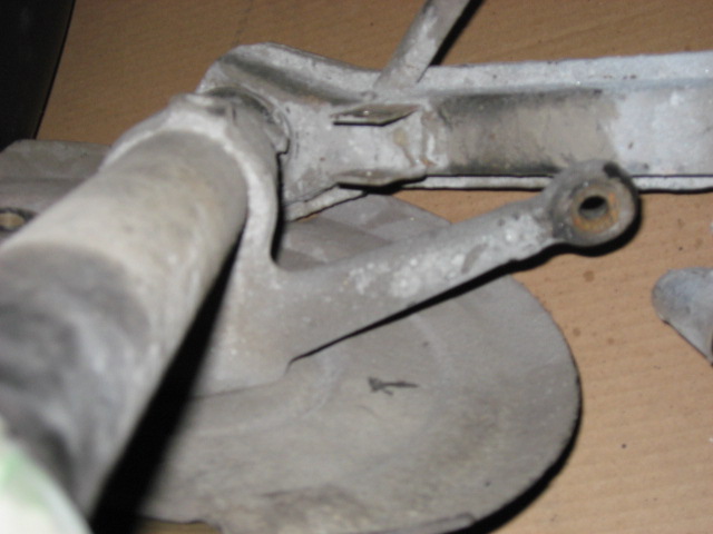

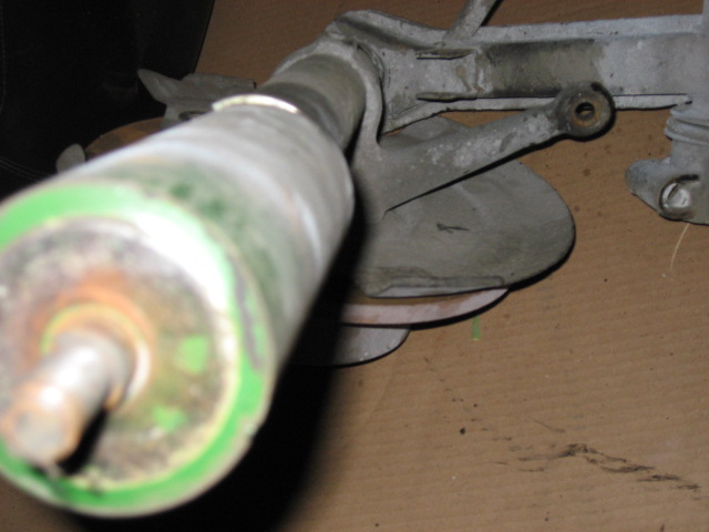

Here is a picture of a 75 911 Boge and 73 914 Bilstein. Boge is bent back and the Bilstein is straight. I looked a the 914 Boge and it is also straight and measures the same as the Bilstein. Here is were it gets VERY INTERESTING, the 911 and 914 both measure approximately 7 1/2" from the center of the spindle to the center of the tie rod hole. So, it proves me WRONG.
