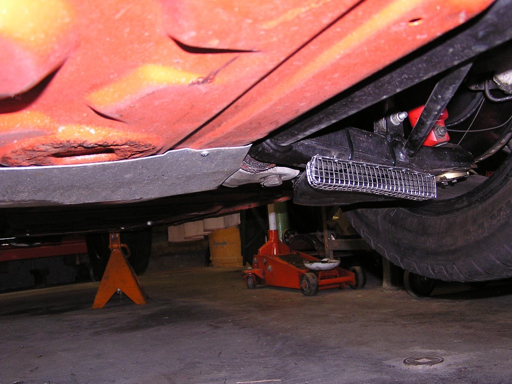

this picture is not the best... but I didn't take good pictures of the underside of the floor pan where it showed the best. I ended up repainting the wheel wells:
brant
post Dec 29 2005, 09:13 PM
Posts: 12,010
From: Colorado
Member No.: 47
I just realized that this picture was taken at the end of the season with LOTS more rock chips and wear than it had right after I completed the scrapping.
look at the aluminum pan in that picture. Its all beat up with dings. was shinny when first installed.
point is that the paint looked pretty good right after I finished.
probably will take a lot more wear without the undercoater on it.
of course I did it for weight and not appearance. (25-30lbs... we swept the floor each day and accumulated all of the droppings into a bucket that we weighed when finished.)
brant

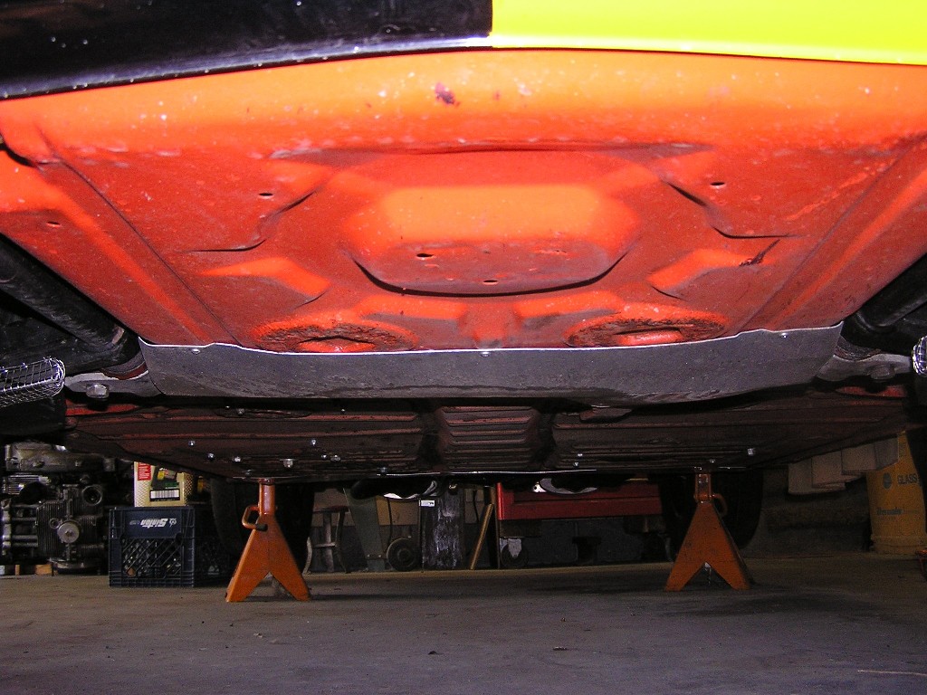

other picture not as close up:
