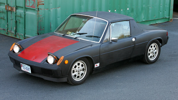

I built the lightest 914 in the history of mankind. ![]() ![]() ![]() ![]() ![]() ![]() ![]() ![]() ![]() ![]() ![]() ![]() ![]() ![]() ![]() ![]() ![]() ![]() ![]() ![]() ![]() ![]() ![]() ![]() ![]() ![]() ![]() ![]() ![]() ![]() ![]() ![]() ![]() ![]() ![]() ![]() ![]() ![]() ![]() ![]() ![]() ![]() ![]() ![]() ![]() ![]() ![]() ![]() ![]() ![]() ![]() ![]() ![]() ![]() ![]() ![]() ![]() ![]() ![]() ![]() ![]() ![]() ![]() ![]() ![]() ![]() ![]() ![]() ![]() ![]() ![]() ![]() ![]() ![]() ![]() ![]() ![]() ![]() ![]() ![]() ![]() ![]() ![]() ![]() ![]() ![]() ![]() ![]() ![]() ![]() ![]() ![]() ![]() ![]() ![]() ![]() ![]() ![]() ![]() ![]() Group: Members Posts: 132,655 Joined: 3-February 03 From: Jacksonville, FL Member No.: 222 Region Association: None |
I'm about ready to prime and paint my car and the question is...
Do you think I REALLY need to prime it? a. It is a race car so the paint only needs to look good from 15 feet. (IMG:http://www.914world.com/bbs2/html/emoticons/wink.gif) b. It is fiberglass. (IMG:http://www.914world.com/bbs2/html/emoticons/dry.gif) c. Let me say it before someone else does: It will add weight. (IMG:http://www.914world.com/bbs2/html/emoticons/laugh.gif) Now will the finish coat stick w/o a primer? Or do I need a primer over f/g? I plan on using a Du Pont Nason product called Astron synthetic enamal with a hardener. It's a inexpensive (cheap) paint brand. Whata ya think??? Paul |

What type of finish is on the glass now? is it gel coat? I started priming all the glass on my car, then tried just paint over the gel coat, and it works fine.
Im using a waterbased color coat, and on of the Dupont clears |

Some areas have gel coat but I'll mostly be repainting over my old paint job. |

What about stripping the old paint, put a lite coat of primer for adhesion, and maybe 2-3 quarts of paint, I wouldn't think that the overall weight gain could be that much. |

The weight of the primer is not really a big issue, just a joke. (IMG:http://www.914world.com/bbs2/html/emoticons/biggrin.gif) I was trying to save a step really. If I need light coats, I'll do it. I could spray on some light coats and wait a few hours and shoot the finish. Right?

(IMG:http://www.914world.com/bbs2/html/emoticons/owned.gif) (IMG:http://www.914world.com/bbs2/html/emoticons/laugh.gif) Yes, I would put a couple light coats then finish coats, it should be fine. (IMG:http://www.914world.com/bbs2/html/emoticons/smile.gif) |

[QUOTE] could spray on some light coats and wait a few hours and shoot the finish. Right?
I am questioning the wait a few hours for finish coats, you should only let the paint tack up between coats for better stick..less chance of contamination and defects in the finished product. Check with paint manufacturer...longer for cold climates also |

400 grit and shoot the paint.
It will stick fine. clean clean clean...and de-grease. We just used the cheapest paint off of ebay...40 bucks a gallon and it sticks fine, no primer over the old paint.. The only reason to strip /prime is if the old paint is not sticking now, or if you have cracks in the paint. Go for it in one shot..it will be great. Rich |

That is the answer I was waiting for. (IMG:http://www.914world.com/bbs2/html/emoticons/laugh.gif) |
