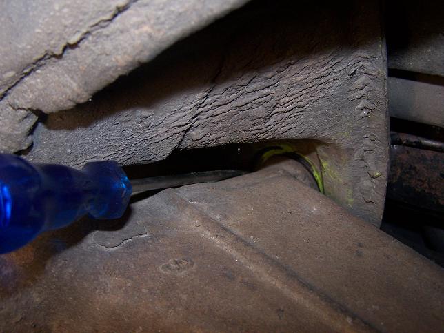

Then on further inspection, I found the driver side rear swing arm has a bad bushing. The shiny part of the suspension ear shows how the trailing arm has been moving around. The blue screwdriver is in a hole in the metal caused by the movement of the arm at the pickup point.

you cant get rubber bushings....
the alternatives are
Poly (weltmeisters)
Poly Bronze (elephant racing)
Roller bearings (mueller)
delrin (racer chris)
so there is a hole in the bushing? or a hole in the mounting ear?
make sure your suspension ear is not ovaled....

After 30 years I'd be willing to bet the bushing is shot. I'd also be willing to bet that's not your main problem.
I don't think it (a worn bushing) would allow that much travel. I'm going out on a limb and say that the hole in your suspension ear is ovaled.

QUOTE (Eric_Shea @ Feb 28 2006, 01:41 PM)
E.
That was my first thought, that the nut was loose and wobbling around. The nut is as tight as a good .... Oops, almost said something I might regret. Well, suffice to say that the nut is very tight and there is a tremendous amount of play in the arm. There are bits and pieces of bushing in that area.

QUOTE (Spoke @ Feb 28 2006, 11:03 AM)
i'd still check on that ...
you have to take the trailing arm off anyways, so make sure the shaft hasn't worn out the hole. it should be a schnugg fit ...
oval suspension mounting holes suck!

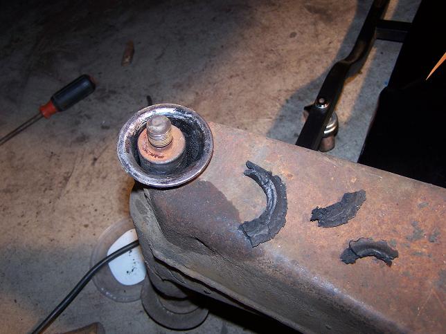

Thanks all for the info and offers. Much appreciated. This site rocks!!!! Actually, you folks on this site rock! (IMG:http://www.914world.com/bbs2/html/emoticons/aktion035.gif)
I have located a replacement trailing arm locally with good bushings, bearing, and hub. I'll pick it up tonight and start (er, continue) the madness. $20 can't go wrong.

I guess there used to be a bushing in there.
