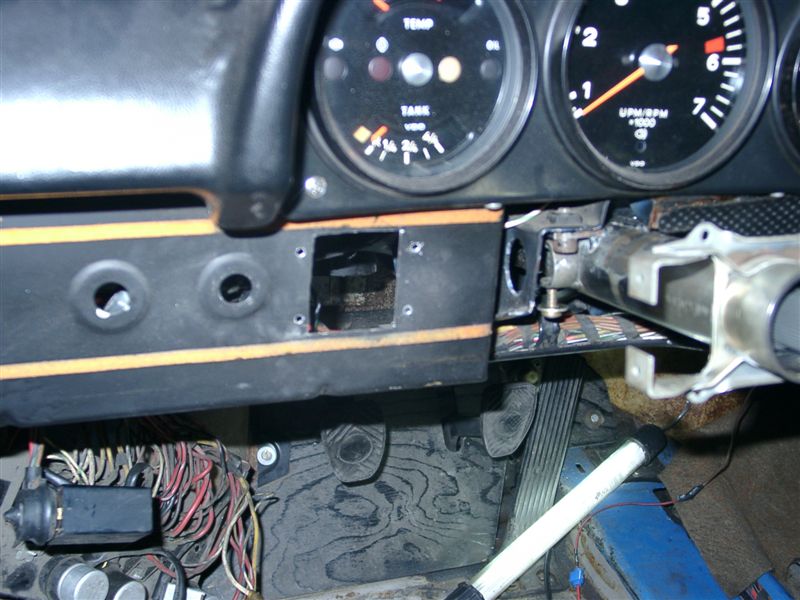

All you need to build a clone 6 column is to take the mounting pad off your current steering column and weld it to a 69-73 911 steering column with the brackets removed. You can also do the same thing with a 74-89 911. I can provide pictures if you want them of the real 6 column and both conversions. I cannot post them because my camera now only takes 1200x1600 pictures. It lost its mind and will not adjust.
Contact me at a914nut@email.com.
I would like to try a set of the Clips for my column. I have a NOS 6 dash, NOS dash trim pieces, covers and 6 column that I have off car that I can test fit to.
Thanks, Mark.

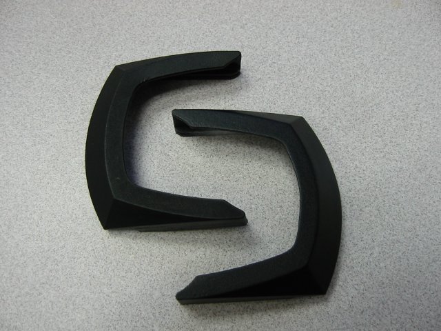

Here is a pic of the old one and the repro that I produced. The old one is the upper one, it's a little warped.
The repro was produced on a rapid prototyping machine, ABS plastic. Then sanded and painted.
Thanks to Wayne for starting this project off and providing me a sample!

echocanyons
post Mar 29 2006, 01:35 PM
Posts: 2,115
Joined: 24-December 02
From: Bay Area, CA
Member No.: 7
So Todd did you make a run of these?
Can I get a pair?
Goge
post Mar 29 2006, 02:01 PM
Posts: 53
Joined: 3-September 05
From: Portland, OR
Member No.: 4,746
Kelly-
I can kick out a new set whenever, they will just be made to order.
I think right now we're looking to find someone to fit them up to make sure the fit is OK, we haven't even discussed pricing yet. They won't be super cheap... but that's the way one-off parts go usually.
I'll leave it up to Wayne to pick someone to test them for us.
-Todd
