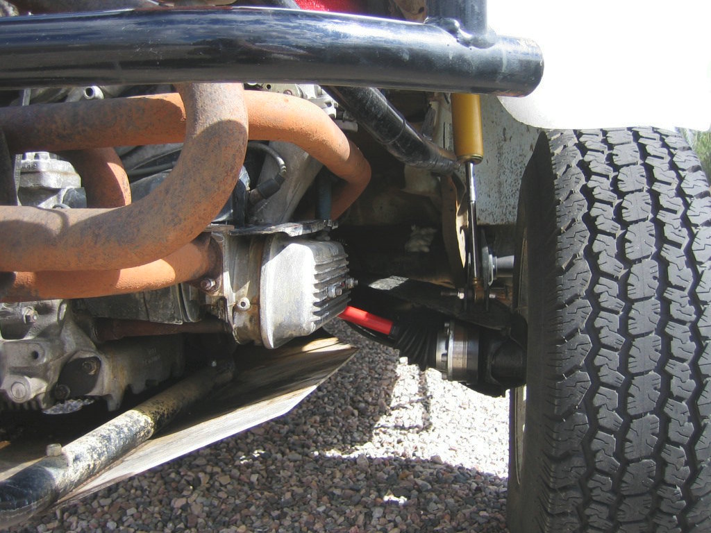

Here is a shot of a T-1 buggy with the exhaust header on the back side of the head. If this was a t-4 it would be under the head.

In my bucket analogy I wasn't using gavity as the having an effect on the gass passing through the bucket. I was explaining that a 90 degree change in direction will "slow" or restrect the exiting gases from exiting the bucket verses a stright line.
"If you increase the turbulence you reduce the velocity and hence reduce the flow."
And gases having to exit at 90 drgrees from the intake valve will create turbulance.
We agree.
