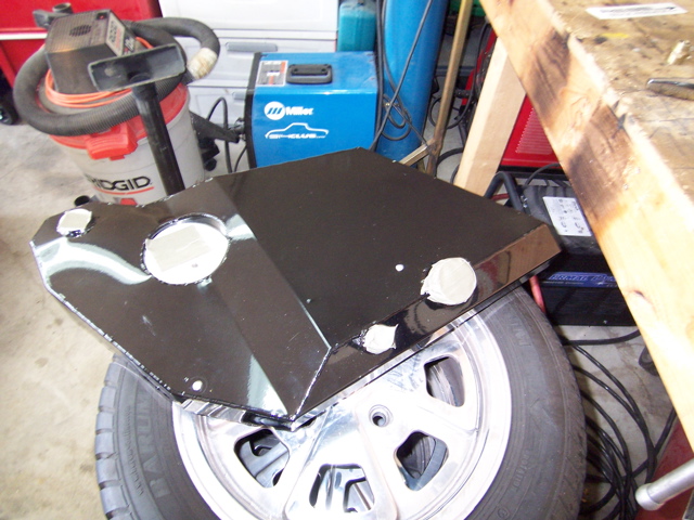

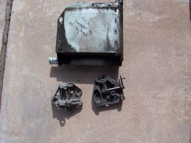

This is an expensive tank, but it's very nice:
Series9

Member No.: 2,602
Holes cut for the tank and undercoated:

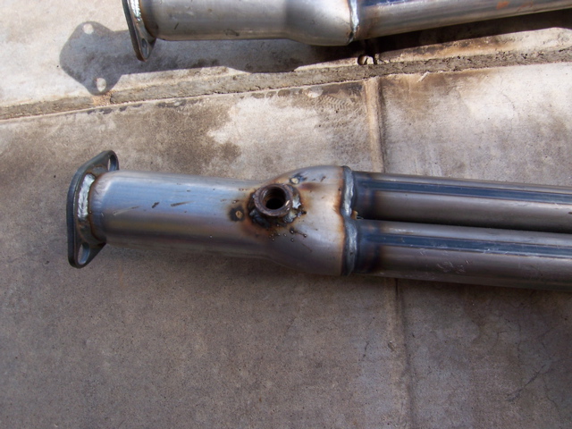

O2 sensor bung welded up. Yes, I said bung.

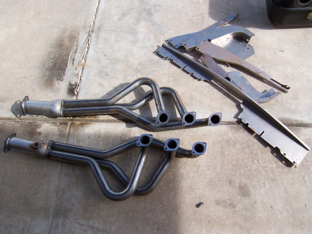

This stuff is going to ceramic coating today:

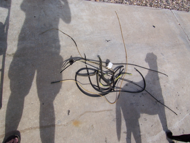

/4 fuel lines completely removed:

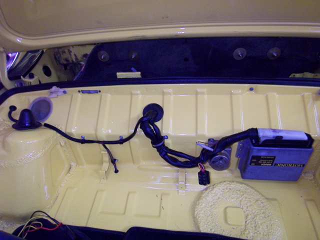

......mmmmmmmmm......digital 914....
The 914 and DME are now one.
Here's the DME, Altitude switch and spot for the DME relay:

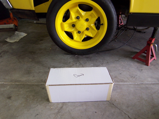

Here's a mock-up to check the size of the cooler/fan assembly I'm going to use:
16x6.5x6
