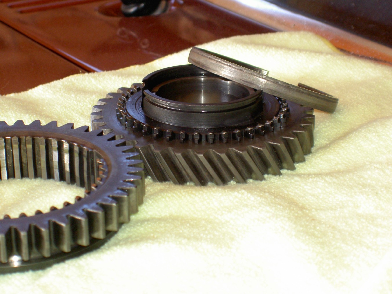

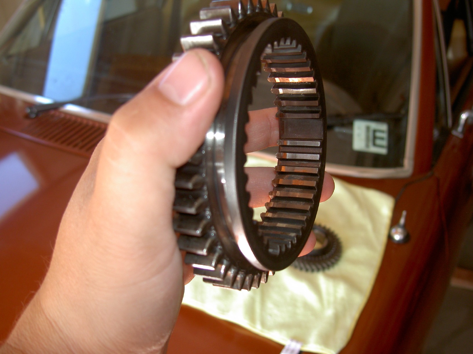

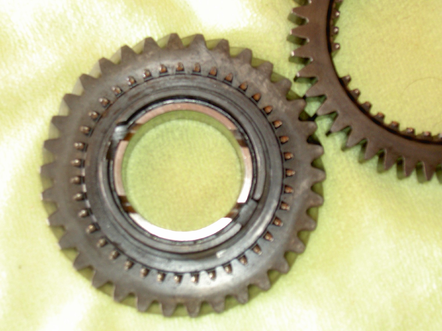

Dr Evil
post May 29 2006, 10:22 PM
Post #40
Send me your transmission!
Posts: 23,041
Joined: 21-November 03
From: Loveland, OH 45140
Member No.: 1,372
OK, the one side of the 1st gear slider is supposed to be flat....there is nothing for it to engauge to so no need for teeth. I wanted to see what i looked like together (synchro band bulge factor).
What condition were the brake band and blocks in?
So far you can use the typical; slider, teeth, synchro band....notice the groove in teh synchro band where the dog teeth wore in? Not exactly correct me thinks.
