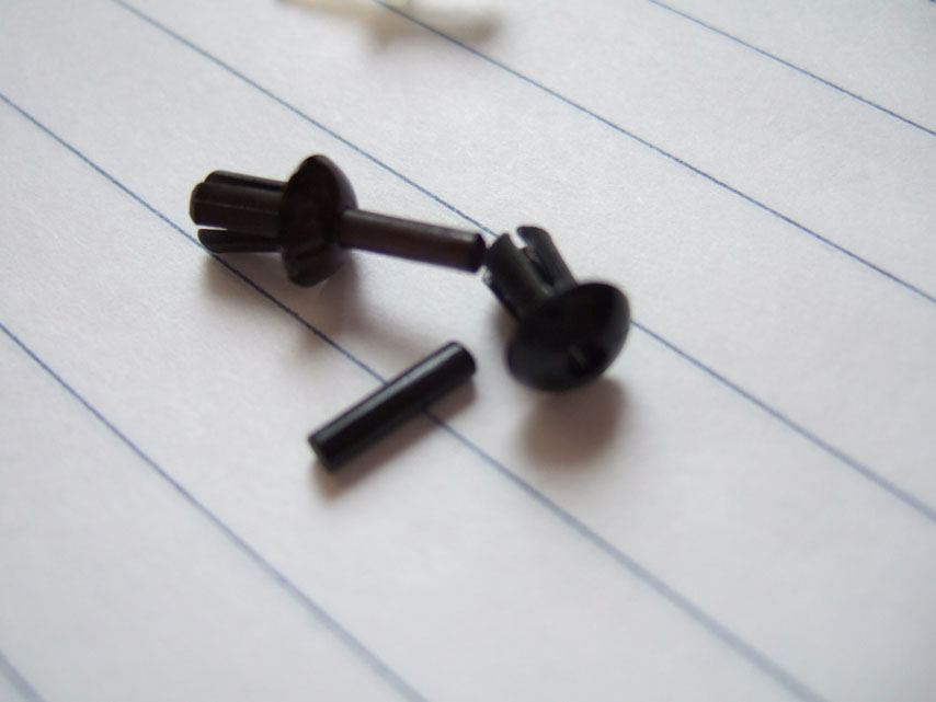

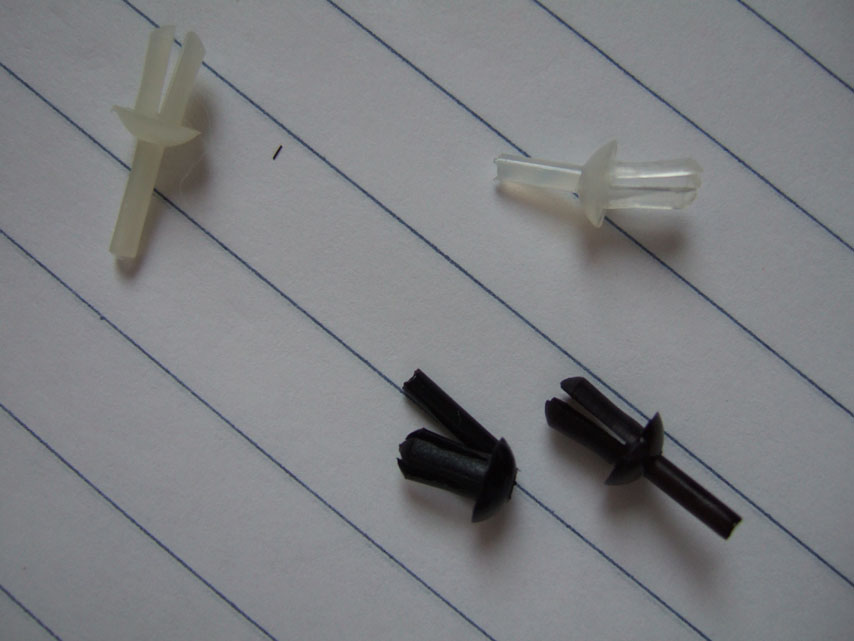

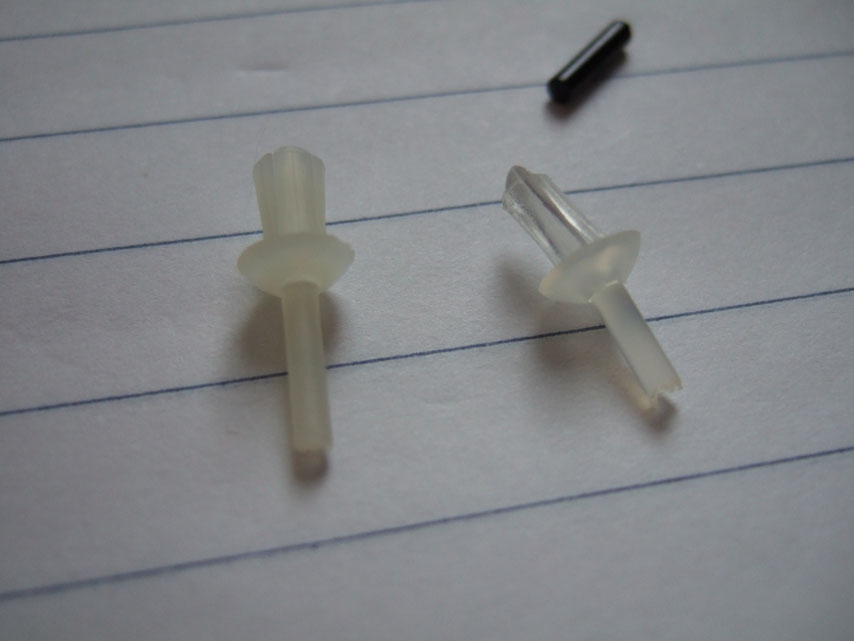

Here's pictures of oem with the samples, think this is as good as it gets. Priceing and quanity info still pending. 24 black and 12 white required.

I tried putting a few in.. the prongs are slightly thicker than the OEM ones. What I had to do was cut off one prong with a razor blade for it to work. Visually from the pov of the round head, they are indistinguishable. They go in easier with just 2 prongs remaining and seem to be very secure. Seems worth the xtra effort to get the right color. I have a new founded respect for the rivet man at the Karman plant.. man even the OEM ones are pia. Thats the scoup.

Hey Pat yah sorry been side tracked... they can not do white. They just have the bone colored ones and black ones. She just got back to me 2 days ago. 14,000 left in their inventory. I was going to buy a bunch in black and some in bone color until a better substitute is found for the white. The issue with these are, 1 or 2 of the prongs in the back need to be cut off for them to fit. Not a big deal really, but just something you should be aware of. The round heads are exact to the factory ones. Im going to check a couple other places cause I really want the white, but will be buying a bunch from her in both colors just incase (mostly black).
