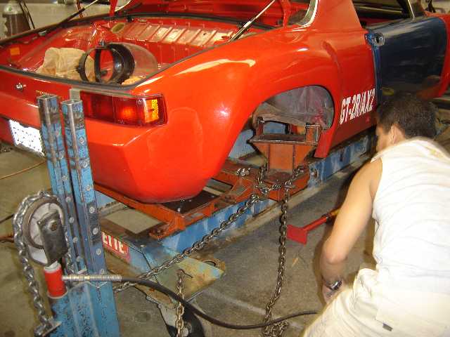

Making the final pulls. The rear trailing arm mounts where WAY out (shim stack)

Andy's red tub is/was tweaked in so many ways... it is crazy. The body guy's looked at the six tub and said: "easy".
Here is what I *think* happened with Andy's tub:
It was bent in a rear end collision
It was bent in a front end collision
Neither repair included "pulling" the tub
They replaced bumpers and installled the flairs with "insurance" money instead of paying to repair the tub properly.
B

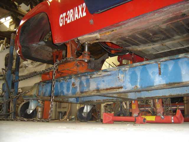

Done!!
It is straight!
Starting to unbolt the fixtures after all the pulling..and NONE of the bolts are in bind. This means the tub was pulled into submission!!!
Now to take it off the bench and bench the 6 tub.. help...lol

All the suspension now bolts up and it is not in BIND!!!
We assembled the rear without shims. I'm going to check camber with a SMART gauge and see if we have an equal number.

REALLY good news!!
Negative 2.5 on both!! rears with NO shims. This means the tub is zero.
Unless... both control arms bent the exact same amount. Chances of that are real slim.
It goes on the trailer in a few minutes. We will then put the six up on the bench and go home.

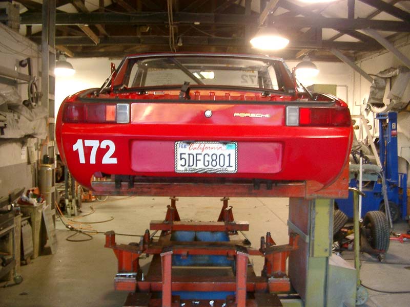

QUOTE(Brad Roberts @ May 28 2006, 06:07 PM) *
actually, his exact word were "piece of cake" ...
we'll see ... we didn't get to the /6 yet, that'll be my monday ...
just dropped my car of in napa at McMarks, going to bed now ( (IMG:style_emoticons/default/yellowsleep[1].gif) ) then up early tomorrow morning to pick up chungs car and haul it down to scotts, then on to unbending the six ...
what a weekend ...
(IMG:style_emoticons/default/blink.gif) Andy
here's a teaser, off the celette ... (never mind the crooked cut rear valence (IMG:style_emoticons/default/dry.gif) )
*ALL* the suspension stuff bolted right on, *all* the mounting points/bolts were dead on!

The /6 did not get any work done on it. It did get put up on the bench and pushed into the shop but Brad had to get on the road home. Andy took some pictures.
