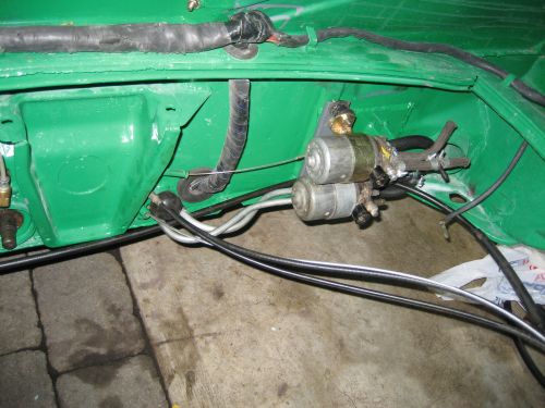

I also moved back to the engine compartment, where I began the installation of the twin fuel pumps.

If you're GTing it... why not move the pumps up front? I had serious vapor lock situations with my -6 with a stock 2.0 and the pumps in that location (sort of in that location).

why twin pumps to begin with?

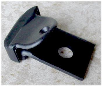

Hi Michel, if you're referring to this part but early style, I have some laying around.

I did'nt think that location would cause vaporloc problems. You may get hotter weather than we do. Then again, moving the pumps to the front may be a good idea. I had'nt really considered it, but maybe I should.
Aaron,
Theoretically, because the fuel pump is one of those single components that can immobilize the car. In reality, because I have a few and it's cool. i.e. very favourable cost to coolness ratio.

It is that part, except the early style, you are correct. Can I come to your house to pick one up ? Do you want to come see the project ?

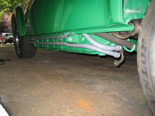

I did the final securing of the cooler and its shroud, as well as final (or nearly so) intallation of the hard lines under the rockers. Here's the hard oil lines. The finish is POR 15.
michel richard

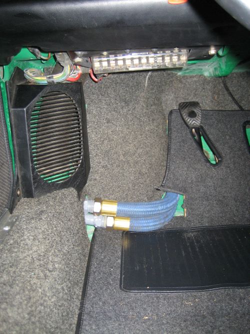

And here's how the connection will be made in the footwell. The hose is acutally armored, so I'm not really concerned about getting oil on my legs in an accident. I may still build a shroud over the hose.
