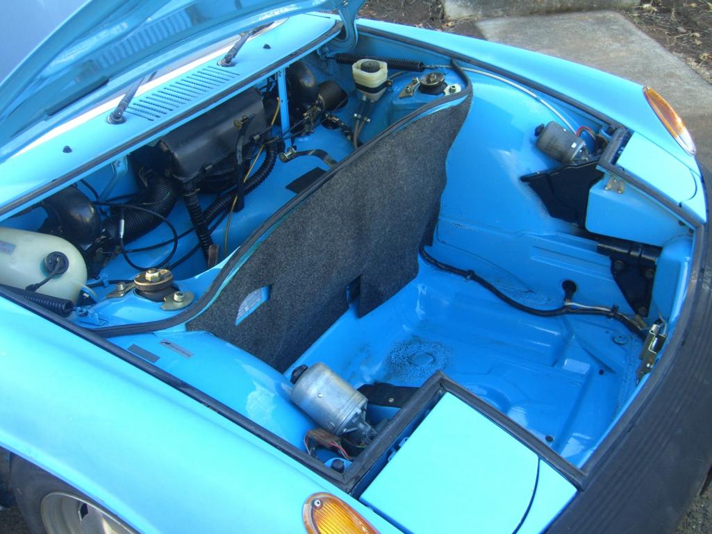

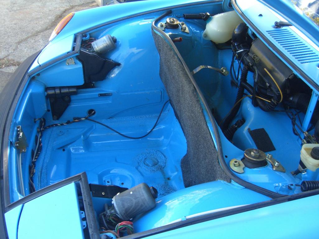

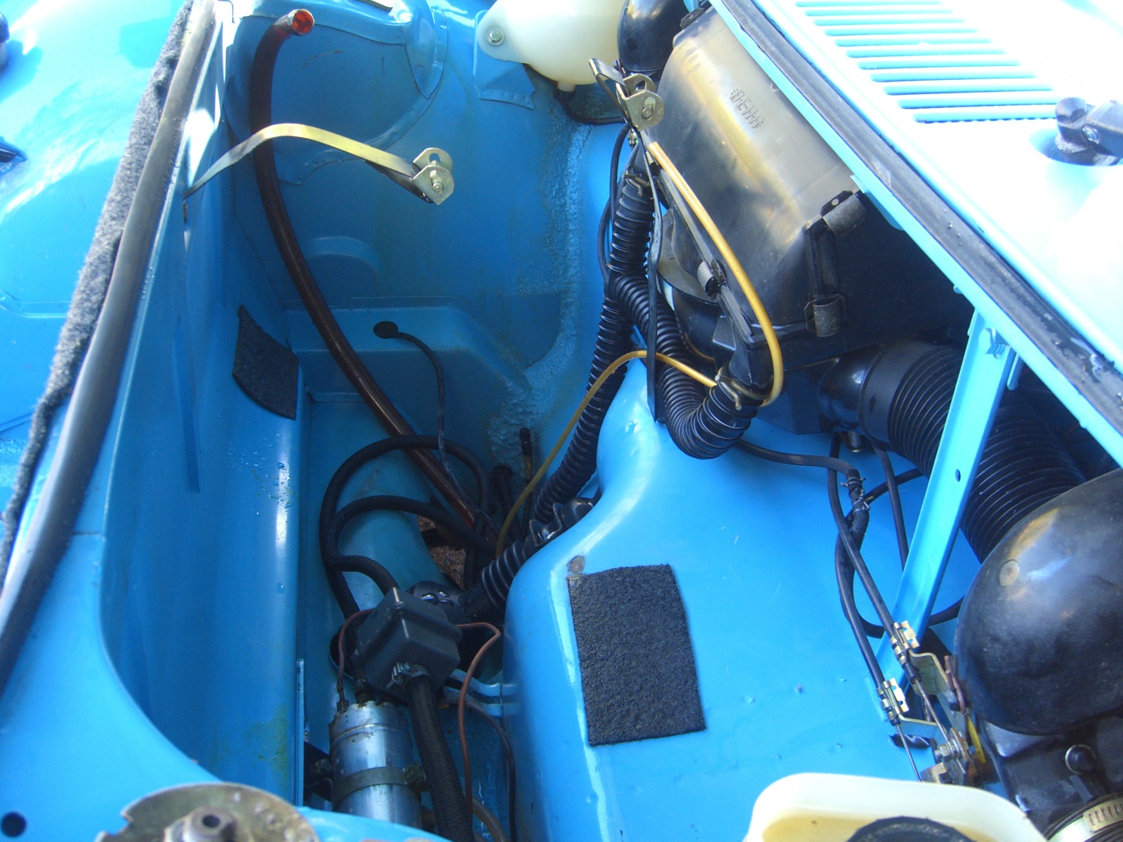

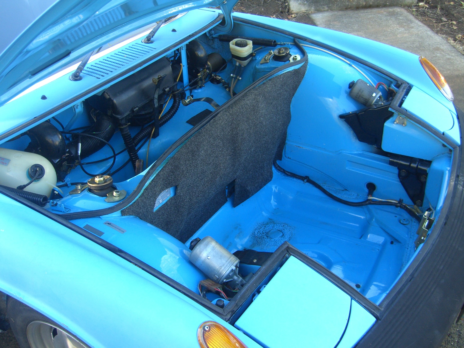

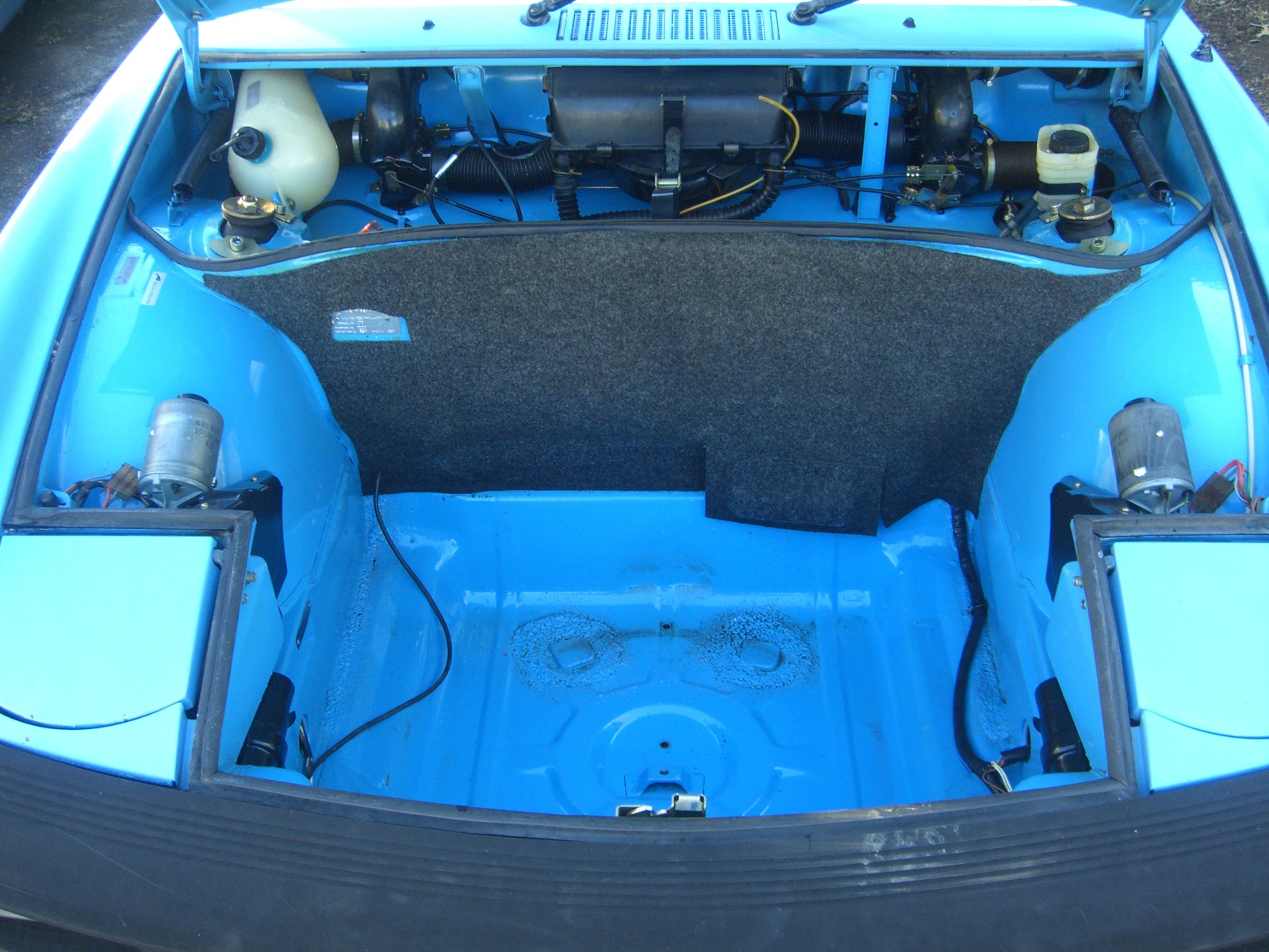

barndoor
post Nov 2 2012, 05:44 PM
Post #95
Posts: 21
Joined: 16-October 12
From: Oregon
Member No.: 15,049
1975 2.0Attached Image Attached ImageAttached ImageAttached Image
Pat Garvey
post Nov 2 2012, 06:26 PM
Post #96
Do I or don't I...........?
Posts: 5,900
Joined: 24-March 06
From: SE PA, near Philly
Member No.: 5,765
QUOTE(barndoor @ Nov 2 2012, 05:44 PM) *
1975 2.0
Super nice looking front trunk, but something is missing. Let's see, would that be a fuel tank?
BTW, I noticed a bit of staining from the spare. Most, if not all, of that can removed isopropyl alcohol, but use the 70% stuff. The 91 percent stupp will remove some paint too. Wax after doing it.
