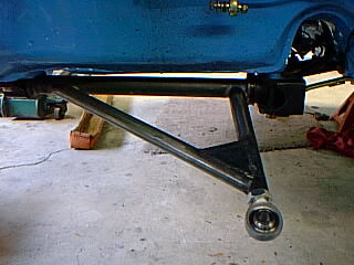

Due to my large offset wheels (40mm), the wheel/tire combo sits too far inboard.
I can run spacers, but they would have to be at least 1 inch which is acceptable, the GT look cars run this amount, the problem is that I have odd-ball size studs that I cannot not find longer studs than I already have
(12mm-1.5 X 50mm??) I refuse to run bolt on spacers, so the studs would have to be longer.
So it seems easier (hahahaha) to just widen a set of A-arms to accomplish this. I know it has been done in the past (Yellow 3.6 powered 914 GT in Excellence a few years back, East Coast I think)
The only issue I can think of right now that could cause problems is whether or not the turbo tie rods have enough adjustibility to safely widen the track since the struts would be moved outboard ~1" per side.

Widen the A arms so you can have a TON of negative camber. If you widen the bottom you have to move the top also.
Ebay the wheels and hubs.. put stock shit back on it and design some more parts for our cars.
Why didnt you measure this offset BEFORE you bought the Rice ??

If you run longer a-arms, you have to change the spindle angle, or move the upper mounting points out an equal amount.
Why is everyone down on bolt on spacers? arent the hubs magnesium? the hub will be the weak link, not the aluminum spacer (at least on the front?)

Mike if you do away with the stock cross member and come up witha billet peice you can lengthen the lower a-arms but you will have to get coilovers. This is not a solution to your problem though. You would also need to analyze the camber curves as you change the rate of camber gain or loss as well as a few other things.

could you lengthen the a-arms, but keep the ball joint the same distance from the center, and modify strut (longer spindle w/ spacer)thus keeping same camber? prolly not, just thinking out loud (IMG:style_emoticons/default/idea.gif)
