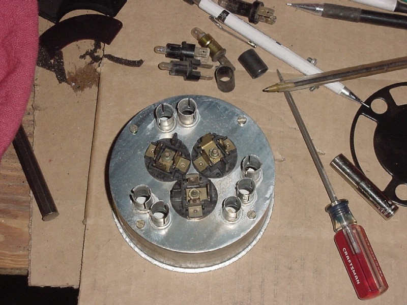

The kits include faceplate as shown in pic below and zinc plated back plates.
These are available for shipping immediately.
Printed instructions are included with the kit, and are augmented here in the classic threads.
PM or Email for details.
Prices are (12-23-07):
Kit shipped to you in the USA $100.00
Assembly and return shipping $50.00 (you ship me your gauges for assembly)

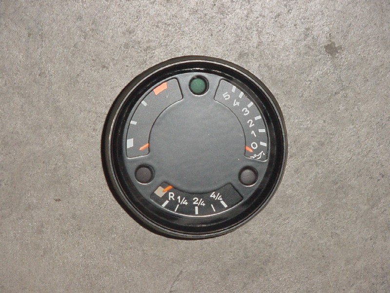

Another gauge completed with the blank faceplate.

obviously the one gauge is Fuel level. The oil one is pressure or temp? and in what measurement scale?
whats the other gauge?

RS22b
The gauge with the oil can shown is from a 911 combo gauge and is oil pressure in BARS (1 bar is approximately 14.7 PSI, bar is short for barometric pressure)
The gauge on the left is the other gauge from a 911 combo gauge and is temperature. The graduations are labeled at the outer edve of the gauge itself. The first line is approximately 190 deg F.
You can get 911 combo gauges with numerical gauge faces and ones that are labeled in PSI, but the ones I have made are not numbered that way. Since I know where my car is supposed to run, I don't really need the numbers and I think they tend to just add clutter. Due to teh fact that the 911 gauges are turned slightly, the numbers would end up skewed slightly anyway.
The kits do require (2) donor gauges to make up the tripple:
(1) later 914 fuel combo gauge (1973 1/2+)
(1) 911 oil pressure/temperature gauge and sending units. (any year will do)

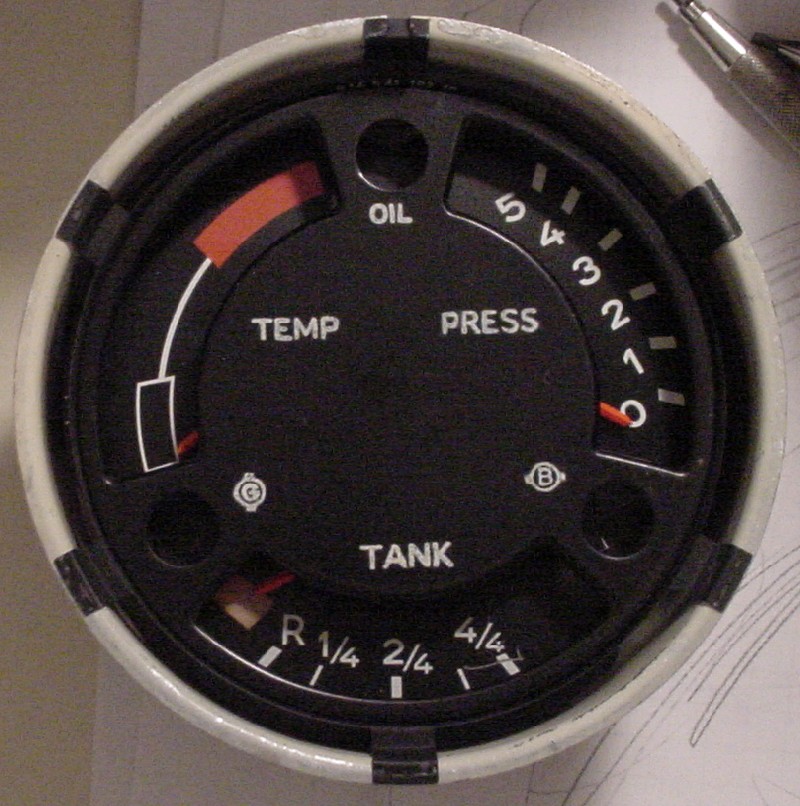

I received the lettering for the gauge faces and was able to create the first lettered faceplate.
The attached pic is the very first attempt. I will have lettered kits available later this week.
(I screwed up the Brake warning symbol, but I have worked through that application issue.)
These are MUCH MUCH better quality than any previous attempts and far surpass the old 904 style gauge kits lettering offered for sale.
The first lettered kit will ship out on Tuesday as they already committed to being first.

As a comparison, here is one of the old original gauge kits I purchased and was disappointed with.
