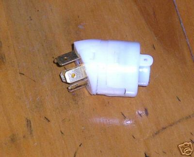

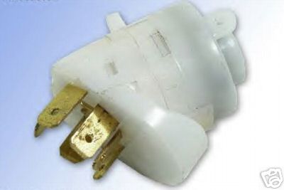

Here are a couple of pictures: 75-76 which has the extra tabs and the 72-74. I wouldn't think there is a problem reusing yours if it is not damaged, though it may be prudent to change a 30+ year old plastic electrical part that takes current through it, especially one that takes so much disassembly to get to. I have seen these with a longitudinal crack in the plastic casing which I assume is due to 30 plus years of heat cycling. John
