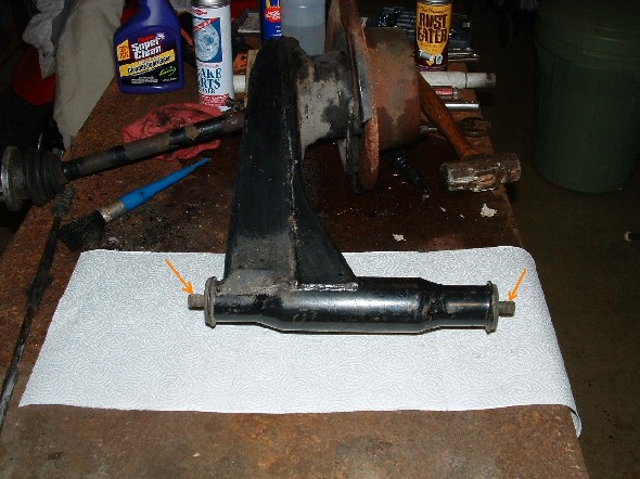

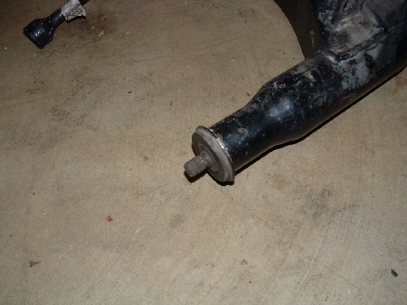

I am considering replacing the rear bushings while I have the trailing arms out. It is not intuitive to me how to remove the existing bushings. It doesn't look like they can be disassembled. (IMG:style_emoticons/default/confused24.gif)
Studs on both ends. nothing to put a wrench on. What am I missing?
The factory manuals indicate that the rear bushings are not replaceable. I know better - I know that some of you have done this. I've searched for references on how to disassemble/ reassemble the rear trailing arm bushings but could not find enough info to figure it out. (IMG:style_emoticons/default/headbang.gif)
Need some help! How are the rear bushings removed/reinstalled?

I just don't see how to get this off/out - Puzzled

Go to a shop and have the threaded shafts pressed out
cheers,
Jeroen

I started with the old torch approach and after five minutes of breathing the carinogenic fumes, I stopped, and brought it to my shop and they pressed them out in a few minutes.

Press them out. It takes HALF the time compared to the burn method. Real men use the proper tools.
And.. Weltmeister STREET bushings are a decent replacement IF you dont want roller. They dont stick as bad and creak less than the hard RACE bushings.
