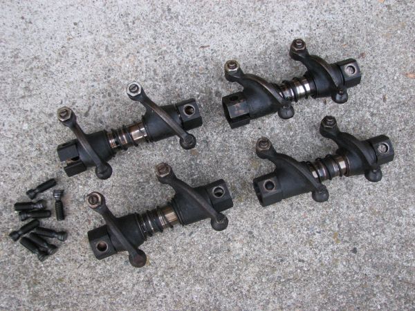

So those in the know...how is this conversion done? I don't now the specifics so please tell me. I understand that the stock 74-76 2.0L cars use a larger-diameter adjuster and cannot accept the swivel foot adjusters because they are smaller. The needed parts as I understand it are:
* Rocker arms/shaft assemblies from a 1.7L engine
* Swivel feet valve adjusters (10mm?)
* Shims
Is all the above correct?
What shims do I need and where are they installed?
Is there further machining to do to the rocker arms?
All details please...Thanks in advance (IMG:style_emoticons/default/biggrin.gif)

Twystd1   Yup... You have the right parts. Now you need to ...   Jan 10 2007, 06:32 PM

gregrobbins   Here's a photo I copied from somewhere.   Jan 10 2007, 08:47 PM
Twystd1   Thats the exact photo I was searching for..... Th...   Jan 10 2007, 08:52 PM
Aaron Cox   Thats the exact photo I was searching for..... T...   Jan 10 2007, 11:53 PM
CHAFF   Hi Aaron, Let me get this straight....if you grind...   Feb 26 2007, 08:35 PM

Twystd1   Heee..Heeee Aaron said his engine sees 6000 rpms....   Jan 11 2007, 12:19 AM
Twystd1   The Jakester and aircooled.net sells em also.. C   Jan 11 2007, 12:40 AM
Aaron Cox   i got mine off ebay and clearanced em to .004...   Jan 11 2007, 01:28 AM

CHAFF   Could you not just grind the face of the swivel fo...   Feb 26 2007, 09:19 PM
Dave_Darling   Could you not just grind the face of the swivel f...   Feb 26 2007, 09:33 PM
CHAFF   Man, there sure seems to be alot of misleading inf...   Feb 26 2007, 09:40 PM
jd74914   Man, there sure seems to be alot of misleading in...   Feb 26 2007, 09:46 PM
CHAFF   Ok here is my deal. I understand that this will r...   Feb 26 2007, 10:19 PM
Aaron Cox   Ok here is my deal. I understand that this will ...   Feb 26 2007, 10:20 PM
Dave_Darling   But here is the question no one wants to answer.....   Feb 27 2007, 01:40 AM
Aaron Cox   You need to clearance 60 tho off the rocker face. ...   Feb 26 2007, 10:10 PM
CHAFF   Thanks Aaron, that answers it. You need to clear...   Feb 26 2007, 10:22 PM

914werke   I thought Id update the descriptive image. :)   Dec 22 2019, 07:53 PM
maf914   Rich, Nice clarification to the earlier posted pho...   Dec 23 2019, 06:42 AM

Mark Henry   Yes you have to machine and countersink the rocker...   Jan 3 2020, 08:51 AM
