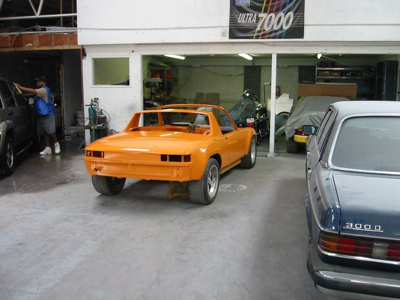

Yup - that's exactly what I'm running. Fuchs 16x9, steel GT flares, .5" spacer.
The spacer just clears my rear brakes (C2T), and the flares were welded up to make this fit right. You really need to get everything fit (brakes/wheels/tires) then weld up the flare where you want them. My fender had to be pulled about 3/4" out for this combo to work, then the flare was welded on.
-Steve

No good pictures right now other than this. (before engine installed)

Steve,
That building looks like "Beach Boys Racing" Bob Farmer's place in Venice next to Otto's.
Cool Ed.. it turned out slick.

Nope, it's a shop here in downtown San Diego. I know what your talking about though. That photo was actually taken inside, it's just a very large warehouse.
