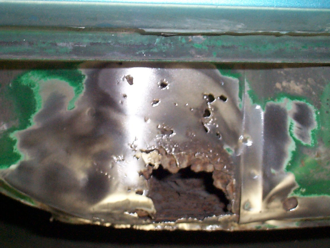

What began as a suspension console replacement has no moved on to other areas. This was a small quarter sized hole, till I cleaned it up...

Removed the outer layer with my dremel. Rusted under the jackpost as well, although the post was always sturdy. The inner layer will have to be cut out. Still havent got the top part of the jackpost off yet...

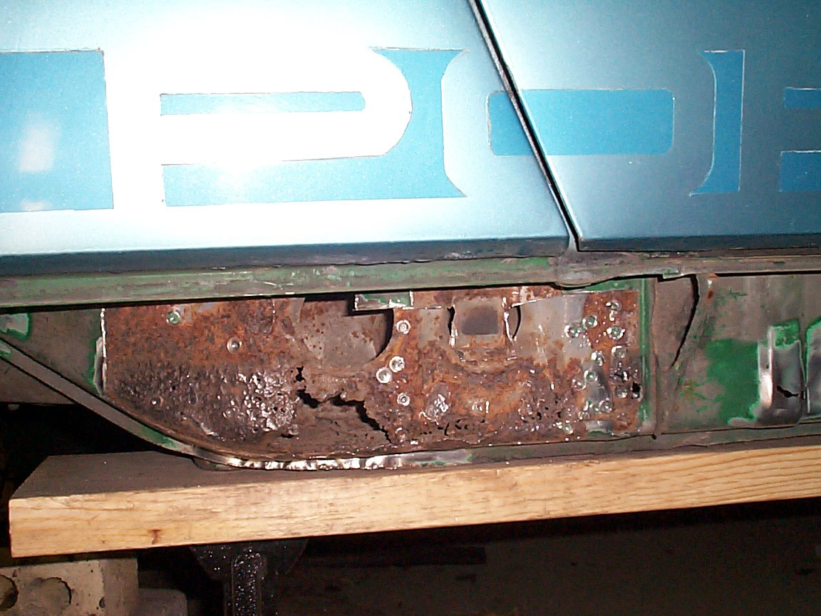

The following two photos show the first piece of new metal going back into the car. I am preparing to weld in the suspension console, so I needed to at least fix the top of the longitudinal where the console will attach. I decided to break up the rust repair in small tasks, so I am focusing on the console, rather than the rest of the longitudinal at this instance. I was exited to at least get a piece of metal in without blowing holes through everything. That little piece of metal has a backing behind it so that I would have an eiser time welding the seem. I also spot welded three holes to the inner longitudinal, at least one of which I am very confident of its strenght.

My welds look like crap, but they are strong (I hope). I practiced alot to do good welds, but getting in the tight engine compartment, with a bulky welding helmet on, and having to weld with your left hand when you are right handed is kind of tricky. I had to grind a few of them to do over, and some of the edges started blowing through, which had to be done over, carefully.
