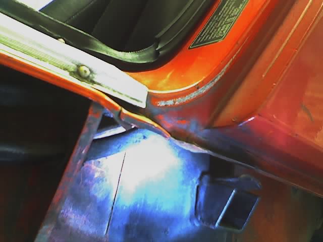

Those holes don't go into the long. (IMG:style_emoticons/default/wink.gif) My camera battery is dead, so you get crappy cell phone pics.

If you're talking of the black cap that goes into that square opening... That's a 'beauty plug' to cover your jack point.

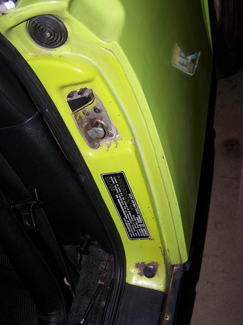

Just so there's no confusion, I'm talking about the black round plugs in front and behind the plastic door sill protector. Could they be for anything but rustproofing? Prior history of the car unknown. Initial pictures don't show plugs anywhere else.

My car has the Ziebart plugs. The plugs are yellow, about 5/8" in diameter, and have a "Z" in the middle with "Ziebart" around the outside of the "Z". The plugs are in the lower rear of the doors, the door frame (front and rear) and also in the rear inner fender wells.
