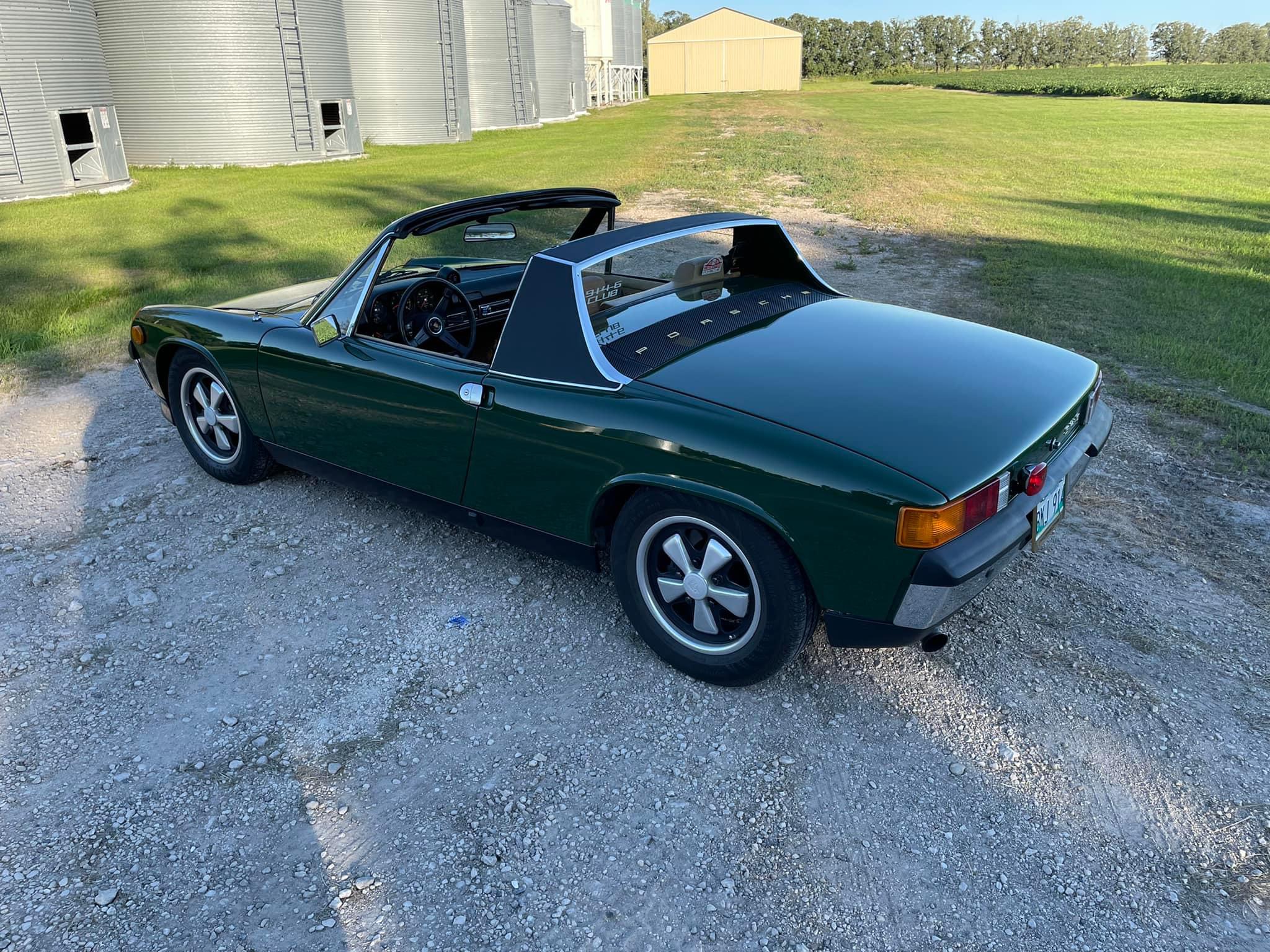

I added the rear fog light quite a few years ago. I bought a factory harness (probably from AA), but used only the white/green wire. I shortened the wire and added an end so it plugs into the relay board. My fourteen does not have the rear window defogger, so I “hi-jacked” that wiring circuit already in the car, and added a separate rear fog light switch to the right of the steering column. There are unused slots in the dash for extra switches. I found a rear fog light switch symbol out of Europe, and used a standard switch commonly used in the 914 for the front fog lights and rear window defogger. I added a two-fuse fuse box (from the 911) which I installed inside the rear trunk near the rear fog light bracket. (I used only one of the slots in the fuse box.) I installed an older European style rear fog light (flatter red lens). The rear fog light can by operated independently of the headlights or front fog lights. My understanding of the original wiring is that the long factory wire loom (two wires) would have been connected to the switch for the front fog lights and the rear fog light would automatically work with the front fog lights.Attached Image

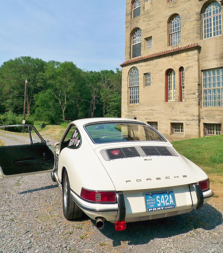

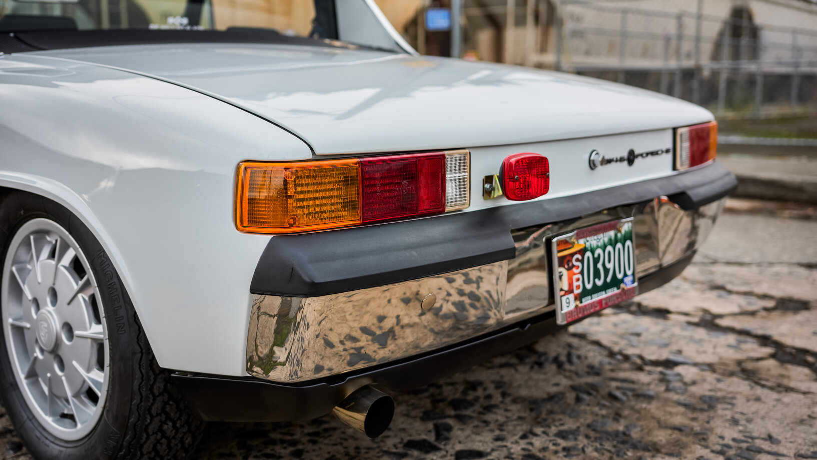

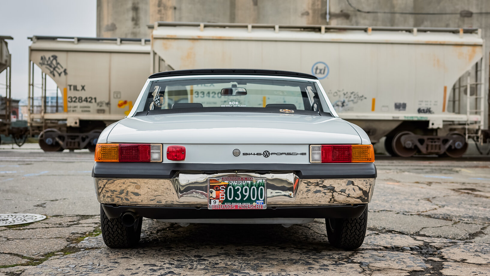

This is one of my favorite posts....
It took awhile but I found a factory wiring harness for this rear fog light.
You can replicate it so easily as it's only 2 wires.
The bracket too took some time as well.
It's either mild steel or some aluminum stock with a little bending.
But when it's yellow zinc/cad plated, it looks so factory.
Plus the "cool" factor when you're leaving a coffee and cars, or your buddy's house.

I have everything I need to do the install, except the side to side location. Are you going by the 5” from the brake light rule, or is there a magic number for this…Like 42mm from the sheet metal tail light opening? I’m at a point where I can drill the holes and paint them. Thanks

Love, Love this White 914-6 (IMG:style_emoticons/default/pray.gif) Beautiful.

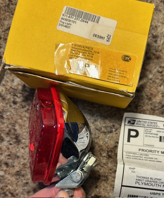

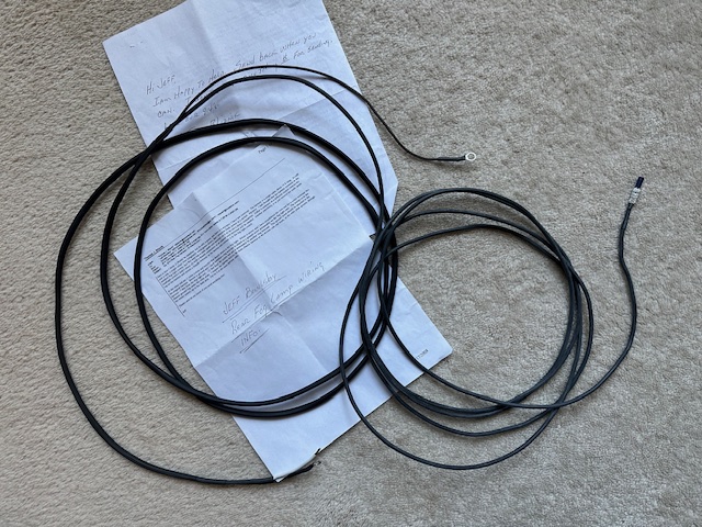

I started this fog light about 20-years ago & pulled a few items out of my archive.
Jeff Bowlsby:
I still have my wire harness your built me and it's still waiting for me to install (IMG:style_emoticons/default/av-943.gif) I know (IMG:style_emoticons/default/headbang.gif)
I attached a few photo's to clear up some member questions & still have more if needed. Rob,@ (Cone Dodger) probably has more in his archive (brackets & ??) Rob was in charge of Bling (IMG:style_emoticons/default/rolleyes.gif)
