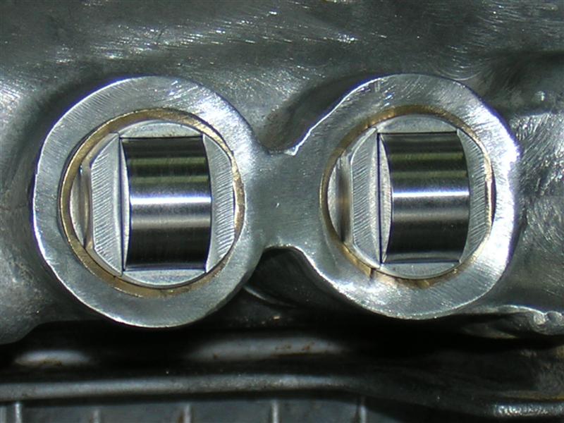

Here are some detailed pics, I have shared more similar pics over at my forums in the R&D section.

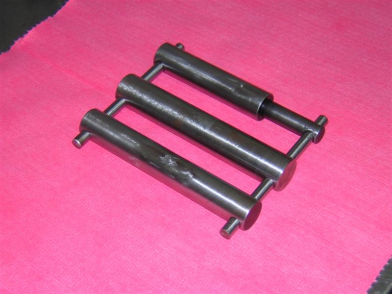

Here are some of the bushing alignment tools used to check bushing install to ensure the roller lifters are going to be truly perpendicular to the camshaft

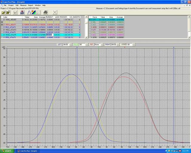

This is a digital plot from our cam profiler that clearly shows the differences between a roller and flat tappet cam that have the same .050 duration values and similar lobe lift, note how much wider and flatter the 9900 series camshaft is, this and all 9900 series cams are rollers.
