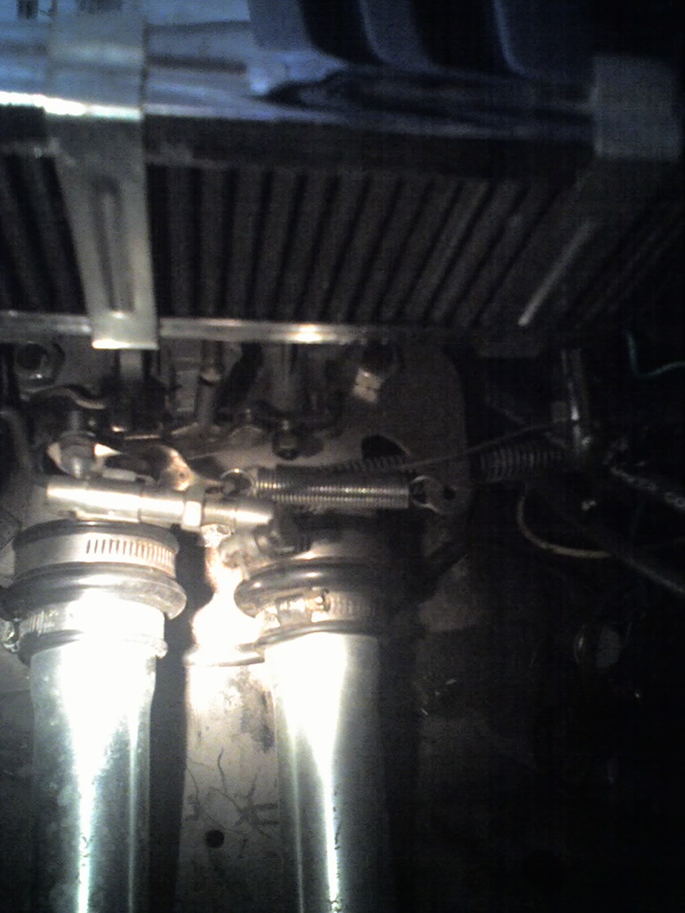

I'll attach a picture to show what I'm working with.

I actually can stomp the hell out of the throttle without worry...since I have a carb on there, a really HOT one... a weber progressive (IMG:style_emoticons/default/tongue.gif)
I've sprayed WD-40 down the line and it frees the line up for about 5 minues and then it starts to get sticky again. I'm just going to chuck the damn thing since it's a hack job the way it's setup at the carb anyway. I'll attach a pic in a second.

Pic as promised, sorry for the crappy lighting, i'll get a better pic up someday...
