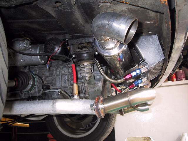

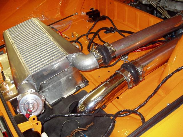

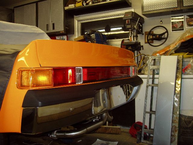

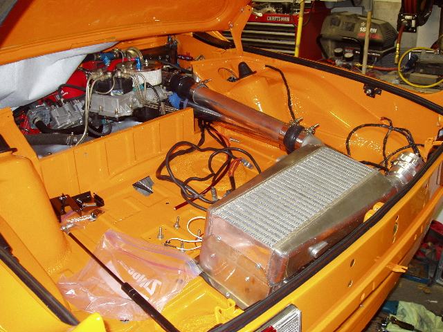

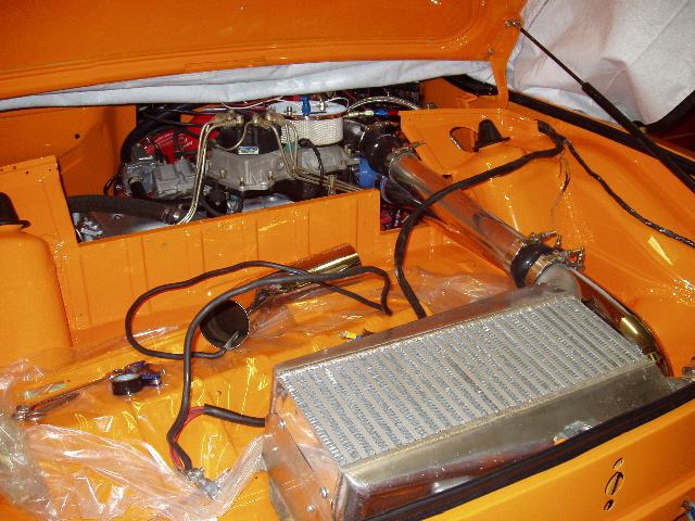

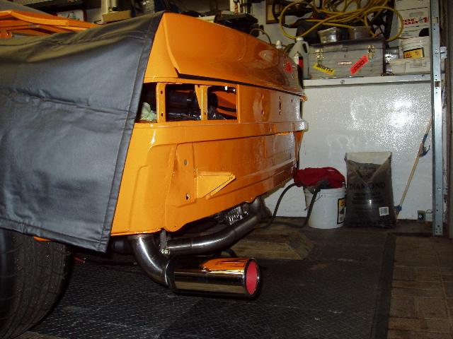

I lower the car back down a little bit...

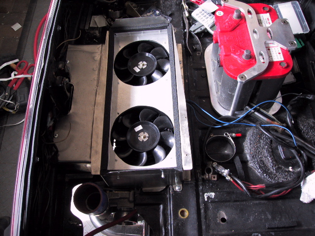

Here are some shots of the rear... and whats inside the trunk..

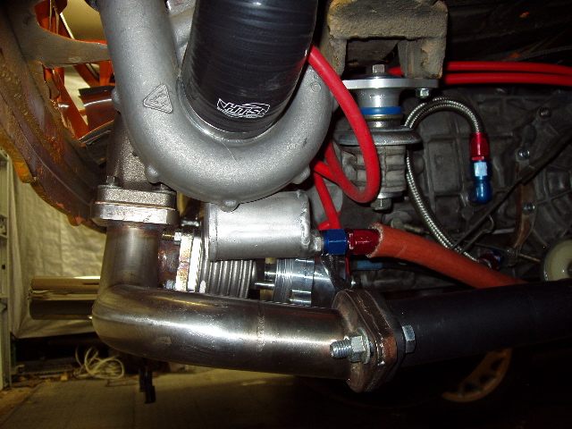

Now that the tail pipe is in the car I will cut and reweld it to fit properly and I will make the dump pipe for the wastegate while i'm at it.
I just spent over an hour looking for the hose coupler that goes between the oil tank and the line from the oil cooler, hell if i can find it, I last saw it when I painted the oil tank a few months ago, this is going to bug me all weekend while i'm hunting Pheasants. (IMG:style_emoticons/default/ar15.gif)
See you on Monday kids.....

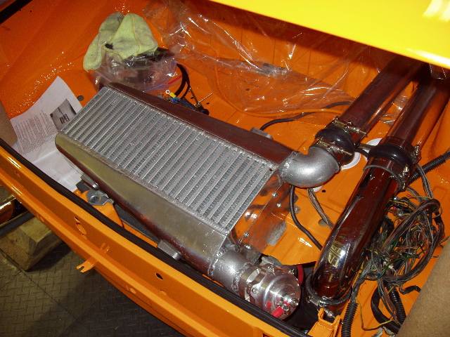

Member No.: 5,463
very cool project and great looking car... been following along for awhile now.
Question - are you going to use fans or something on the intercooler? Or how are you going to get air thru it and out the bottom?
iamchappy
post Oct 16 2007, 10:11 PM
Post #107
It all happens so fast!
Posts: 4,893
Joined: 5-November 03
From: minnetonka, mn
Member No.: 1,315
Answer to your ?...
I have 2 - 7" fans pulling the air through the intercooler and exits out the bottom of trunk through the transmission cooler. I cool two things at once.

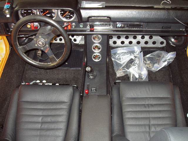

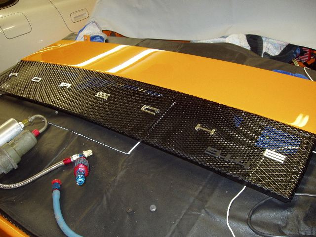

Had time today to finish the engine lid and mount the new letters. (IMG:style_emoticons/default/biggrin.gif)
Another wiring mess to clean up.,, (IMG:style_emoticons/default/mad.gif)

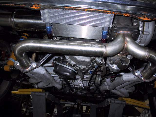

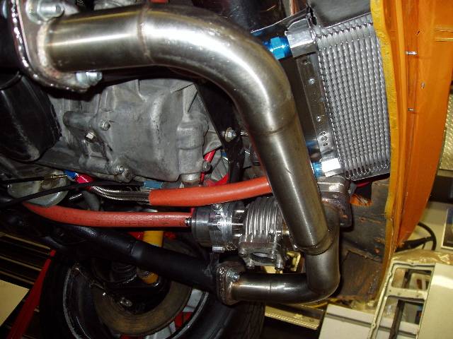

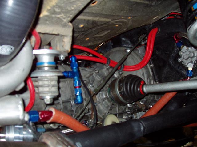

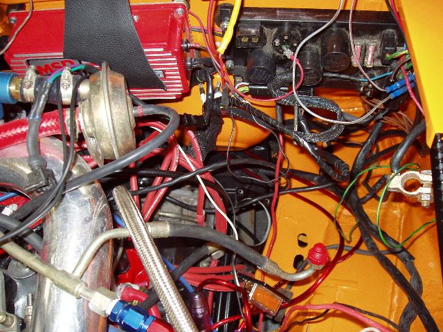

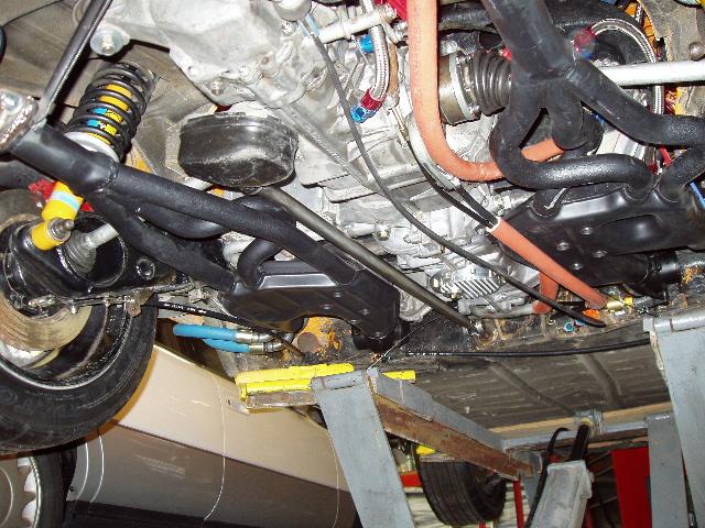

Got a few things done today, closing in on getting this thing fired up.
Transmission shifter and CV's all attached, It's going to be a bitch getting those CV bolts safety wired around those HE's.
Starters in and getting the heat control valves hooked up.
I will try to get the fuel lines sorted and attached tomorrow and figure out if I am going to move the battery out of the trunk back to the engine bay.
I am starting to get a little excited. (IMG:style_emoticons/default/piratenanner.gif)

what is that red line/wire that looks real close to the turbo in post #109?
k
iamchappy
post Oct 18 2007, 11:52 AM
Post #112
Posts: 4,893
Member No.: 1,315
Thats a vacuum line that runs up to the BOV, I dont have most of the lines tied up or secure yet, that one may move.

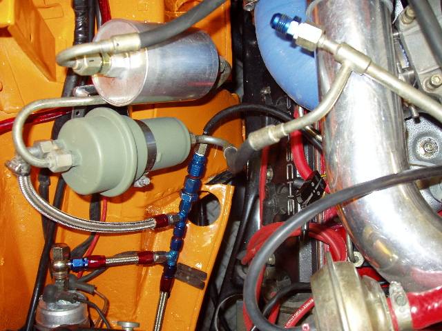

I had to fabricate new brackets for the Fuel filter and Accumulator, and mounted the pump. I have the wiring cleaned up and simplified.
I was surprised at what a mess it was, when I fabricated this setup originally I didn't spend much time on the finer things so I have had to spend a bit of time mending and reorganizing the wiring and hoses.

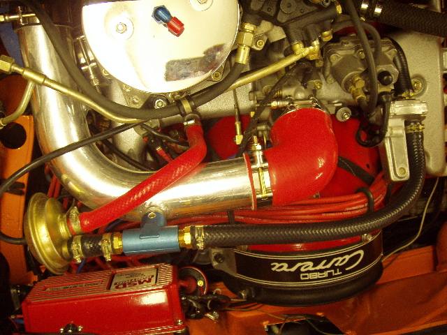

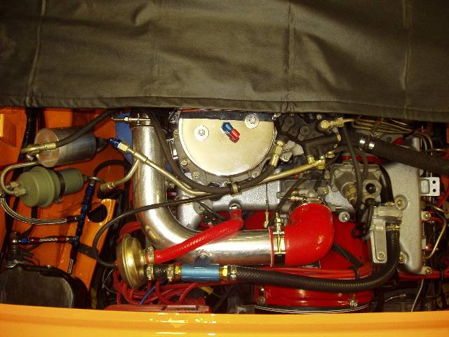

I am calling it a night.. made some progress, getting close to finishing up all the engine essentials that will make it come alive!
Next is getting the vinyl on the sides, trim pieces, oil tank and lines, door windows and panels, seat belts, and windshield and trim. Then I think I am all done....

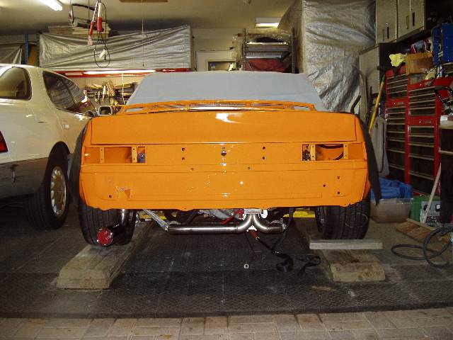

I scratched few more things off the to do list today.
I cut and fit the rear ghost reflector, I painted the rear panel black so it filled in the outside edges, it ties into the tail lights better this way. I installed the Engman cable release, cleaned up, buffed, and mounted the bumper.
Tomorrow I plan on hooking up the battery to check on the wiring, finishing up and tightening the fuel lines. And hopefully get the vinyl on.
Once the oil tanks in, I could start this bitch........ (IMG:style_emoticons/default/piratenanner.gif)
I would of taken a better picture of the rear but there was a pile of leaves outside the garage door that would of blown in.
