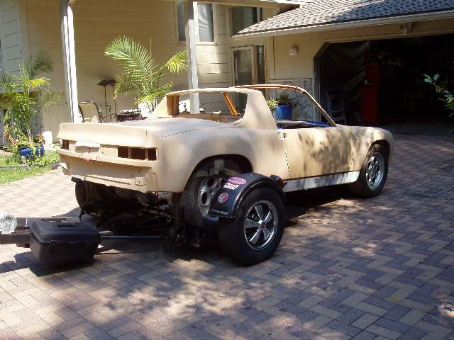

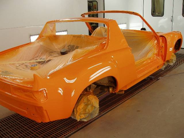

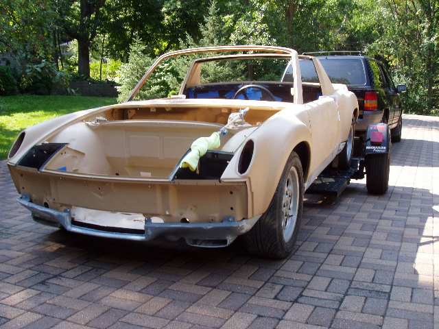

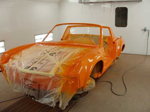

Ok, it's starting, almost all the pieces are in place.
I worked Spring and Summer getting the car all in primer and finishing up the custom valances.
I actually thought this time last year I was suppose to be done.
Here are some photos of the car last week getting towed to the bodyshop, and pictures of how it looked this morning.
Next week I will start to assemble my two and a half years of acumulated stuff back
onto the car and fit the engine.
I will document it with pictures as I go along.

Wow that looks great! Having a car that looks that nice will help when sifting through the parts.

Nice color!

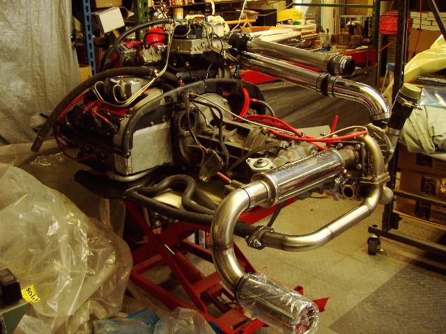

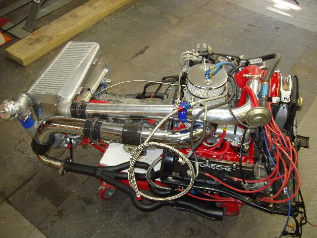

I will be impossible for me at this point to put a dirty or old used part that hasn't been reconditioned back on it.
Here is what is getting put back in.
IAMCHAPPYS PORSCHE 914 6 GT TURBO CARERRA BUILD SHEET
3.12 CIS Turbo Twin-plug engine
Using 1979 SC 3.0 block, crank. rods and heads and cams
91 3.3 turbo pistons and cylinders
Rod pin modification for stroke
ARP rod bolts with 928 nuts
Supertec Head studs
Elgin racing valve springs and retainers
930 turbo oil pump
K27 7200
Spearco 1080 cfm intercooler
Electric automatic temp fan relay switch
Two 7" electric pull fans for intercooler
Transmission cooler
Tilton electric transmission cooler pump
Mark Donahue special edition steering wheel(very rare).
Tekniq quick release steering wheel hub
Terry cables
Custom aluminum intake and pressure side turbo piping
Silicone elbows, hump hoses and reducers
86 930 turbo intake manifold
Euro fuel distributor
Bosch 400 lph racing fuel pump
Tial 46mm wastgate
Tial 50mm BOV
Turbo x boost controller
Adjustable micro pressure switch for 7th injector
7th fuel injector micro fueler (911sc CSV)
Supertech generation 2 - 12 plug conversion distributor
MSD boost retard ignition with rev control
MSD shift light
2 MSD Blaster 2 coils
Magnacore twin plug 12 wires
RSR plug holders
Maganaflow 2.5"in 2.5"out muffler
Custom stainless crossover pipe
Hooker resonator exhaust tip
930 cam driven oil pump
Aeropquip stainless and blue line socketless fuel and oil lines
Fire sleeve
Front mounted oilcooler
Factory 914-6 oil tank
Factory 914-6 engine mount
Factory 914-6 rear stub axles
Front mounted oil cooler with thermostat
Smart Racing oil cooler block off remote oil filter stand
Smart racing on engine Thermostat no bypass
Canton remote oil filter
Canton inline transmission filter
911 front end with aluminum crossmember
951 Turbo brakes calipers front and rear
911 Ebrake modification
New Ebrake cables
Brake bias valve
Carrera solid rotors
Speed bleeders
Porterfield RS-4 brake Pads
23MM master cylinder
Adjustable front swaybar
Rear sway bar (unmounted) for street
2 Set's of 7, 23mm offset 8X16 phone dial wheels
Set of 7, 9 x16 Fuchs
Yokohama es100 225/50/16 , 245/45/16
Contiextremecontacts 225/50/16, 245/50/16
Toyo RA1 225/50/16 , 245/45/16
Adjustable Koni shocks in front
911 gauges
901 side shift trans with Quaife and short gears (M,S,Z)
901 side shift trans stock gearing
914 6 Cv and axles with Dr. Evil safety wired CV bolts
Kennedy stage 2 clutch and pressure plate with starter ring
Shorten shifter
914-6 aluminum plated headers
914-6 factory heat exchangers and heat ducts and diverters
Rear end has been reinforced
Suspension ears reinforced
Engman Interior long reinforcement
Brad Mayeur outer long reinforcement kit
Bilstien shocks adjustable perches in rear
200lbs springs
Turbo tie rods
Steering rack has been lowered for bump steer
camber truss front and rear
Wevo transmission mounts
Autopower Full roll cage( unmounted for street )
2005 Alpine cd mp3 player with 8" Quart subs driven by Alpine T220, Alpine type R 5 1/4 door and 6.5 kick panel speakers driven by Alpine T240 amp.
LED blue gauge bulbs
Gauge trim rings
Halogen headlights.
Euro side maker lamps
Gtech computer
a/r before turbo analog gauge Westberg
vdo boost vacuum gauge
Autometer sport comp boost gauge
Autometer Pro Comp fuel pressure gauge with isolator
Autormeter Pro Comp transmission temp gauge
Autometer Pro Comp volt meter
LM1 analog wide band A/R gauge
gauge pods
Optima yellow deep cell battery
Billet battery holder
Oil breather catch can
993 spare tire cover and tool kit
GT fiberglass flares, rockers, MSDS rear GT valance, and rear spoiler with intercooler duct.
Black Leather upholstered interior
Harness bar
Morsphectra carpet set custom for use with aluminum floor boards
Aluminum floor board driver and passenger
Aluminum pedals
All new chrome trim items
New OEM exterior door handles
New OEM mirrors driver and passenger
New engine lid letters
New ghost reflector rear lens
New windshield
Tow hooks
Modified Gt valance with brake ducts
914 Club badge
Shine racing needle bearings
Chrome fuel door in hood
Lightweight doors with late window regulators and glass
Roll bar vinyl and sail panels
Original car color - Signal Orange Dupont chroma Premier 2 Stage paint
SPA onboard 4L Fire suppression system
Amerex 2.5 Halon fire extinquisher - on custom seat mount
Special thanks to all 914 club members who have contributed and helped me source all of the parts.
Rick 918 s
Camp 914
Engman
Dr. Evil
Qarl
Morphenspectra
John
Neo 914 6
lotus 65
GWN7
spunone
dlee1967
Garold Shaffer
Brad Mayeur
NYchef
MSDS
RacerJerry
Henry Schmidt
Supertec
Minnetonka autobody
Johnson Autosports
and a special thanks to Joe Sharp for sending Ollie Narp tees...

Wow Dave! That things looks great in Sig Orange! Can't wait to see it with my own eyes!!! (IMG:style_emoticons/default/smilie_pokal.gif) (IMG:style_emoticons/default/thumb3d.gif)

Looking sweet!
glad to have helped a little...

QUOTE(iamchappy @ Aug 22 2007, 10:03 PM) *
(IMG:style_emoticons/default/ohmy.gif) (IMG:style_emoticons/default/ohmy.gif)
Be sure to use a sturdy air filter as the intake is likely to suck in small children and pets!

There is something special about a freshly painted 914 shell (IMG:style_emoticons/default/pray.gif)

Beautiful paint. (IMG:style_emoticons/default/thumb3d.gif)
When I opened up the post I was expecting to see a black car?? I didn't know you changed your mind. All bright colors are great on 914's. Keep those pictures coming.

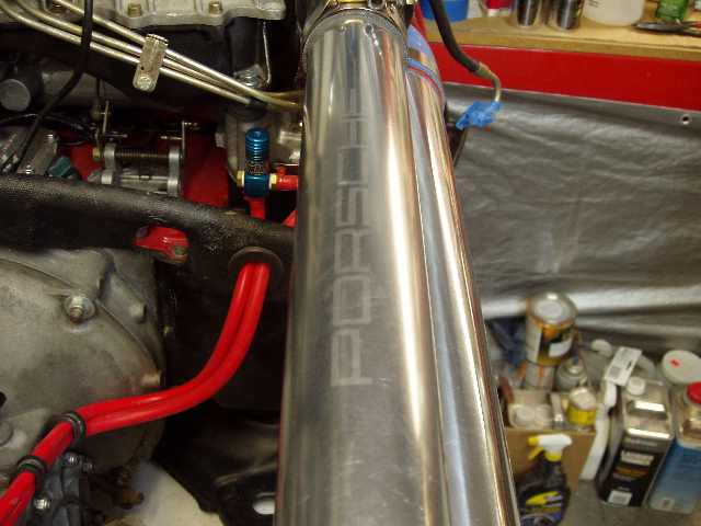

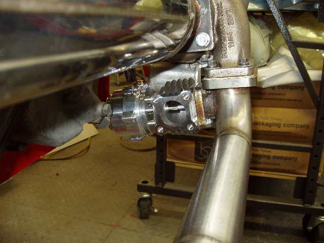

I have to catch up on some work today, I re-fabricated my muffler hanger to accommodate a larger wastegate, I now need to do a little welding on it to re-strengthen it.
I sandblast etched into the aluminum intake pipe the Porsche script.

Here is the engine layout. I have made a few changes since this picture, but it gives you an idea.
iamchappy
post Aug 23 2007, 01:20 PM
It all happens so fast!
Posts: 4,893
Joined: 5-November 03
From: minnetonka, mn
Member No.: 1,315
view of tail pipe. Now back to work...
