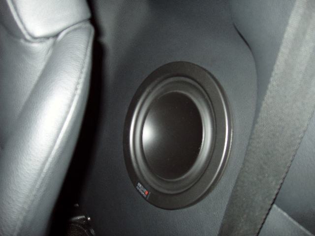

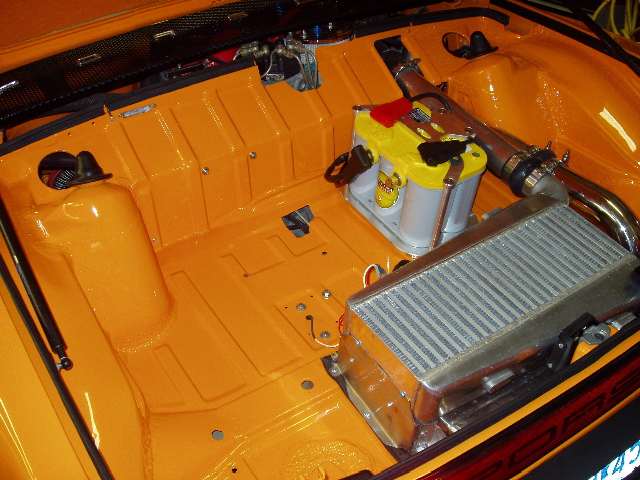

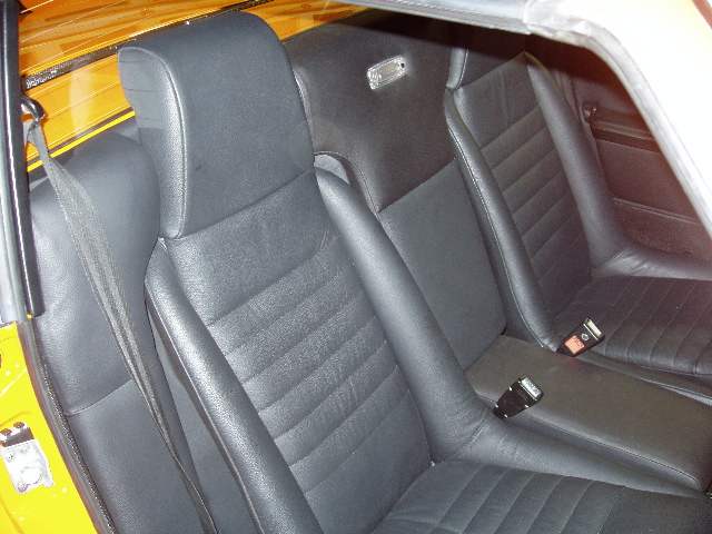

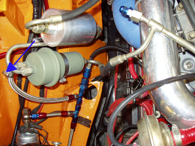

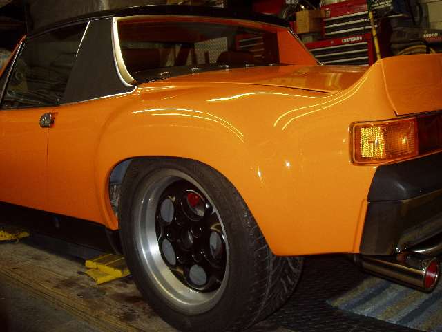

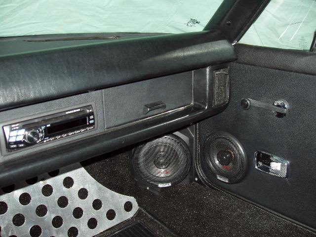

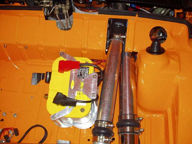

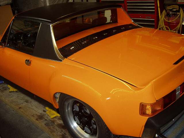

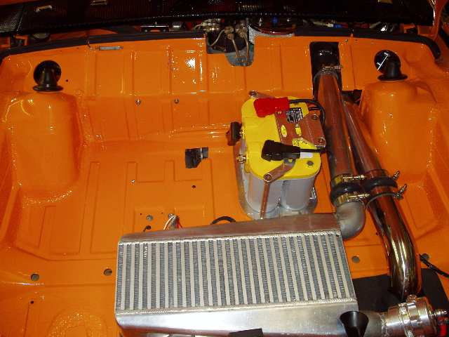

I replaced the oil return tube, I have the interior finally in, the stereo's all hooked up(nice). filled it with new Brad Penn break in oil and a filter. Got the rear trunk panel in and hooked up the latch and installed the engine lid.
Now I must wait for the roads to be clear and dry, temps falling into the below zero's tonight but looks like a warm up possible next week.

she'll never be that clean again!

Oh hell man, you cant drive that car...its too darn purdy to get dirt on! I am dying to know how fast she'll scoot though.....

Your right about that, right now the only thing i have had to use on it is a California duster.
I have to hold out until the snow and road salts have worked of the road, were still in a snow front were expecting a few inches over the weekend. It's full on winter here right now.

What an inspiration to get to back to work on mine. You've done a beautiful job. (IMG:style_emoticons/default/smile.gif)

Thanks for the pics! That is absolutely beautiful. How is the engine oil leak situation? I assume that it doesn't drip a drop now.
Bill
