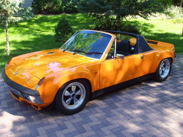

Great news! car is on the road, zero oil leaks, underside of engine is dry as a bone.
Now just need to put some miles on the clutch to see if it can hold a blast off.

Driving around has been great! (IMG:style_emoticons/default/driving.gif) no more hosing the engine down with brake cleaner after a drive.
It's going to be hard driving it around easy for the next 500 or so miles to break in the Kevlar clutch, i only slightly touched boost last night and the clutch slipped immediately (IMG:style_emoticons/default/w00t.gif) i got the peddle in as fast as i could and was off the gas. I will report more as i log some more miles.... (IMG:style_emoticons/default/bye1.gif)
