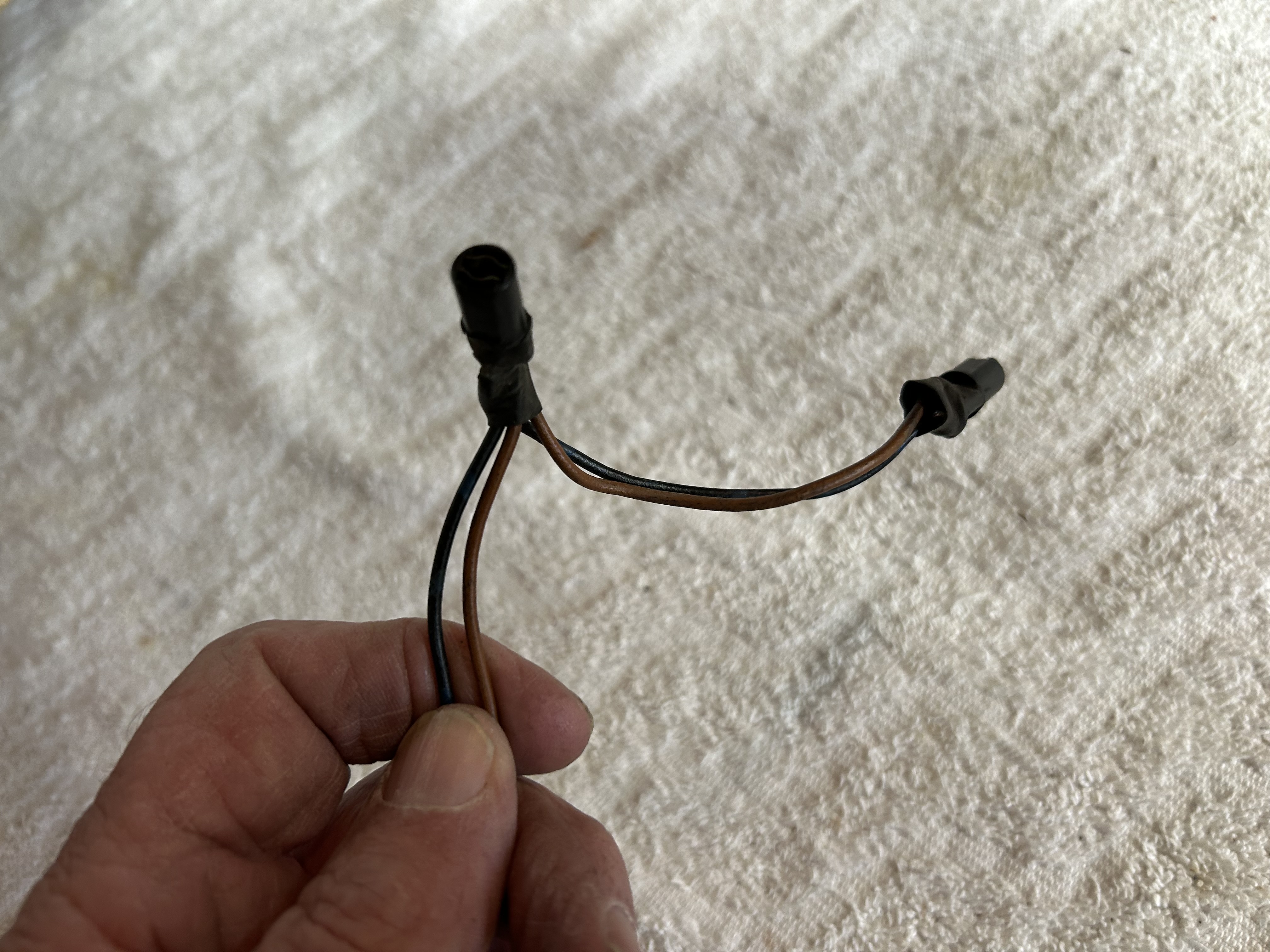

My local supply is gone, is there anther socket that will fit ? These are 8mm

These are them, right?

QUOTE(Root_Werks @ Nov 6 2024, 01:22 PM) *
Looks right; are those wedge bulbs designated as T10 ?

Hard to tell without a picture, but could be these if no base. "grains of rice" bulbs. Available almost anywhere. Make sure of size and voltage
(IMG:http://www.914world.com/bbs2/uploads_offsite/i.imgur.com-14731-1730989347.1.png)
