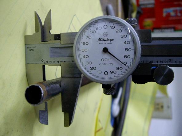

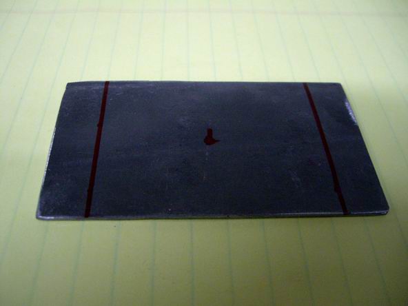

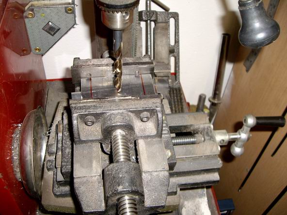

Already ordered some tubing from McMaster-Carr.......................

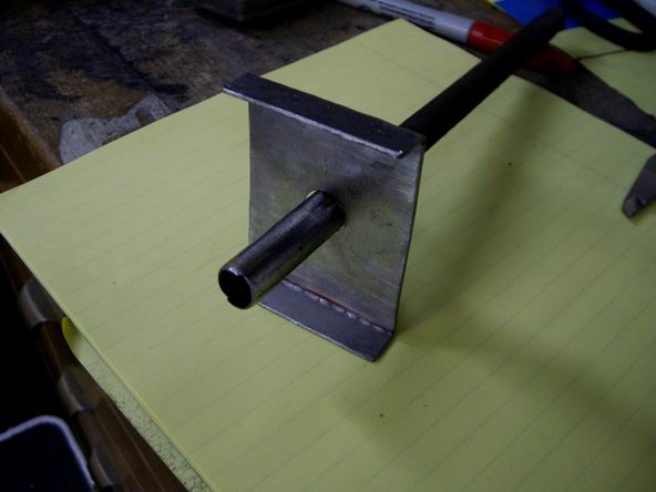

Lets make a couple of clutch tube brackets. Take some measurements.
Cut out some burly 16 gauge steel. Drill the hole and form the bracket.
Instead of 3 mounting point's I will have 4 (front, middle and rear, plus the firewall. It will never break loose.

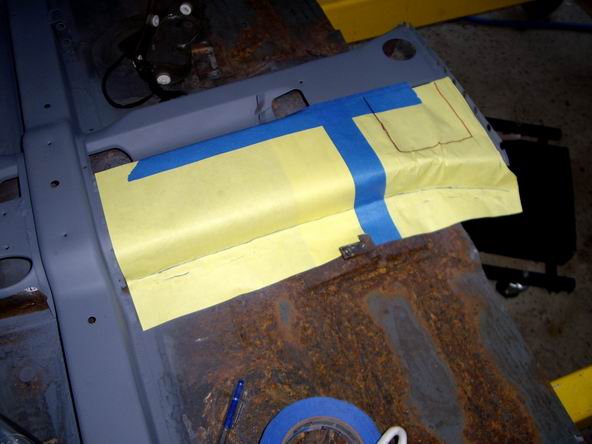

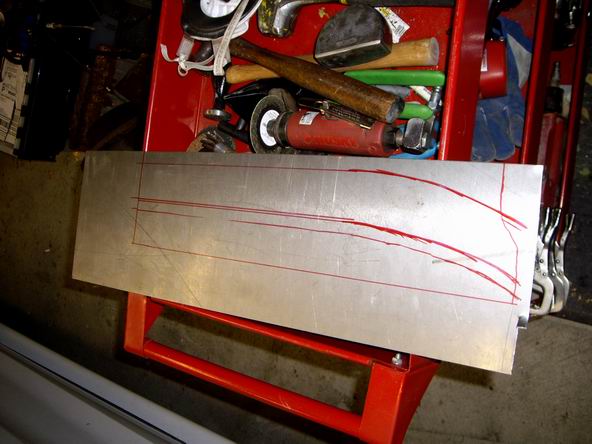

A little work on the tunnel also.
Made a template from paper and transferred to metal for the driver side rear.

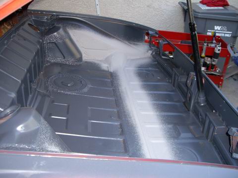

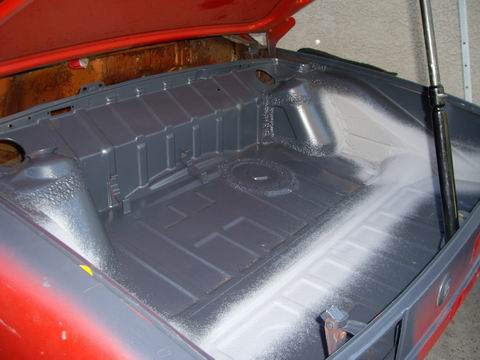

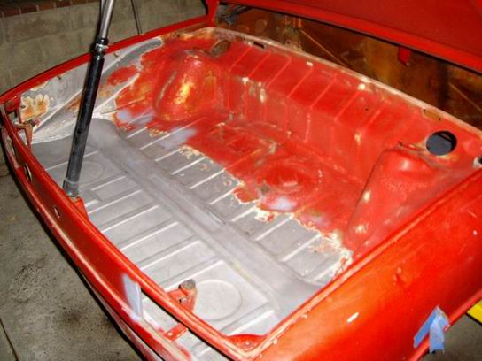

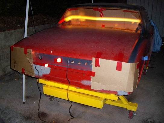

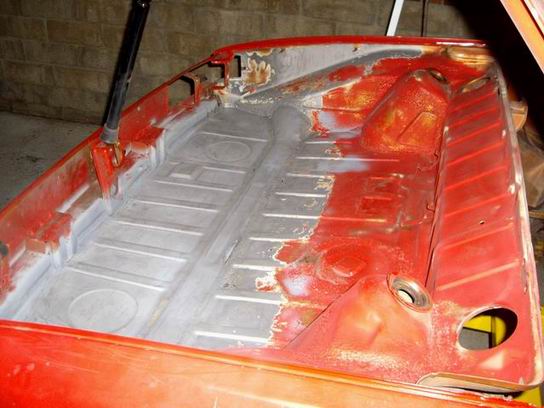

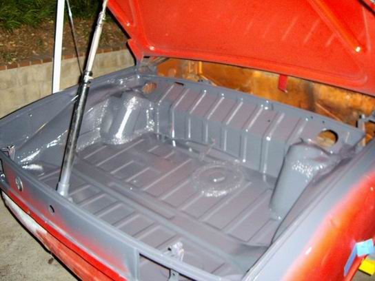

Did some finish work in the trunk. Welded up some pin holes from the floor replacement. 100 pounds of StarBlast just sitting, might as well strip some paint!
Media blasted the rear trunk, removed some scale at the taillight pockets and wheelhouses. A little feather edging. Now it's about 6 o'clock and the sun is down.
A little fog is coming in tonight. Moisture and cold air is not what I need right now. The media blasting removed the zinc coating on the new rear floor. I need to get a coating on this now.
Epoxy primed the rear compartment in the dark with a couple of floodlights so I can see. Finished the primer and the temperature dropped to about 58 degree's. Epoxy Primer won’t kick if it's to cold.
With two heat lamps I created the "Worlds Largest Easy Bake Oven". It's a toasty 85 degree's inside the trunk. Enough to cure the Epoxy primer.

Sprayed the Wurth Seam Sealer in the trunk. Finally looks like a trunk again.
This will all get get covered in color later.

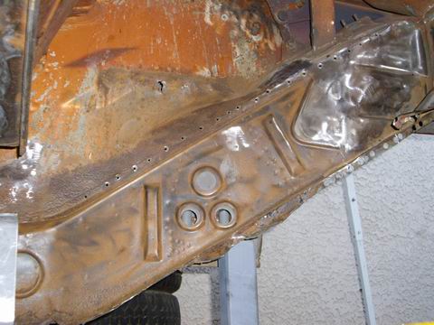

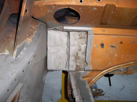

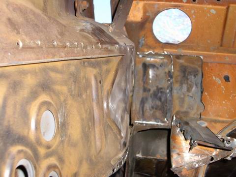

Did some more access work for the right rear long replacement. This piece is a bitch to install the entire part. Would be easier to section it behind the suspension console. The high road taken.
I had to cut a window at the trunk bulkhead. No way to get the whole piece in without the cut because it installs from below. I also media blasted the wheelhouse
and bulkhead joint. This area is really tight to weld in so better it as "clean" as I can get it.

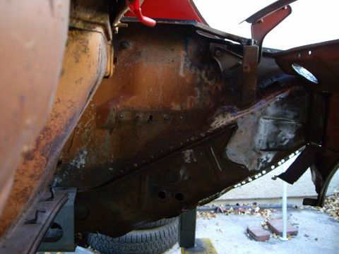

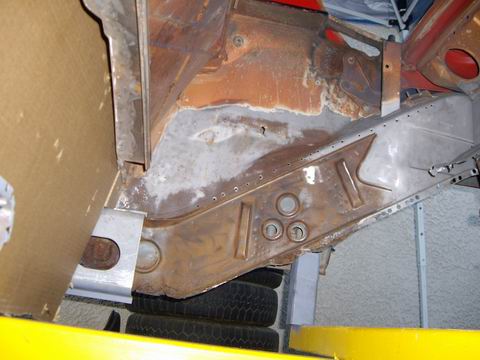

As you can see the rear long junction at the bulkhead is really confined behind the first wall. It was gas welded at the factory behind the first bulkhead wall. No access for factory resistance welding. This is a significant connection so I want full access to weld all 3 sides. I used a worn cut off disc to get access ( 2 inches of disc) for the vertical cut.
The last pic is before the prep work (ugly)

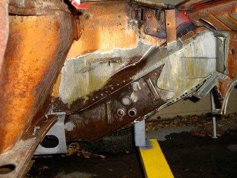

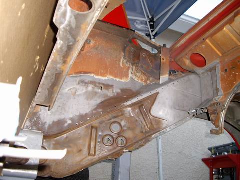

Applied some Metal Ready for conversion coating. This way once I install the rear long it will have some corrosion resistance inside the panel. These will get cavity waxed at completion after epoxy primer.
I am going to section the lower wheelhouse. You can tell from the battery tray area down the rust has perforated the panel just behind the firewall. This was planned so when I install the inner rear long I will not weld it to the wheelhouse.
Not even the media blasting would remove the rust. Pitted badly.
I do not want to cut both the wheelhouse and inner long at the same time because the entire right 1/4 of the car is supported right now. I will join the rear inner long to the mid long and weld at the trunk bulhead. This way I have still retain full support during structural repairs.
Once I cut the wheelhouse section I can coat the entire inner long from the wheelwell side with epoxy primer (except the flanges) and it will have superior protection.
