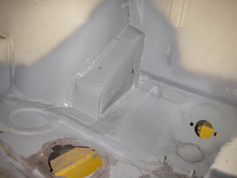

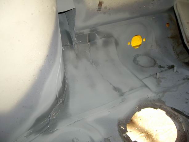

Jeff Hail   Contd Rear floor replacement. An yes the RD flo...   Oct 1 2007, 11:41 PM

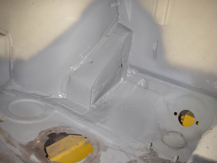

Jeff Hail   Floor metal finished and primed. No filler. I did ...   Oct 2 2007, 12:54 AM

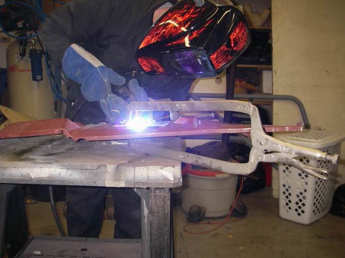

Jeff Hail   A little more on welding thin sheetmetal: Use wel...   Oct 20 2007, 11:13 PM

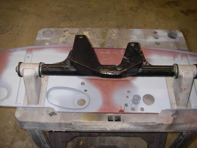

Jeff Hail   Stuff that is easier to do now than later. I am u...   Nov 4 2007, 07:41 PM
Jeff Hail   Wondering how I flaired the tube? After rummaging ...   Nov 4 2007, 07:46 PM
Jeff Hail   Mig welded the spigot to the firewall and some pri...   Nov 4 2007, 07:48 PM
Jeff Hail   Moving along to the E-Brake Cable delete. Cut out...   Nov 4 2007, 07:55 PM
Jeff Hail   A little finishing with a grinder and conditioning...   Nov 4 2007, 08:03 PM

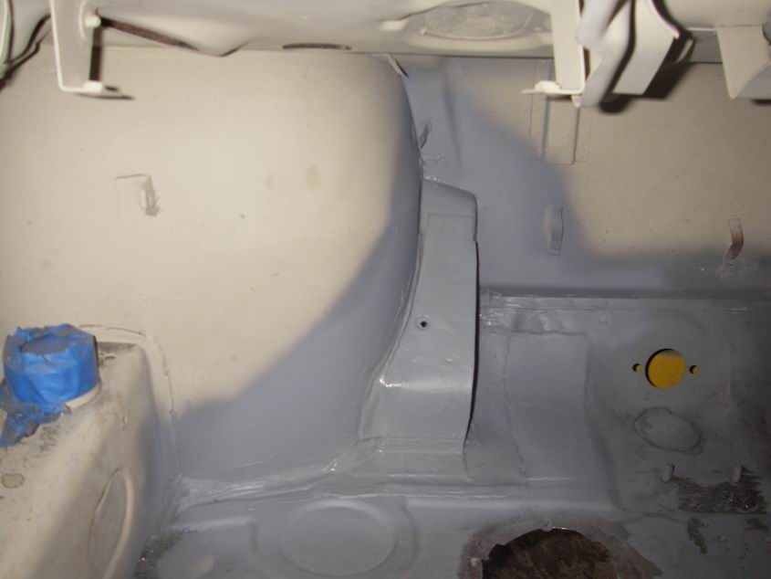

Jeff Hail   Corrosion Protection: I cannot stress enough abou...   Nov 4 2007, 08:30 PM
Jeff Hail   I decided to leave the early boot cup on the shift...   Nov 4 2007, 08:38 PM
Jeff Hail   Didnt get any work done on the tub during the week...   Nov 10 2007, 09:50 PM
Jeff Hail   Again the rear floor behind the seat crossmember i...   Nov 10 2007, 10:14 PM
Jeff Hail   Once everything has sat a little while it is then ...   Nov 10 2007, 10:24 PM
Jeff Hail   Working in smaller area's makes it easier to m...   Nov 10 2007, 10:48 PM
