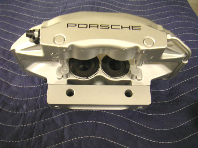

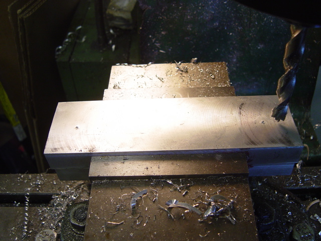

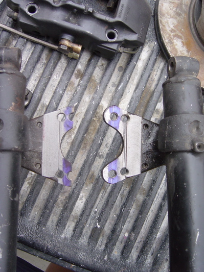

Getting ready to drill the mounting holes showing the marks made by the transfer
punch.

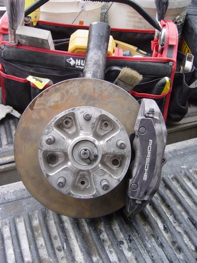

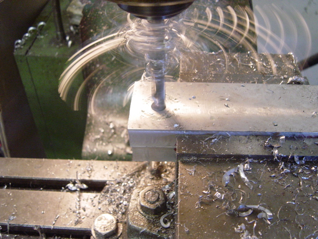

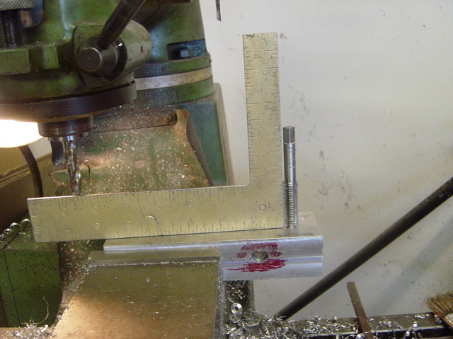

Drilling the holes
Tapping the holes making sure the are square

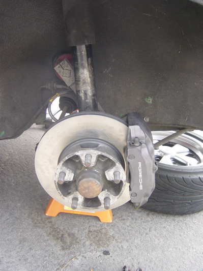

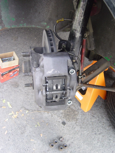

Caliper mounted to the strut

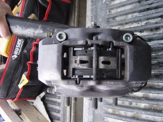

Cutting off a little of the old mounting ears so the inboard pad will go all the down
in the caliper.

Sorry messed up again this is the 1st time I have posted pics so I'm still learning.
Anyway the 2nd photo above the caliper is mounted with the pads and is ready to go.
Here is another one

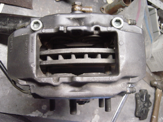

Here it is installed in the car
