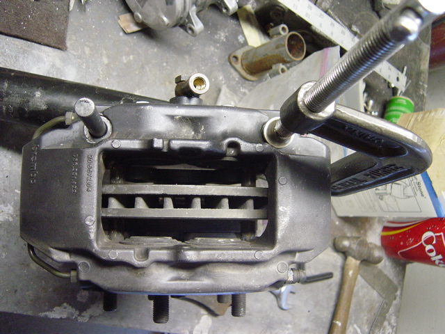

Boy do they work. We got them mounted and went for a spin. Got down the street
a little bit and Aaron gave them a firm petal and holy sh*t they are powerful with no
lock up. This was with the stock rear calipers. I can imagine how it will be with the
boxster rear calipers installed.

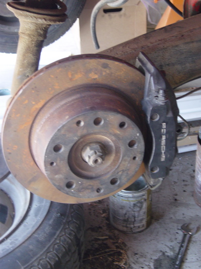

Here is the rear mocked up. Just have to install a 911 e-brake 1st

Oh the rears are a lot easier. They just require a aluminium adaptor that bolts
to the stock mounts

The brake line fittings on the caliper (Banjo) are they stock boxster? I need a set for a 993 brake conversion for my rear calipers. It is tight between the caliper and trailing arm. Those would be exactly what I need instead of trying to make a tight bend with a steel brake line.
Thanks! great thread

The banjo fitting is from a 911 M caliper

QUOTE(craig downs @ Jan 12 2008, 03:48 PM) *
I have several sets 0f 911 M calipers, two 911 front suspension setups and none have banjo fitings.
Thanks,
Ken

with these pictures, and a set of boxster calipers + a mill- someone could recreate these pretty easily. Just takes some time. I'm sure we could even supply some dimensions if someone wanted to make some.
there are adapters out there already for putting them on 3.5" struts..... just not 3" struts.
