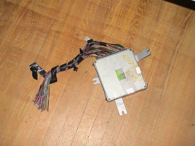

QUOTE(jkeyzer @ Jan 8 2004, 12:58 PM)
What not just get the MAF sensor you need and run it in stock configuration at least until you make sure everything works?
If it has coil on plug stock then it should have all the sensors it needs to make coil on plug work with aftermarket parts too. (?)
Firstly, I don't know which MAF sensor. I could track one down, but this vehicle is rather obscure, so it may be easy or tricky. I have a feeling I need a specific type which may not be available in the US, since there have only been a few Subaru Turbos here to date, and Subaru switched from MAF to MAP before the new ones came out.
Next up, I have the ECU. I have the gred box with about 80 wires hanging out of it. Most of therm are different colors. They are different thicknesses. Some of them are bundled in groups of 3 or so. Others are not. I do actually have a wiring diagram now. It is 66 pages.
The wiring diagram makes this possible, instead of impossible. Having said that, wiring up a tomtek or a megasquirt is a breeze, plus you can dial it into a PC to figure out what the problems are. None of these things are possible with the stock system., Plus I will have different exhausts/intakes, etc, which might freak out the stock computer.
The Haltech is attractive, but not cheap by any means. Not sure if I want to go that way or not yet.
Fiid.

I would lean towards getting the stock configuration running as it came from the factory. Leave the cat in place to restrict flow to the turbo. Keep the stock computers for fuel and spark. You know it will work and get you the 275 you expect. Rengineering so many aspects at a time will be tough to tune. MAFs aren't all that special. Talk to your scooby friends and see what they suggest.

QUOTE(fiid @ Jan 8 2004, 01:22 PM)
Why is it so hard for people to remove wiring harnesses correctly? That sucks. I feel your pain. (IMG:style_emoticons/default/sad.gif) It is a shame because stock ECU would be pretty much plug and play.
A friend of mine bought a whole 93 Firebird because he wanted the LT1 AND the computer AND the wiring harness, and it was easier to take them off himself than deal with whoever chopped up the wiring on most of the used engines around.

I actually don't have the cats - or even the flanges for the turbos.
Here is the engine computer as I have it. The wiring harness for the engine looks about the same (i.e - chopped before the plug).

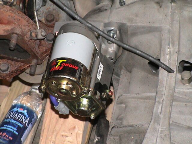

The IMI starter arrived today. It works nicely, and fits in the gap next to the turbo.
Good call Brad! (IMG:style_emoticons/default/smilie_pokal.gif)

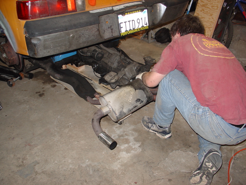

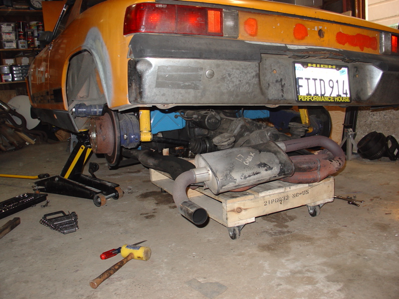

Pulled the 1.7 engine out today.....

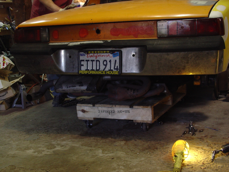

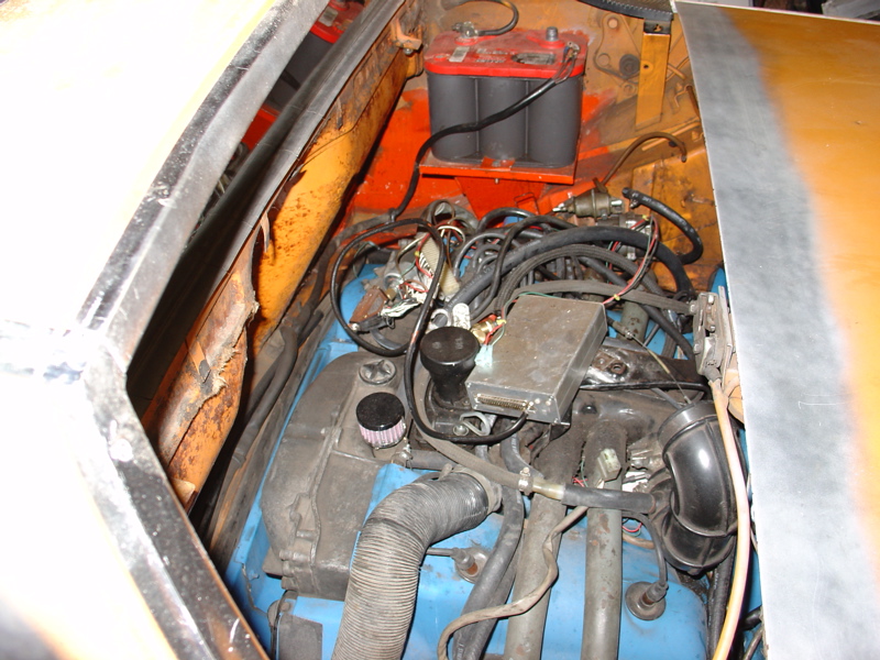

foom

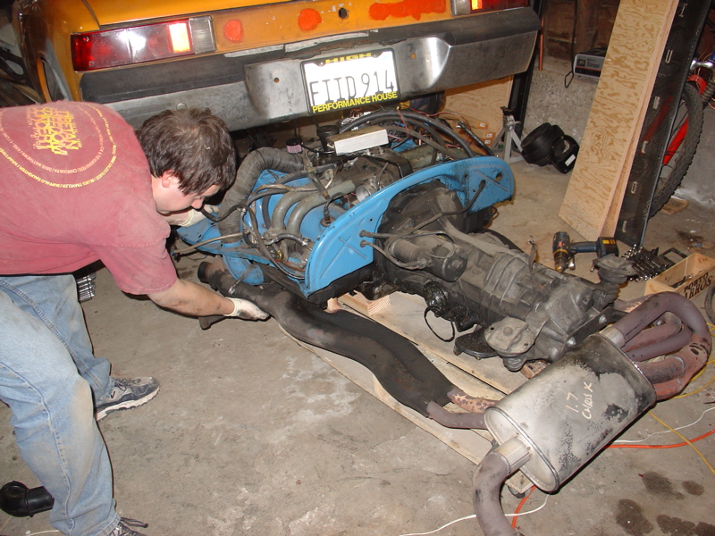

jackin off

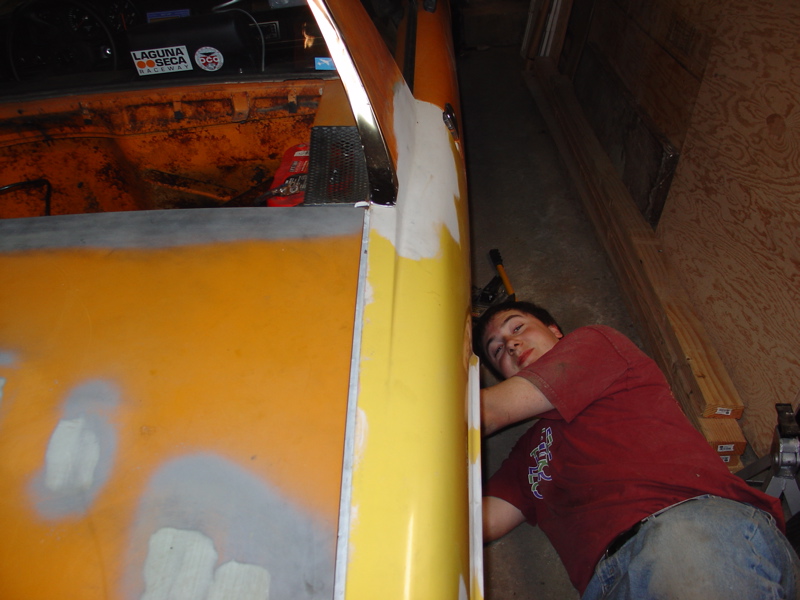

wonder who "chris k" is?

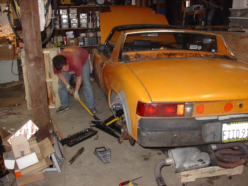

engine removal is a surgical process....
