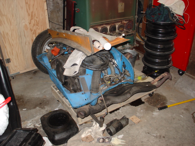

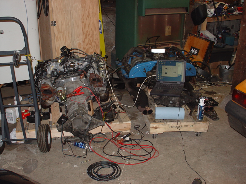

Two flat fours and a microphone.

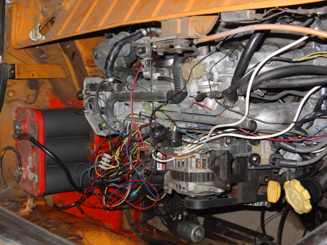

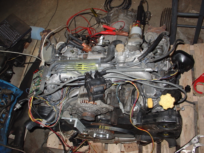

I did a bunch more work on the wiring last night.
The Megasquirt now has inputs and control for: * Spark * Crank position (via EDIS) and Tach (consequently) * Injectors * Throttle position * Coolant Temperature This means it's seriously close to being runnable :-) I have a workable strategy for building a pretty sophisticated boost controller - more on that later! If anyone is interested in getting crankfire (EDIS) going with a T-IV motor - I have a set of plug wires that would probably work for it... I had to by two sets of Ford Escort plug wires so that I would have 4 long wires, so I have a set of shorter ones that would likely be more suited to a T-IV application. Attached image(s)

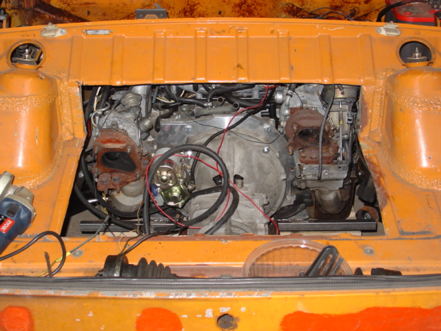

I put the engine under the car today. Seems to fit like a glove - although I have kissed goodbye to the idea of getting very much stuff in my rear trunk.

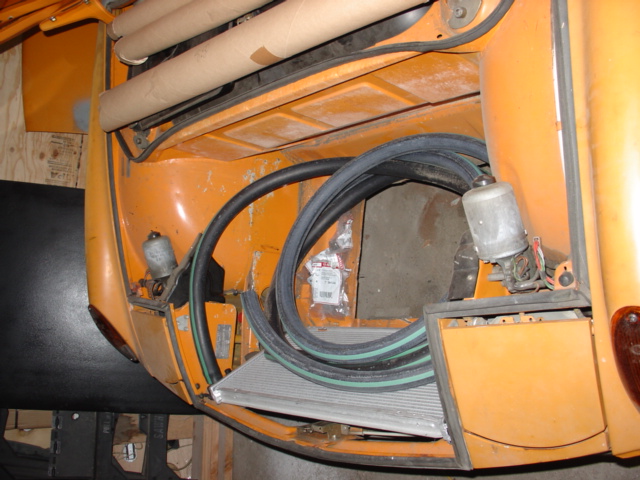

Heres the front trunk. I am aiming to mount the radiator about where it is. The radiator is from a 1991 VW Golf (IIRC).

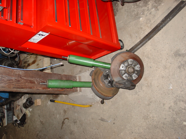

Yummy 911 front struts with 5 lug hubs and A calipers. In the background you can see my new toolchest (home despot special... they sold it to me for a discount because the keys were missing. I found the keys at the checkout, zip-tied to the handle with a security tag (IMG:style_emoticons/default/smilie_pokal.gif) )

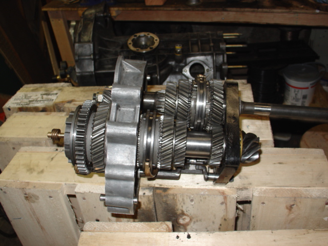

I am in the middle of rebuilding my transmission. This has gotten new synchros on 1, 2, and 3, and new dog teeth on 1 and 2. I think the sliders are okay. I don't really want to spend too much cash on this right now until I figure out weather I need a 915 (argh - wallet pain).

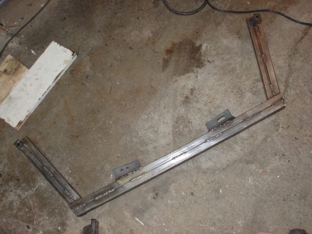

Made the motor mount bar today.
There are issues with the plates that the bar bolts up to - they arenb't strong enough to hold this thing at the right angle - so the next job is to re-enforce those. Attached image(s)
