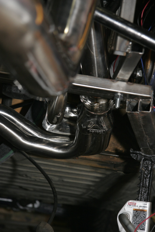

Last shot. This one shows the new header setup. At some point I need to get all this metal out of the car and get it powedercoated or painted.
The header, turbo, and downpipe all came off ebay. All the tubing is stainless and the cost was very low since they are all far-eastern mass produced rice parts. Rice and Bochwurst.... tasty.

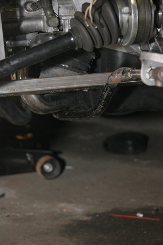

My downpipe has about 3 inches of clearance around the inboard CV joint. Should I be worried about heat radiating into the joint or is this a non-issue?? I suppose plenty of people run headers right under there and they don't have problems.... so.... ???????????????

cv joint should be just fine that close. thats how far the factory one was.....

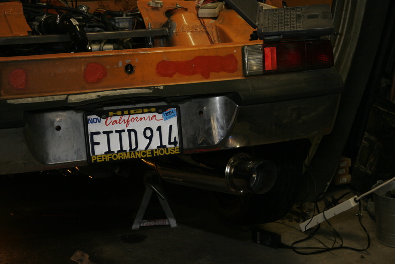

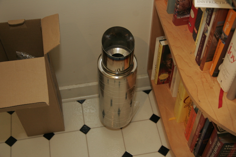

This is my RICE MUFFLER. Turns out it's quite loud. Ooops.

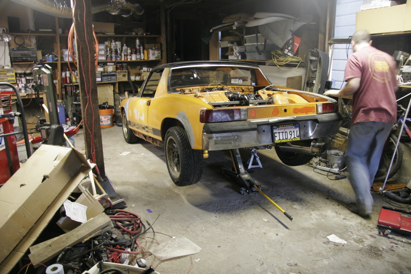

Lowering the car for the first time. I think the new engine is a little heavier than the stock engine; which means that my ride height was way low at the back - this was taken while adjusting it. I think the 175lb springs may not be sufficient with the heavier lump; but that should be reasonably easy to fix since I'm running Eibach coilovers at the back.
I might go to like 250s.

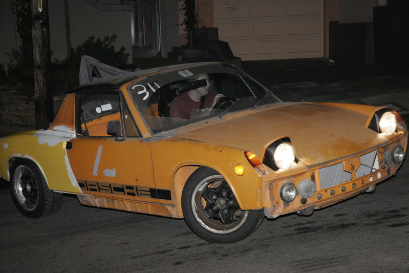

Just about to take off up the street. Car is showing it's best side. (IMG:http://www.914world.com/bbs2/html/emoticons/unsure.gif)
