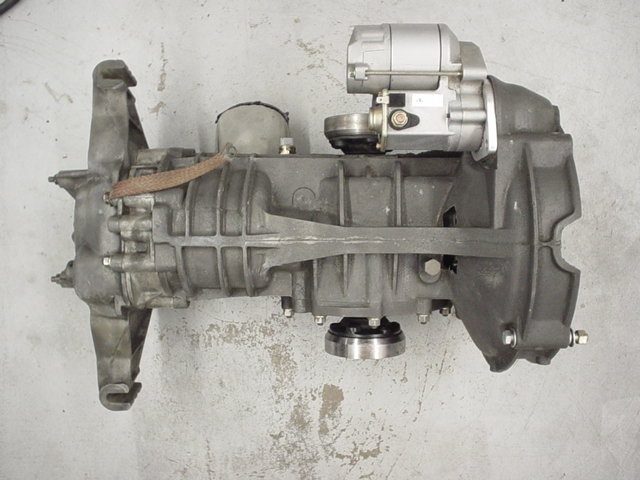

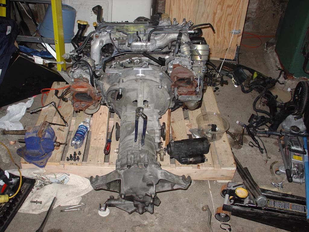

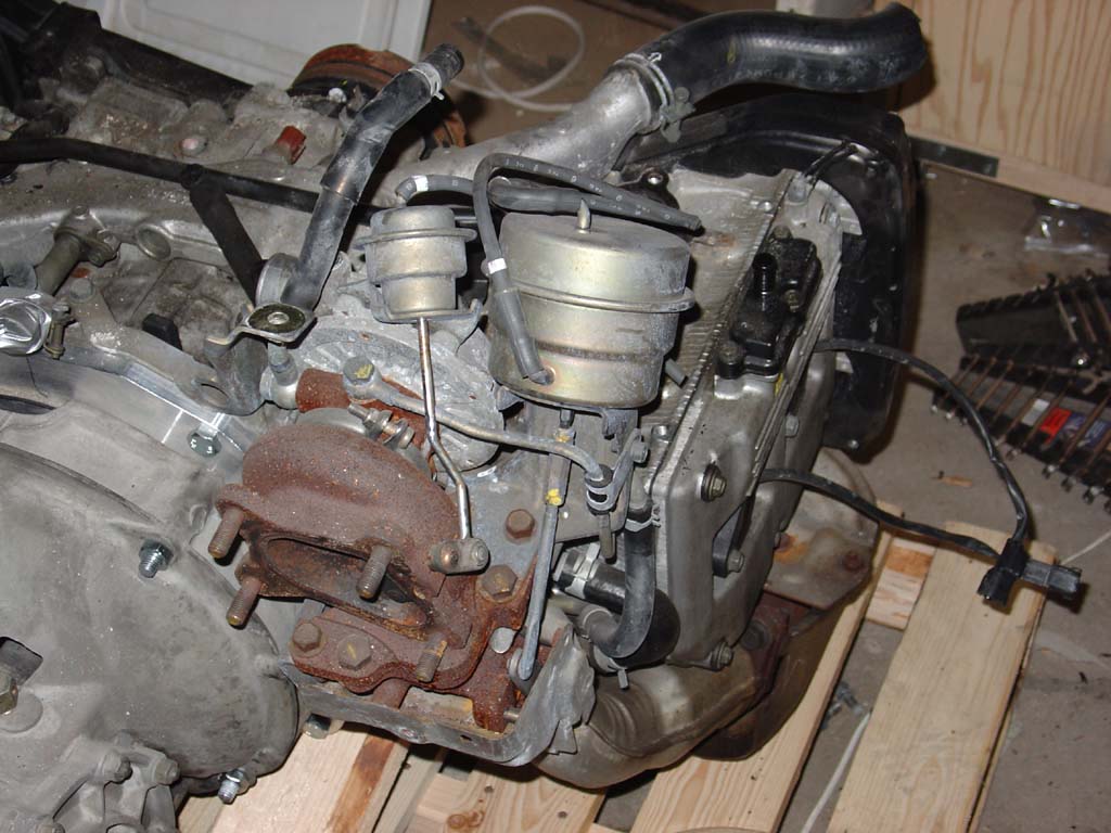

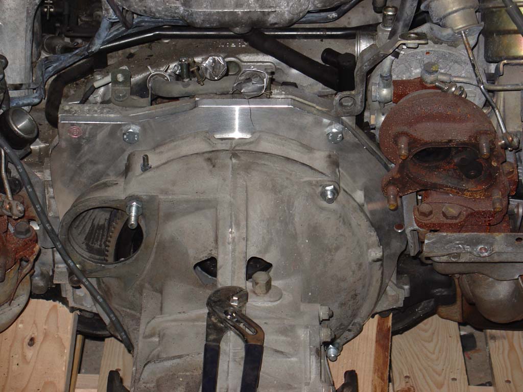

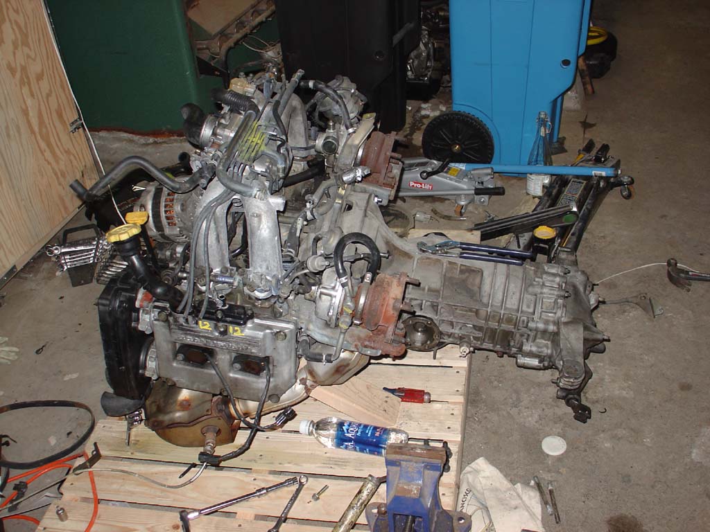

This evening I bolted the dummy transmission to the subaru motor.
Please excuse the mess in my garage.
Here is an aft view.
fiid   Fiid's Project Progress Thead.   Jan 3 2004, 12:59 AM
fiid   Side view.   Jan 3 2004, 01:00 AM
fiid   Count the Cam Shafts!!! (note the sma...   Jan 3 2004, 01:01 AM
fiid   Doh!   Jan 3 2004, 01:01 AM

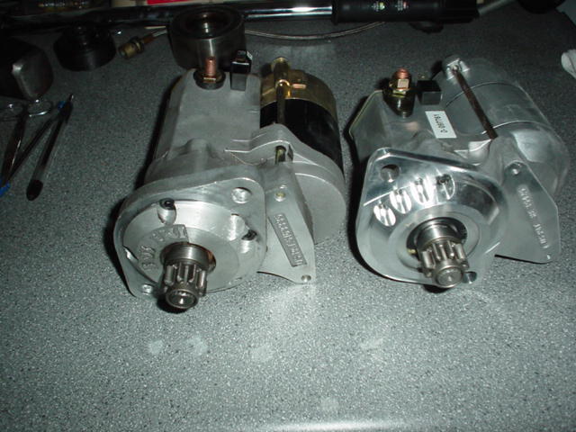

fiid   Now here's the problem. The starter motor rel...   Jan 3 2004, 01:02 AM
fiid   Doh again.   Jan 3 2004, 01:03 AM
ChrisReale   :o Cool.. When am I coming over so we can stand...   Jan 3 2004, 01:03 AM
fiid   Anyone have a suggestion on how to get around the ...   Jan 3 2004, 01:05 AM
fiid   Anytime you like!. Dude - where did you get t...   Jan 3 2004, 01:06 AM
ChrisReale   930 tach, going to be a 4 banger with fuel gauge.....   Jan 3 2004, 01:07 AM
Brad Roberts   Gear reduction starter (189.00) will clear fine. ...   Jan 3 2004, 01:15 AM
fiid   Where do I get one? Doesn't it look great? ...   Jan 3 2004, 01:18 AM
Brad Roberts   The exhaust is going to be really easy and a COMPL...   Jan 3 2004, 01:20 AM
BIGKAT_83   The IMI HI TORQ starters can be indexed to differe...   Jan 3 2004, 01:21 AM
Brad Roberts   I lied. 159.00 Specify BUS tranny when calling. 8...   Jan 3 2004, 01:24 AM
fiid   Hmmm... apparently there is a chevy part that will...   Jan 3 2004, 01:29 AM
fiid   Sometimes - I should just shut up.   Jan 3 2004, 01:30 AM
fiid   > If any of you are looking for a small body gear ...   Jan 3 2004, 01:31 AM
Brad Roberts   I agree :lol: :mueba: B   Jan 3 2004, 01:32 AM

soloracer   With the starter so close to a potentially red hot...   Jan 3 2004, 10:47 AM
Andyrew   Header wrap the starter?   Jan 3 2004, 10:58 AM
BIGKAT_83
  Jan 3 2004, 07:58 PM
Brad Roberts   But the solenoid was in the same place as stock an...   Jan 3 2004, 08:22 PM
Brad Roberts   Oh.. and I would imagine you would have to modify ...   Jan 3 2004, 08:24 PM
John2kx   I was thinking the same thing Brad......about havi...   Jan 3 2004, 08:39 PM
John2kx   Fiid, This might shine a little more light on the...   Jan 3 2004, 08:41 PM
Brad Roberts   We can actaully move his engine forward several in...   Jan 3 2004, 08:43 PM

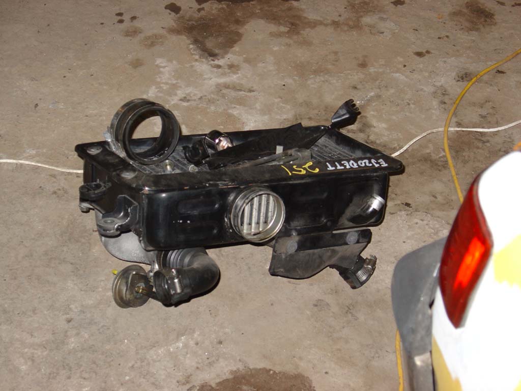

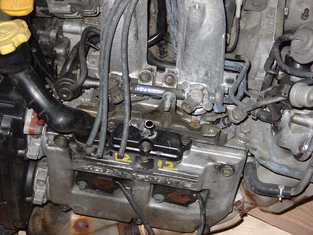

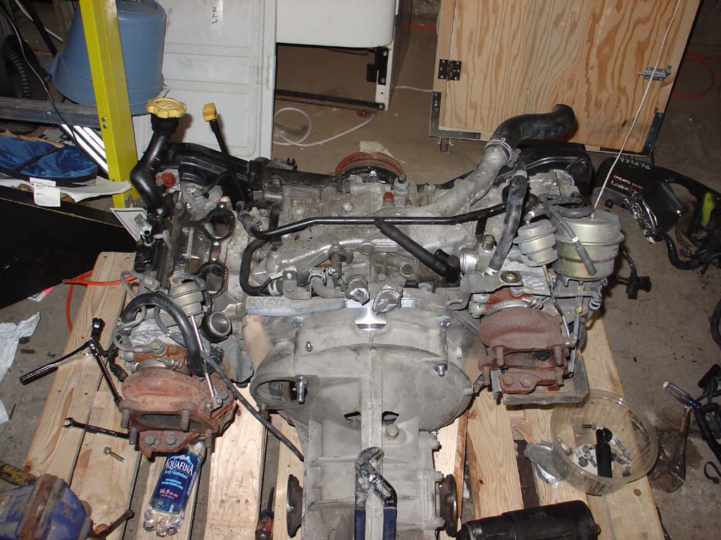

fiid   Mo Engine Pics. Lat night I pulled the intake man...   Jan 4 2004, 05:22 PM

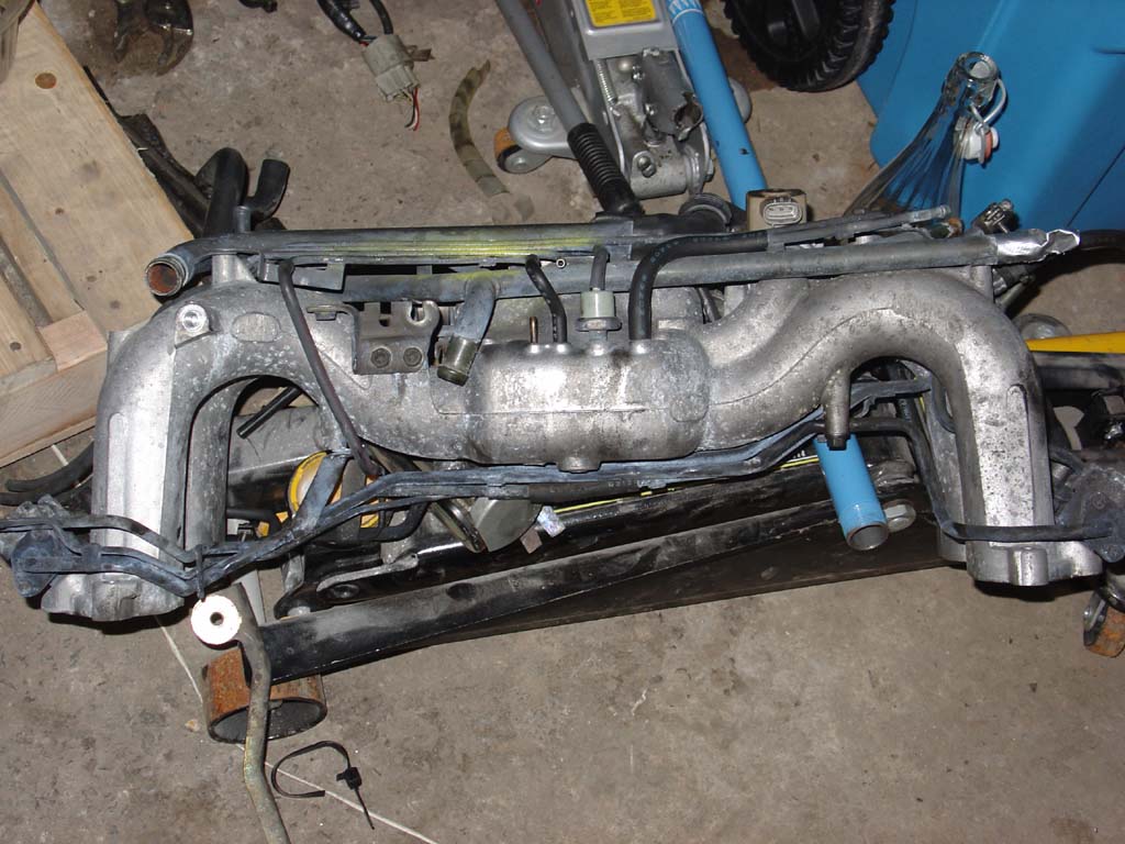

fiid   Side shot of engine with intake on backwards (just...   Jan 4 2004, 05:25 PM

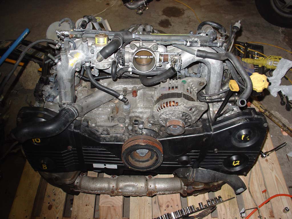

fiid   Aft shot of engine with intake on backards.   Jan 4 2004, 05:25 PM
fiid   Front view of engine with alternator resting appro...   Jan 4 2004, 05:26 PM

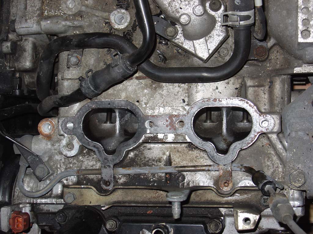

fiid   Close up of Kennedy Adaptor plate. At the top you...   Jan 4 2004, 05:28 PM
fiid   This is the oil filler neck and intake runners (1 ...   Jan 4 2004, 05:32 PM
fiid   The engine and tranny with no intake manifold.   Jan 4 2004, 05:33 PM
fiid   Closeup of right side stage 2 turbo. The large ai...   Jan 4 2004, 05:35 PM
fiid   MMMMMMMMM. Intake valves. The line shown here is...   Jan 4 2004, 05:37 PM
fiid   And here is a 4 legged alien.   Jan 4 2004, 05:38 PM
fiid   Another fun thing about this engine. There are br...   Jan 4 2004, 05:39 PM
