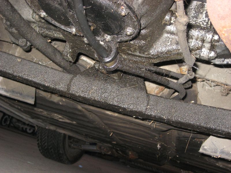

First, I was under there cleaning stuff up. I noticed this on the passenger side of the trans.
I assume that it is the throttle cable, but being this is my first /6, I need to confirm.

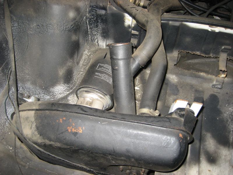

Secondly, I drained the oil from the case and the tank. For those that don't recall, here is my 911 tank, cut into the floor.
Problem is that when I drained the case and the tank, I only got 1/2 gallon of oil. I was expecting about 3.5 gallons (14 qts +/-). Not even close. This is my first dry sump motor, so am I missing something?

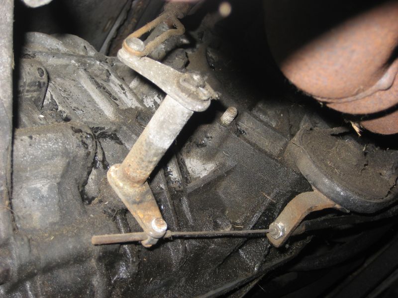

Here is a picture of the engine mount bar.
I don't know if this is stock, custom, aftermarket or ??? A little help pls. The mount bar sits so low that the side shift trans rod is above it.
Lastly, when I got the car, the PO said that he had buggered up the trans. Its a side shifter. I cleaned it up a little and took off the shift rod head and the ball socket. It's a new socket bushing which is nice.
I was able to move the selector through all gears. I noticed that the shift rod head was about an inch longer than the one on my car. In fact, it looked as if it was extended somehow. It's odd. I noticed this because I had to put the bushing on the ball and snap it down, before inserting it into the shift rod head. If I didn't do that, the shift rod head was so deep that I couldn't push it on. I am hoping that I get lucky with this.
Also, the cone set screw was replaced with a longer set screw, with a square head, that is drilled so it can be wired for additional safety.

Yes, that's your throttle linkage. I think you could fit that tank where the 914-6 tank belongs. You may have to do a little fab work but it would give you back your trunk .... (IMG:style_emoticons/default/sawzall-smiley.gif) (IMG:style_emoticons/default/smash.gif) (IMG:style_emoticons/default/welder.gif)

From the looks of the motor it has leaked a couple.
Just because it should have had , doesnt mean it did.
no worries ,add some oil and gas , fire it up , check the level.

Do I check the level with the motor running? How do I know how much oil to put in? Do I assume it's empty now? Do I just add the oil to the tank?
Yes, put in about 9qts, start and check, Yes and Yes

Do you have a oil line that runs from the trunk mounted tank to the block?
Thats the line you need to remove (one end) and make sure you have drained all of the oil out of that line.
Question. Where did you drain the oil from to get 1.5 quarts of oil...??????

I drained from the bottom of the case and the bottom of the oil tank.
There are three lines from the tank to the motor. Two up top, one below. The one at the bottom "seems" to go to the case. I haven't gotten a great look down there, but it might be an oil cooler. I recall seeing behr on it.

Crack (Loosen) all your oil lines that go from the tank to the block and see if any more oil comes out....... I bet you find more.
Clayton
SLITS
post Dec 27 2007, 07:58 AM
"This Utah shit is HARSH!"
Posts: 13,602
Joined: 22-February 04
From: SoCal Mountains ...
Member No.: 1,696
1.) Line one goes from the bottom of the tank to the oil cooler ... drain oil from this line (on a /6 with a stock tank this is a two piece line)
2.) Line two goes from the block back to the oil tank (scavenge line). This oil is sent thru the filter prior to dumping into oil tank.
3.) Line three would be your crankcase breather ... from top of case to top of oil tank.
