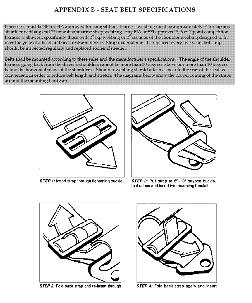

Yes you can remove the extra material, use either a hot knife, or melt the end after you have made the cut.
Leave enough material though to do the "double wrap" as illustrated in club race rules. After you have completed step four you can trim the excess.

Yeah, I ended up calling one of my buddies that knows the SCCA rules to the T and he explained exactly that. Thanks guys.
