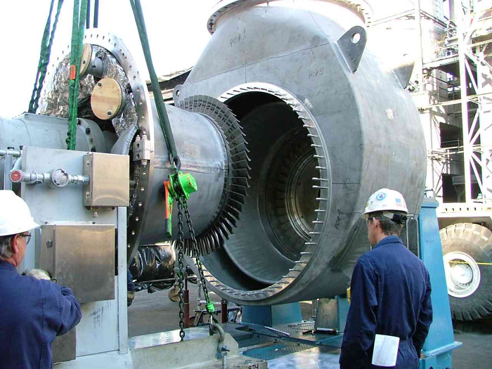

Sammy   Here's a pic of "my friend's" 911 SC with ...   Jan 25 2004, 03:27 AM
seanery   Sammy, been a while. Come back again soon, man...   Jan 25 2004, 08:54 AM
krk     Jan 25 2004, 09:47 AM
Mueller   Hey Sammy !!!! Welcome back(?) :) ...   Jan 25 2004, 11:43 AM
Sammy   Hi guys. Thanks for the welcome. i agree that usi...   Jan 25 2004, 09:12 PM

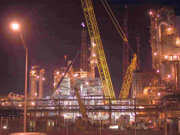

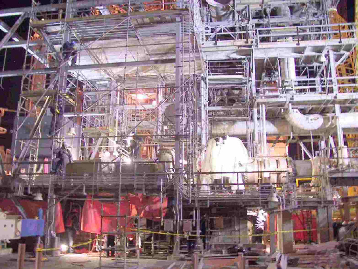

Sammy   Overview of project:   Jan 25 2004, 09:24 PM
Sammy   That yellow crane is rated at 275 ton lifting capa...   Jan 25 2004, 09:25 PM
Andyrew   That better be ball bearing! Or else it will t...   Jan 25 2004, 10:17 PM

Sammy   All Porsche 930 turbos from 1976 thru the later pa...   Jan 27 2004, 03:24 AM

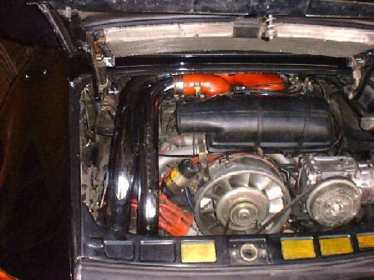

iamchappy   Turbo update, Intake is roughed in as you will see...   Mar 3 2004, 12:36 PM
iamchappy   914 6 3.0 turbo   Mar 3 2004, 12:37 PM
iamchappy   914 6 3.0 turbo   Mar 3 2004, 12:38 PM
Sammy   I was wunderin about using a BOV on CIS. Seems to ...   Mar 3 2004, 12:53 PM
fiid   looks like a nice install! If CIS does the ai...   Mar 3 2004, 01:09 PM
iamchappy   I am thinking of installing the pressure switch be...   Mar 3 2004, 01:09 PM
iamchappy   Oh I see what your question is, hopefully when the...   Mar 3 2004, 01:16 PM
