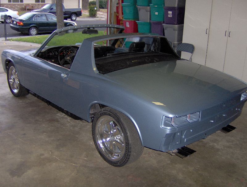

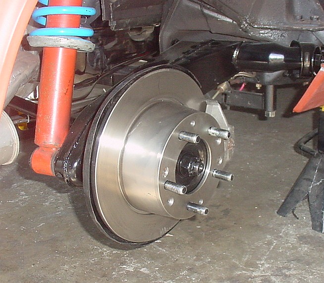

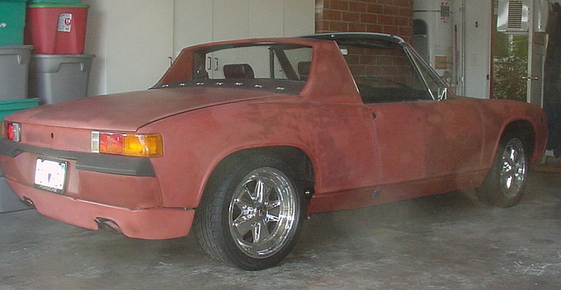

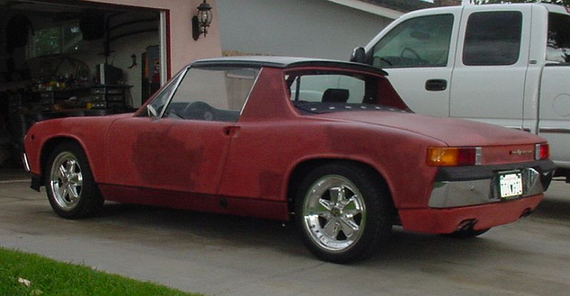

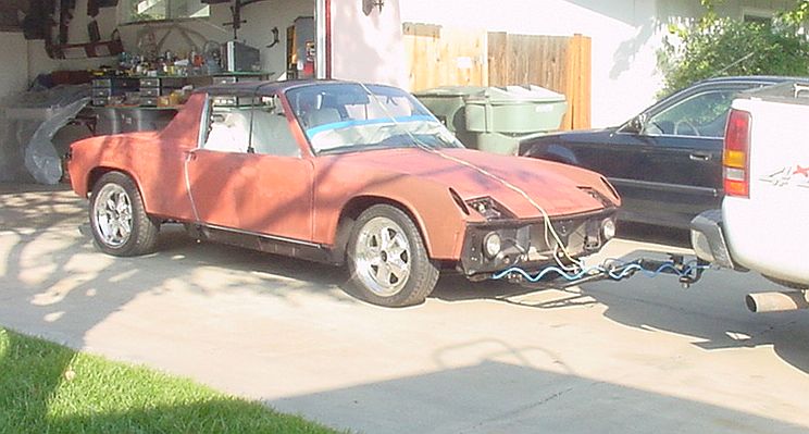

Thanks to Bruce Stone and all his help, I completed my 5 lug conversion, front and rear. Attached ImageToday I was able to install the wheels and drop the car back on the ground. Still needs a front end alignment but it's ready to roll again.
The car sits with a slight rake, with the back slightly higher. Overall the car is now at a nice ride height, which is about 1/1/4 lower than it was when I had 15s with 60 series tires.

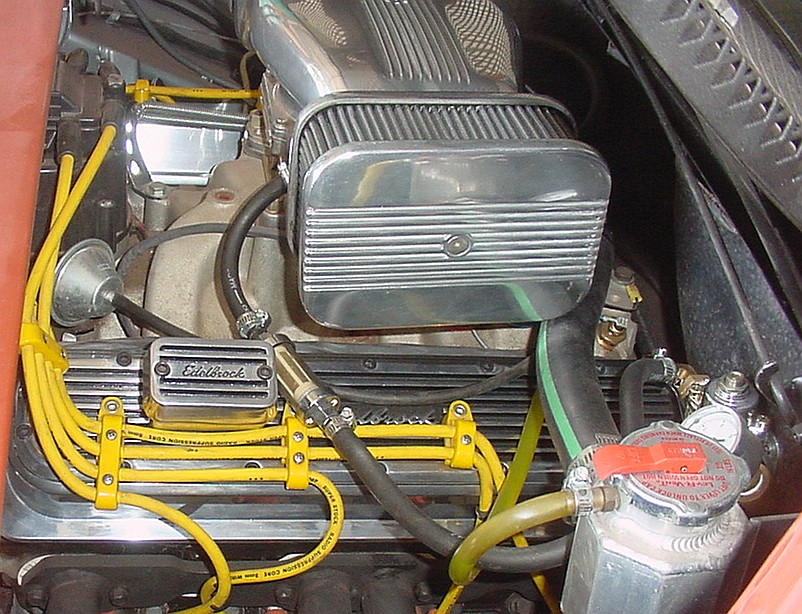

Lastly, also added a bit of more engine bling...Edlebrock Elite series valve covers.

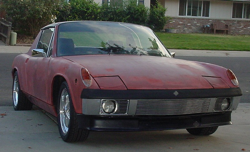

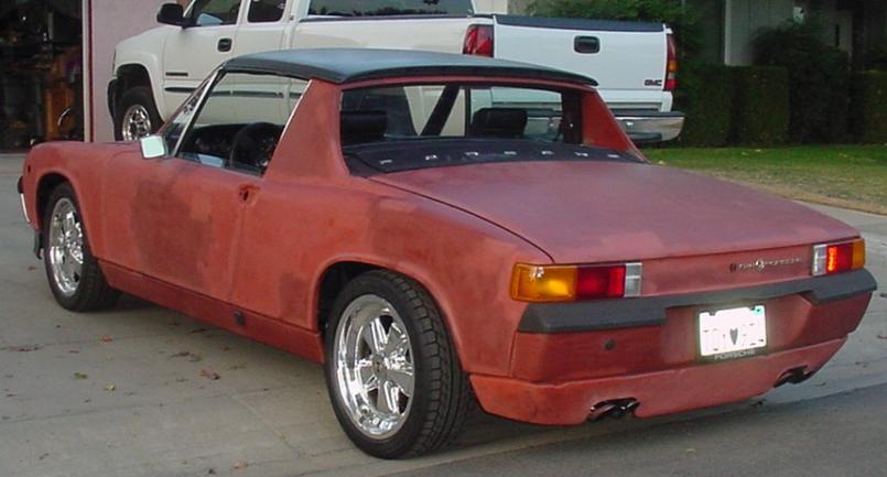

Had some more time to work on the project so I worked on the front bumper and valance. Because of how I'm going to paint the car, I decided I needed some more chrome bling. Took off the painted front bumper and adapted a chrome one for my v8 grill and added a Renegade valance.
I have a decent chrome bumper for the back, but I'm hoping to find a gorgeous one.
Picked-up a 914VWPorsche rear badge, but unfortunately it's the wrong color...I need to paint it black or have it chromed.

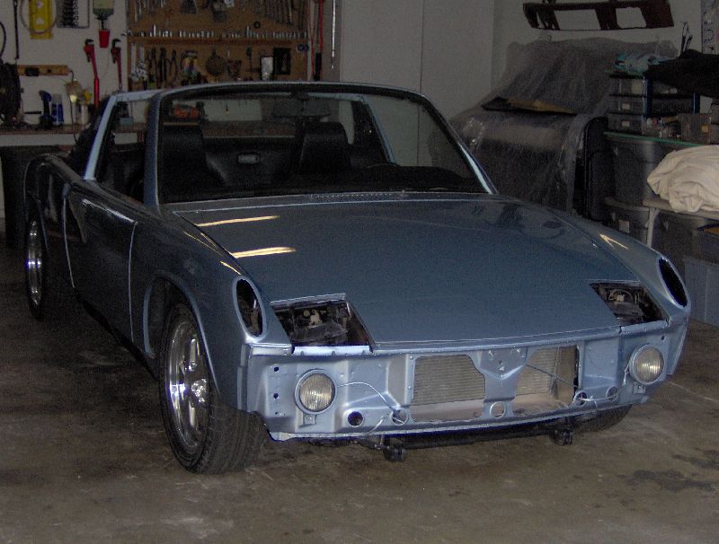

Well, I'm just about about of excuses why I haven't painted this tub. Other than having the sail chrome and window channel chrome detailed by a polisher, I'm stuck on how to paint it.
I intended to paint it marathon blue (sliver blue) but still thinking about...
  • paint all the valances semi-gloss black or go with body color?
  • shave the front turn signals or not?
  • Not to sure about the sail panels to paint body color, or cover with vinyl again?
  • Paint the top body color or black?
  • I'm stuck...can't seem to make a decision!
I need to make some decisions (IMG:style_emoticons/default/confused24.gif)
Or...do I just fear finishing this project because I know I'll need to start another (IMG:style_emoticons/default/stirthepot.gif)

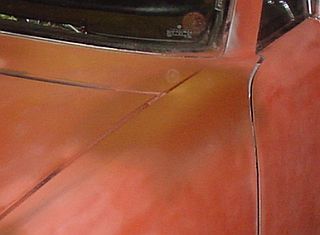

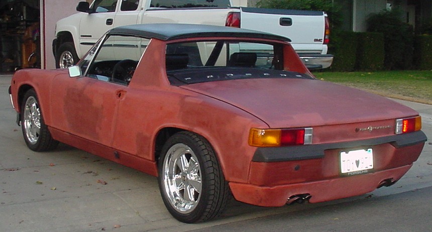

I celebrated Veteran's Day today by shaving my turn signal indicators. Yup...welded them right up and the antenna hole too! I think I'm finally starting to get the hang of welding! (IMG:style_emoticons/default/welder.gif) About time!

In between rain showers, I brought home my 914 from the paint shop. It's pretty gloomy here and getting dark, but here is a couple pictures to get the idea. I had it painted the original color(silver) but for a "74", not 75 which is the year of this car.
L96 Marathon Blue Metallic (base coat, clear coat). In the sun the paint is just beautiful. I'm really looking forward putting all the "bling" back on it. I had much of the the chrome on the car, including the window bars polished.
The really cool thing about picking the car up today, is that 29 years ago today, my wife and I were married and our honeymoon car was a 74 marathon blue 914...how about that for coincidence. I didn't plan it that way. OK...enough about cars, off for a dinner date with my honey. (IMG:style_emoticons/default/grouphug.gif)

Lookin sweet! It will be even better once everything is put back together. Keep the pics coming
Hope you take your wife somewhere nice! Congrats on 29 years (IMG:style_emoticons/default/biggrin.gif)
