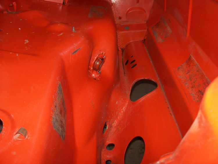

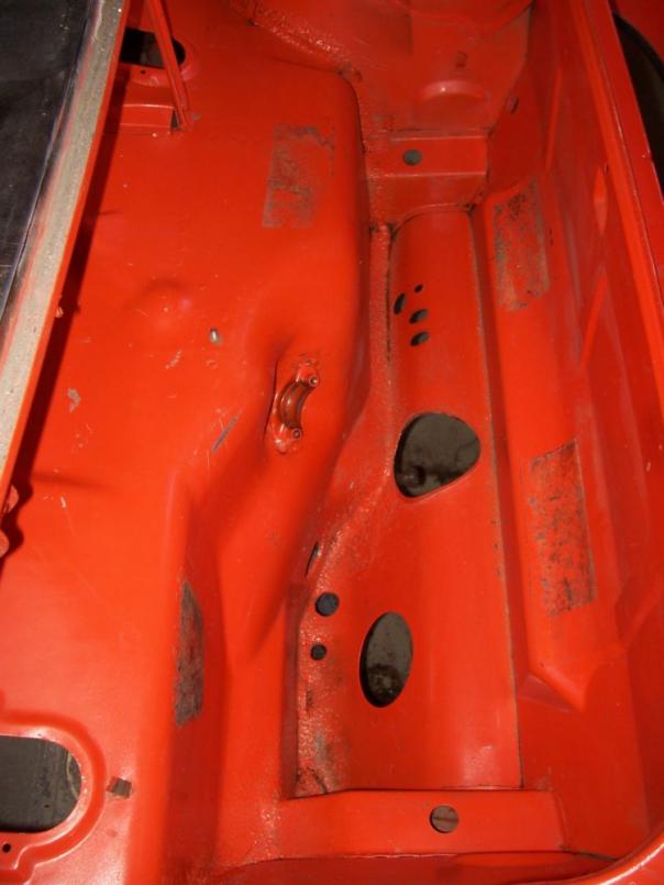

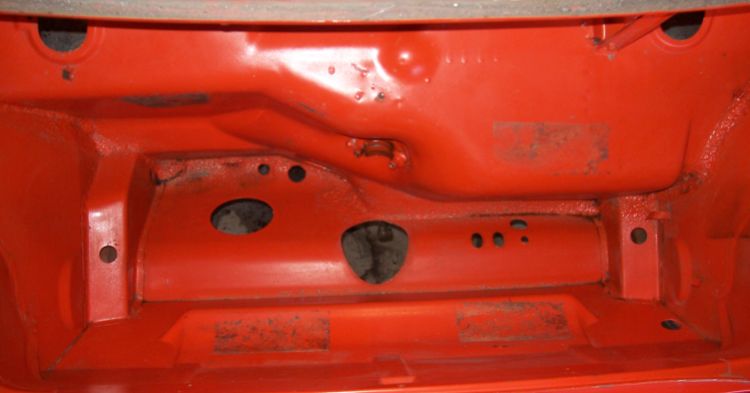

Tonight I pulled my tank and gutted everything in the front trunk, I bagged and tagged everything, next stop for the parts I am keeping is the powder coater.
I will be welding up all of the un-needed holes then stripping the remaining paint in preparation for primer.

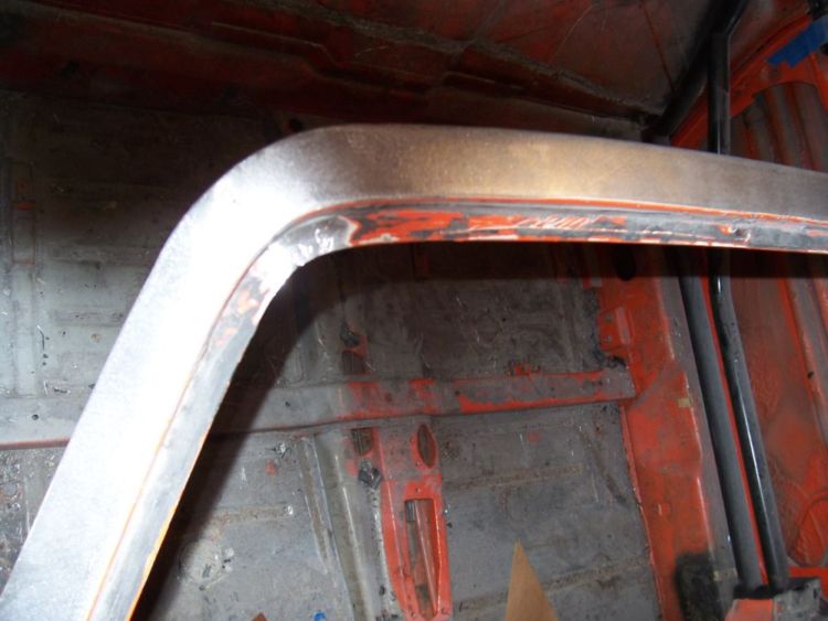

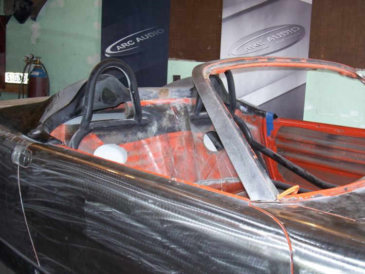

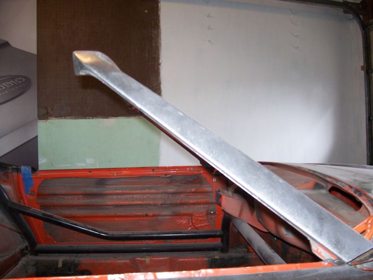

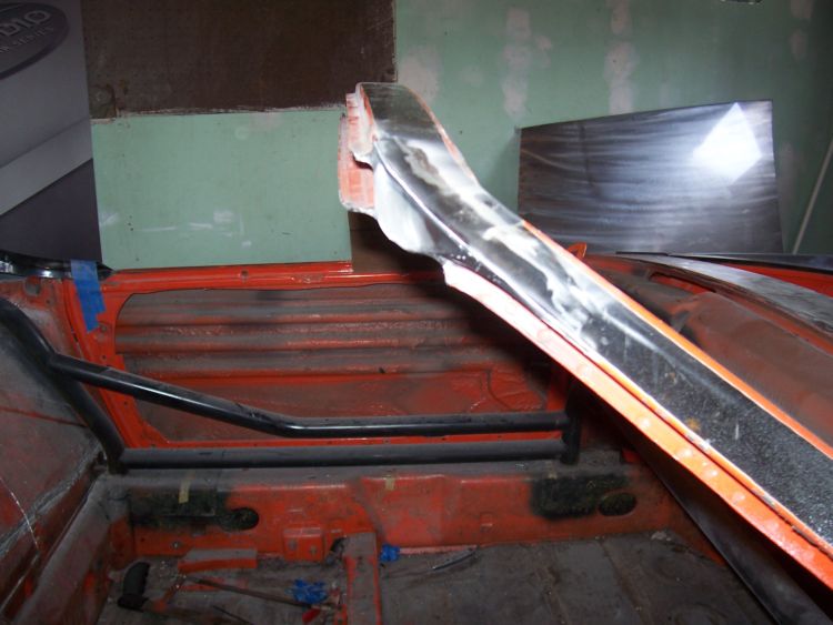

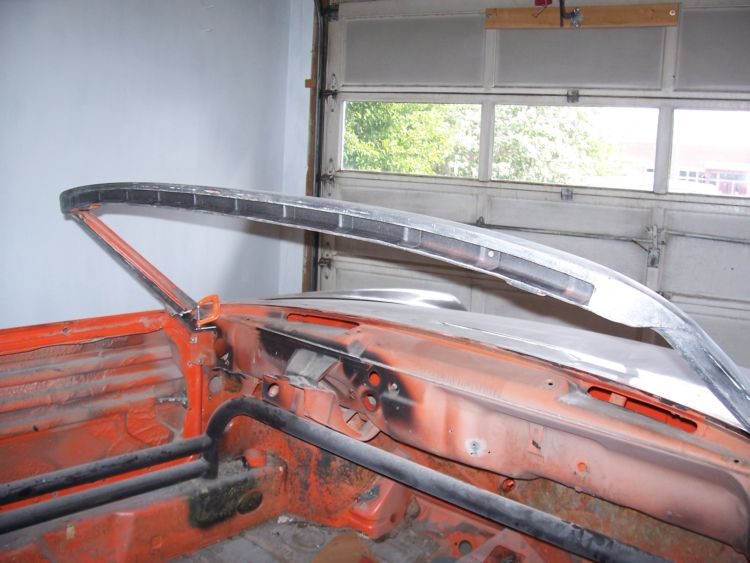

Well, it's been a while. Between painting my house and haven't had much time to work on the car!
I snuck away last night and got the windshield cleaned up and reshaped.
I started out by using the templates I made earlier to position the frame where I wanted it. I was going to mount the frame so the top of it was even with the top of the head hoops but it just didn't look right. Now that the lift off hard-top is looking like its going to happen having the frame a little higher will be better anyway. I ended up mounting the windshield an inch higher than the hoops so now the car will be 41" tall not 40".
I welded up the relief cuts I made in the corners, then I rounded off the corners of the frame and boxed them.
I then ground down the pinch welds and rewelded the frame with butt welds.
As you can see I left a small bit of the pinch weld at the bottom of the frame so I would have something to clamp to for final adjustments, this will be ground down once I have welded the frame in place.
(Did you notice the wall? I did a little painting while I was waiting for the welds to cool, I figure if I paint it four feet at a time that wall will be all white by fall (IMG:style_emoticons/default/biggrin.gif)
Here is a good shot of the new rounded frame.
I boxed in the corners but left the center un-boxed. The interior side and back of the frame will be wrapped in vinyl and I will make a matching removable filler piece for the center of the frame. When I make the top I will design it so its front lip fits into the center slot (with the filler piece removed) for a secure and fairly water tight fit.

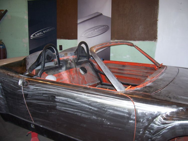

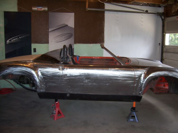

Here is how things are looking now.
Next I will fabricate the backing plates for mounting the windshield. I am going to plug weld in a second layer of metal inside the frame at the connection point so I will have a backed butt-weld, and double the stock metal thickness where the frame meets the cowl. I will then drill an access hole in the back of the frame so I can weld up the interior support plate, then weld up the access hole. If I do this right the frame will be much stronger than stock.
