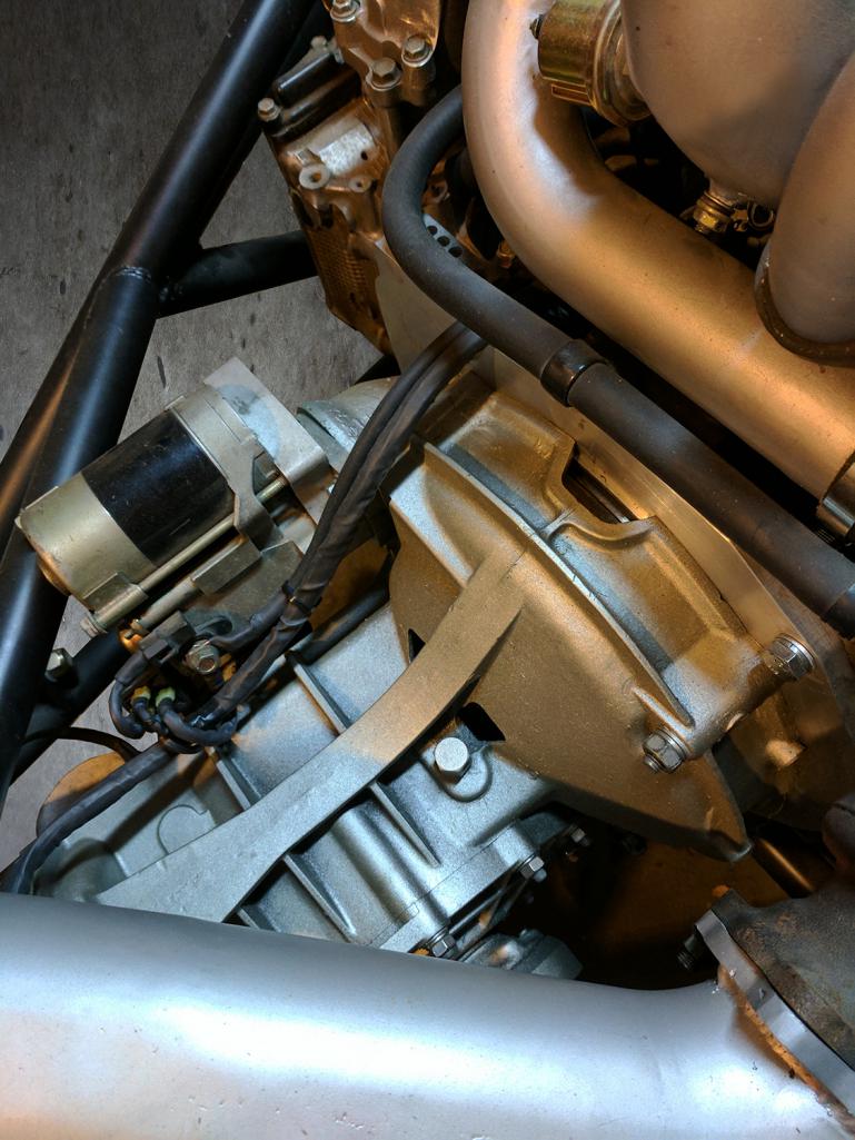

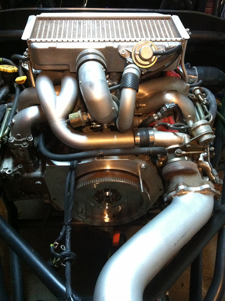

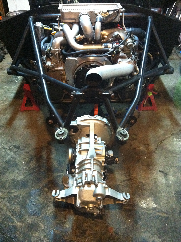

Flywheel is in!
Pressure plate and disk are in too.
Tranny goes in tomorrow!

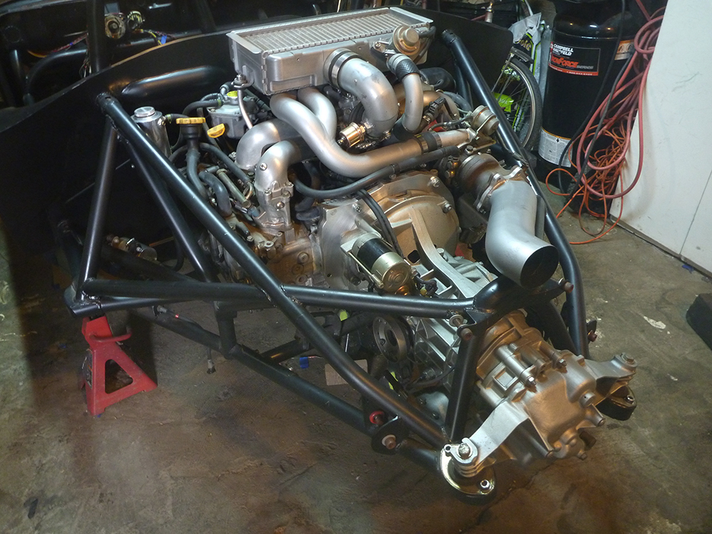

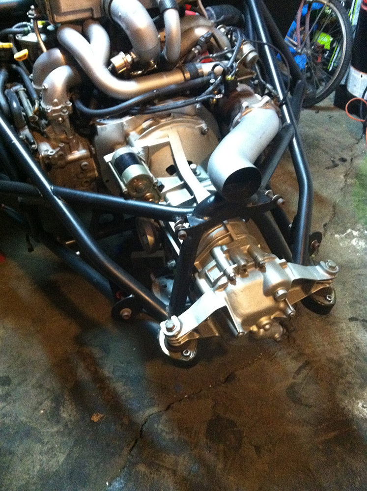

No problem, just trying to get this thing on the road!
I installed the tranny to prove that I am embracing this inferior technology, at least for now.
Time to start wiring it up!

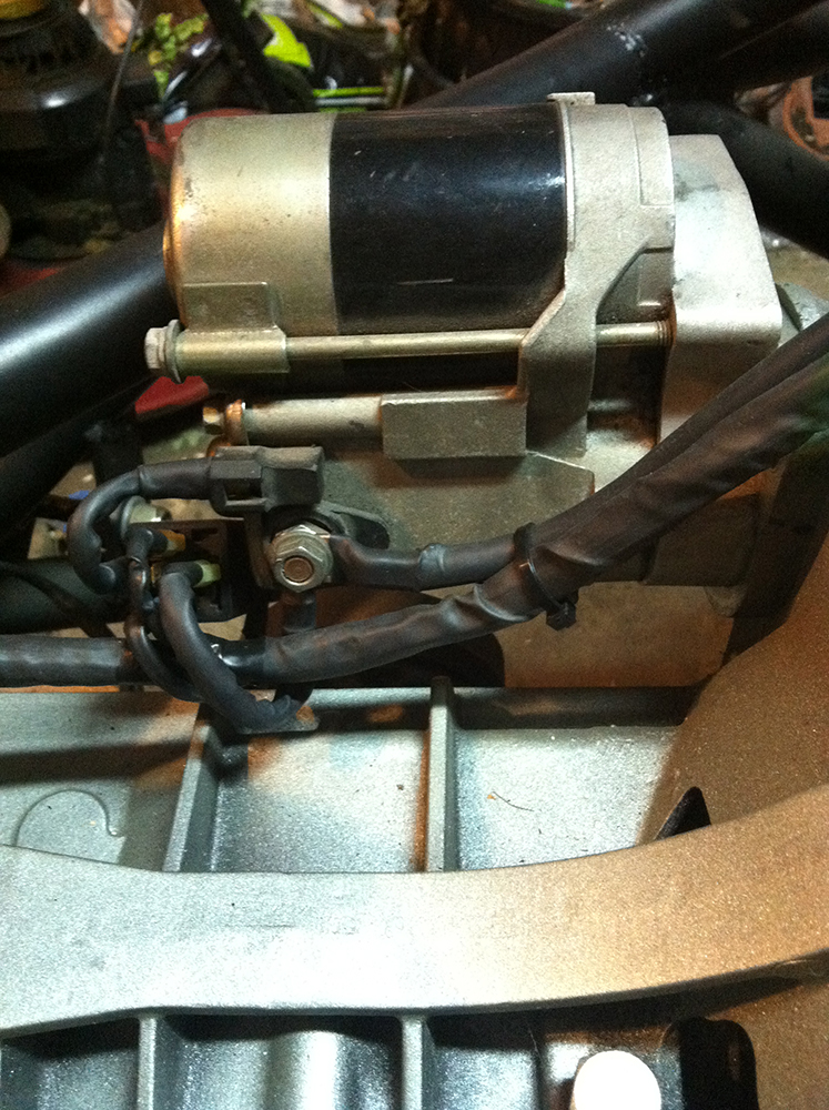

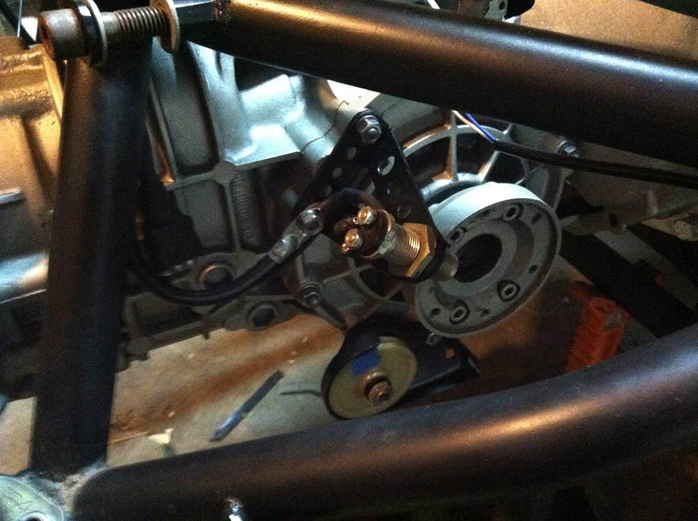

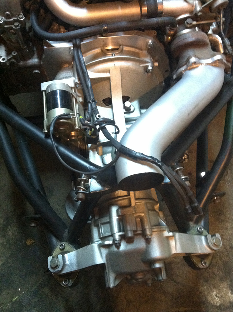

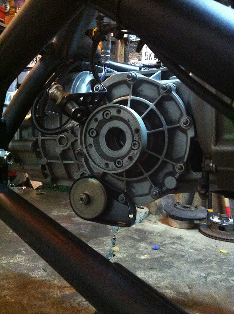

Tranny is wired up!
Starter and relay:
Speed sensor:
Ground strap, and plugs for rear lights:

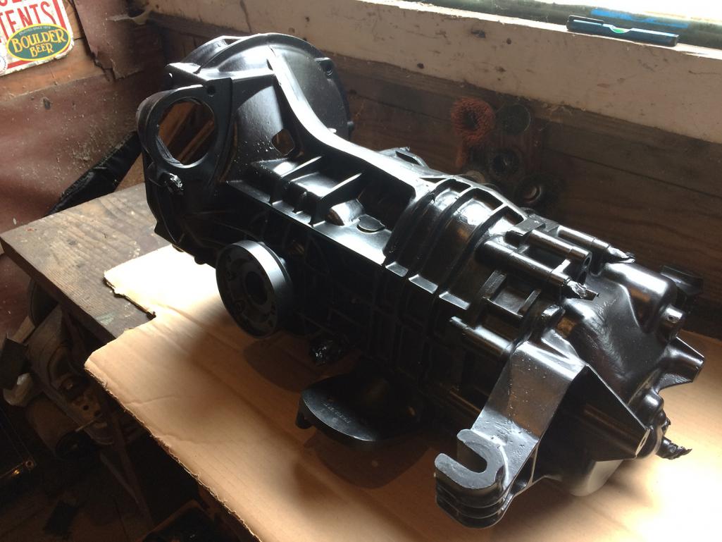

I had a couple people pm me asking about about tranny paint, this is the paint I am using throughout the car, I have found it to be very durable, and looks great.
It is available for aerosol and paint guns, I have used both on the car with good success.
Usually cheapest (but not cheap) directly from Eastwood.

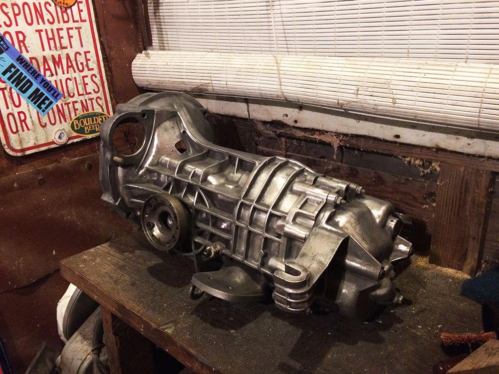

To repaint the tranny I started by cleaning it with soft wire and fiber wheels.
Then premiered with Eastwood black primer.
plymouth37

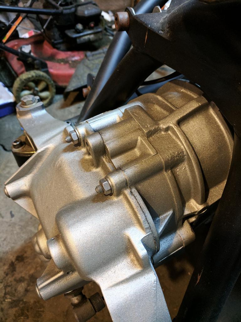

Here are some higher quality images of the Alumablast finish, clear coating is optional, I chose not to.

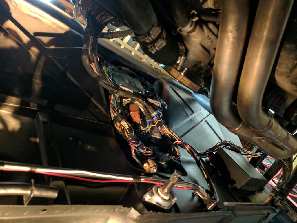

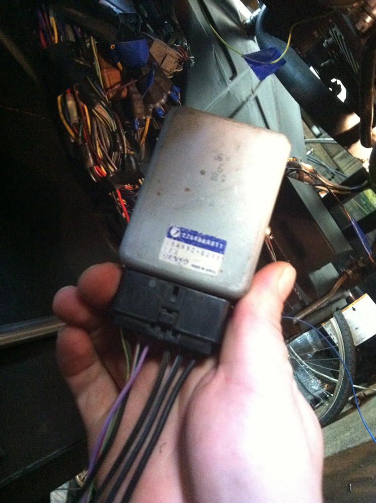

I am going to give the WRX fuel pump controller a shot, I didn't use it when I had the car running before, it delivers variable voltage to the pump based on engine need, and shuts the pump off after a couple seconds when the ignition is on and you haven't started the car.
Here it is installed, I also wired up the pump, As far as I can tell I think all of the wiring needed to start the car is done. Radiator and everything up front is wired as well. I will get some test runs under its belt then shorten the excess length out of harness and wrap everything. Eventually I will build a cover for all of this.
All of the dash wiring is good to go, and ignition and starter buttons are wired up for testing.

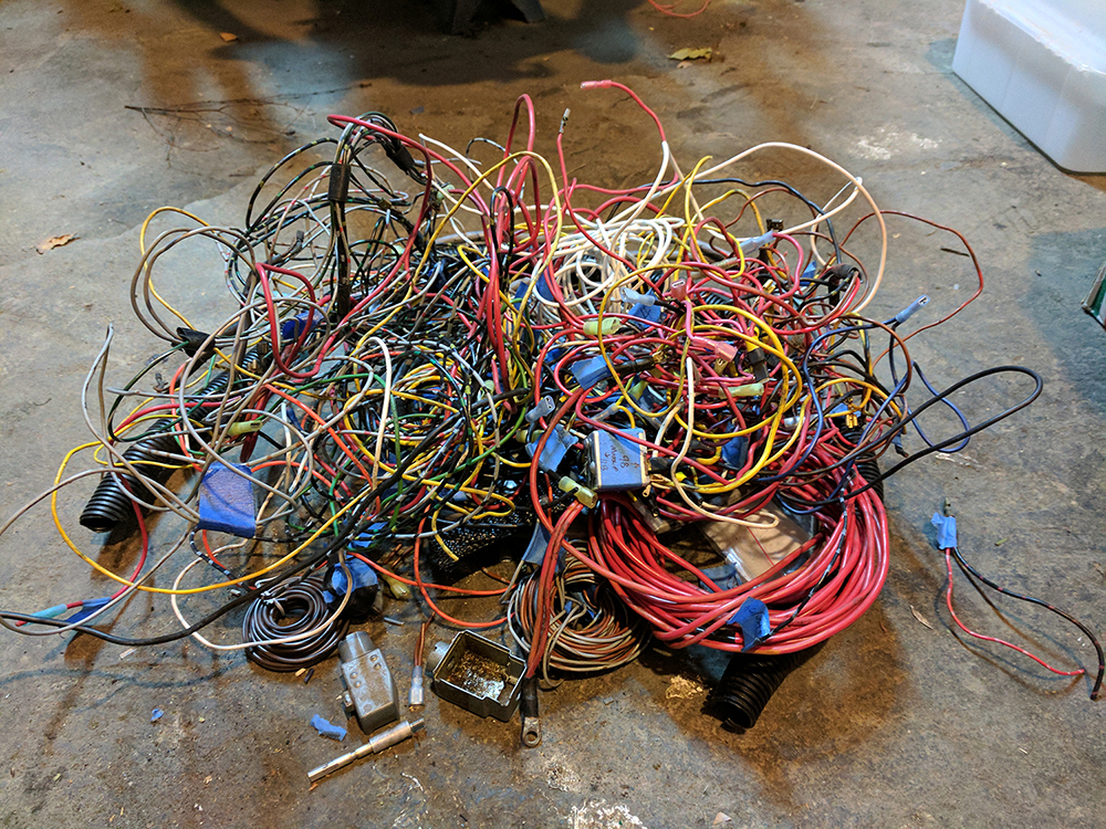

Looks like the chassis wiring is fairly done, here are the leftovers, nice to cull this amount of chaos and weight out of the car!
