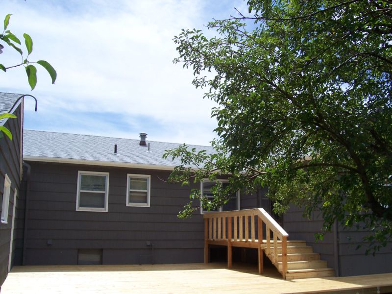

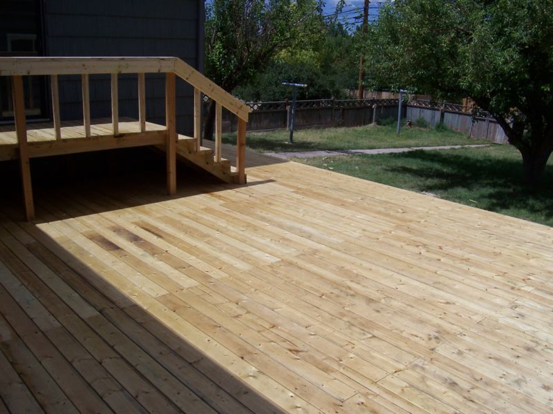

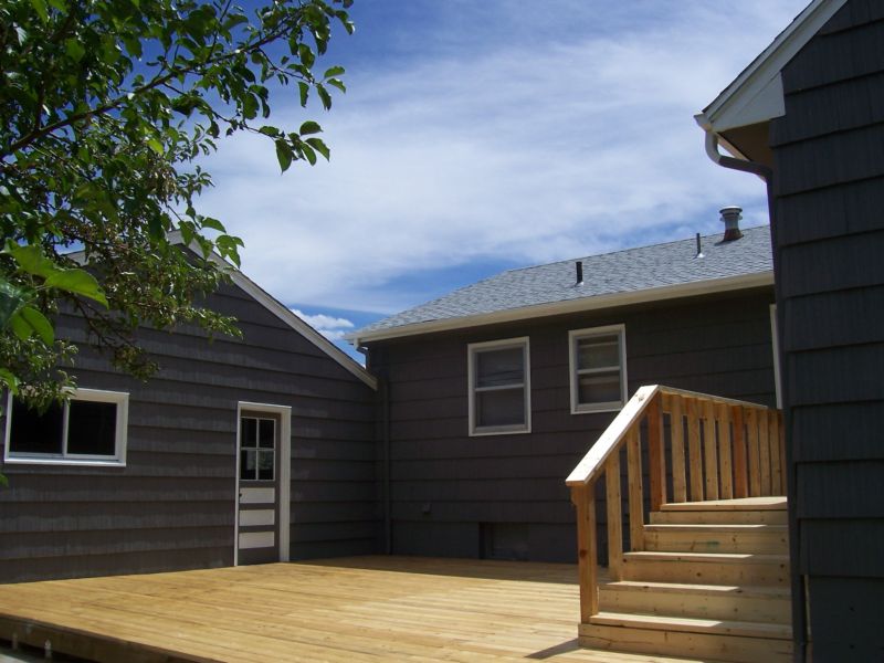

O.K. guys, the deck is DONE!
Here are a couple pictures of my huge deck, I think it turned out pretty well for being my first attempt at working with wood.
And yes now that this monster is done work will resume on the anklebiter on monday! (IMG:style_emoticons/default/piratenanner.gif)
It will be so refreshing to get back to working on metal...

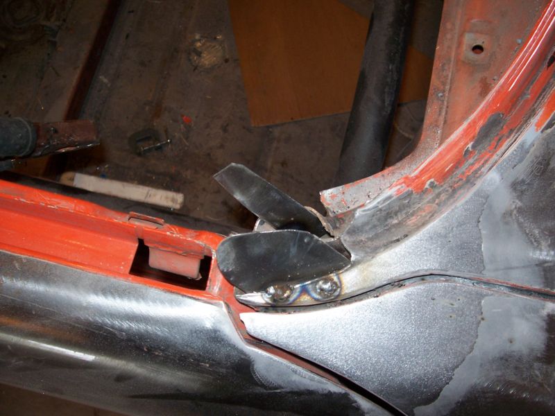

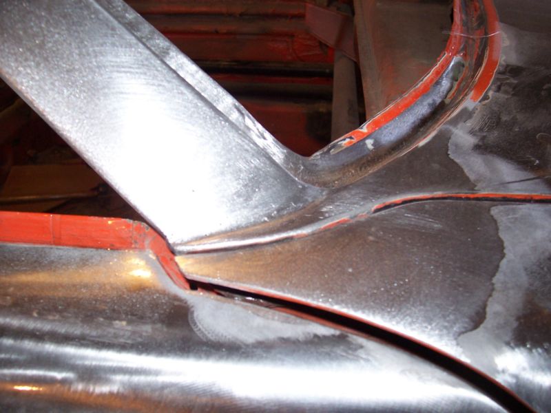

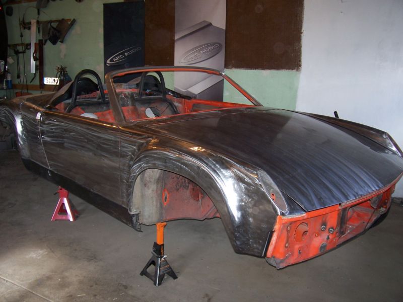

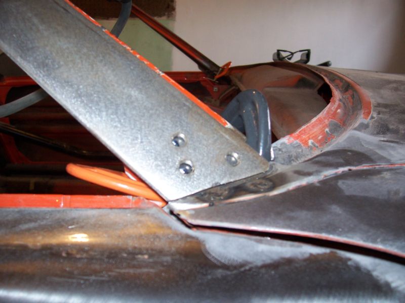

Due to public outrage regarding my lack of progress I have decided to start working on the car again...
Today I started out by tack welding in backing panels for the windshield frame, I figure the more metal I can weld into this area the better.
I then clamped the windshield frame in place and took what felt like an hour to make sure it was where I wanted it. I intentionally left a gap between the frame and the cowl so I could get good penetration into the backing plates.
Then I welded and finished the area. After I buy the right sized hole saw I will drill into the back of the frame and weld its inner structure.
Here's how things are looking now.
You can put away your pitch forks and torches now. (IMG:style_emoticons/default/biggrin.gif)
