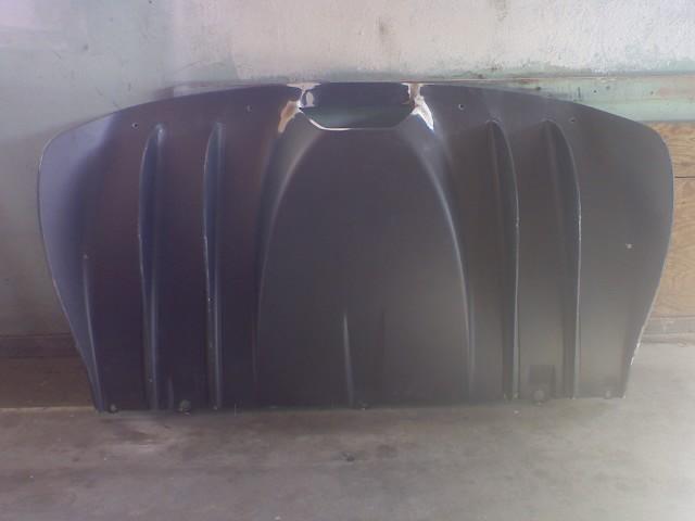

Rear diffuser? How are you going to do that? I want one (IMG:style_emoticons/default/biggrin.gif)
I got mine off of a Ferrari F430, the thing is going to fit really well, more on that later...
Don't suppose they have many of those laying around (IMG:style_emoticons/default/dry.gif)

QUOTE(Phoenix 914-6GT @ Aug 12 2008, 12:10 AM) *
QUOTE(plymouth37 @ Aug 11 2008, 11:29 PM) *
QUOTE(Phoenix 914-6GT @ Aug 11 2008, 11:18 PM) *
Here's what you do:
1) Join a Ferrari forum.
2)Wait for some guy to brag about the new carbon fiber F430 diffuser he got because he backed into a curb with the old one. (It happens more than you would think)
3)Ask how much he wants for the old broken stock one.
4)Obtain Ferrari diffuser for cost of shipping...
Try it, it worked for me! (IMG:style_emoticons/default/biggrin.gif)
I am in the middle of patching up the damage now. Should be an easy fix. Wait 'till you see it on the car it is HUGE!

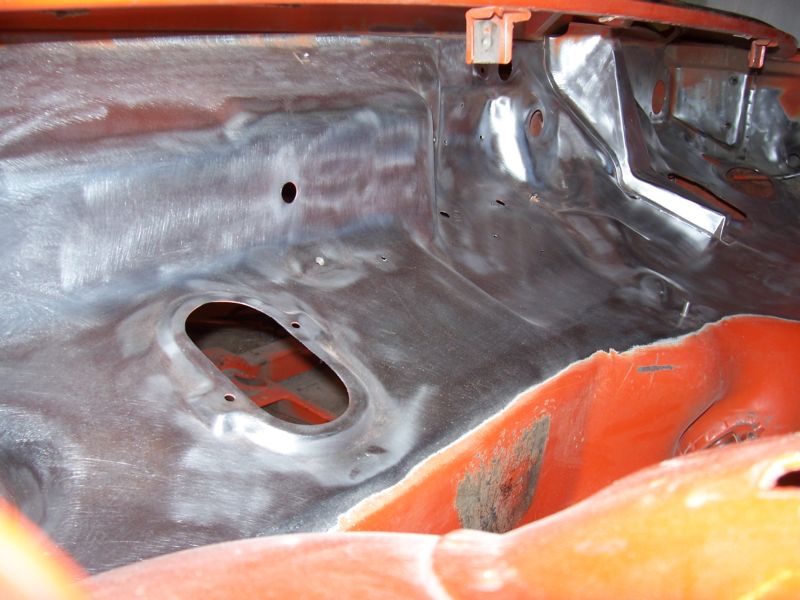

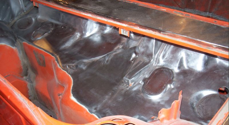

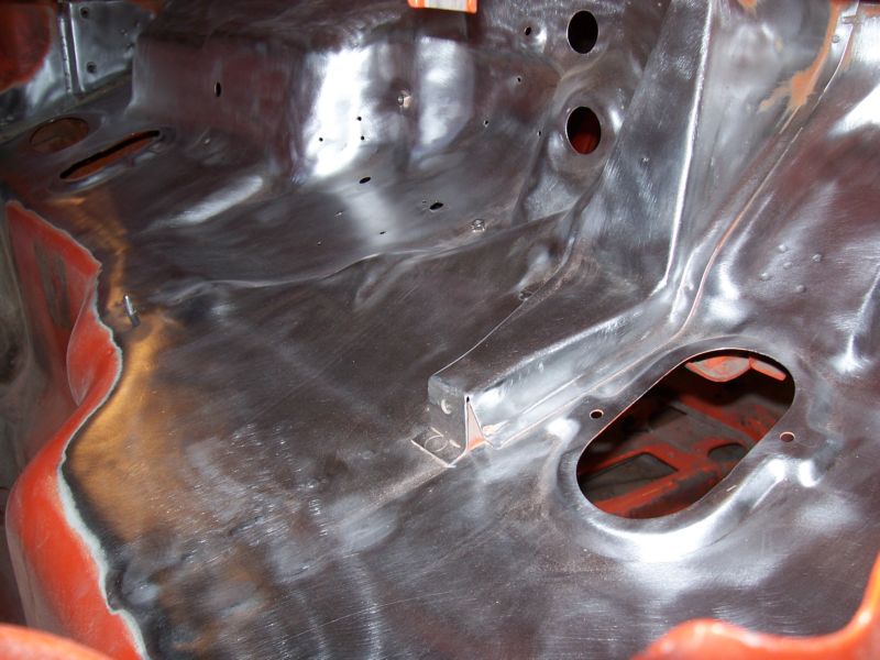

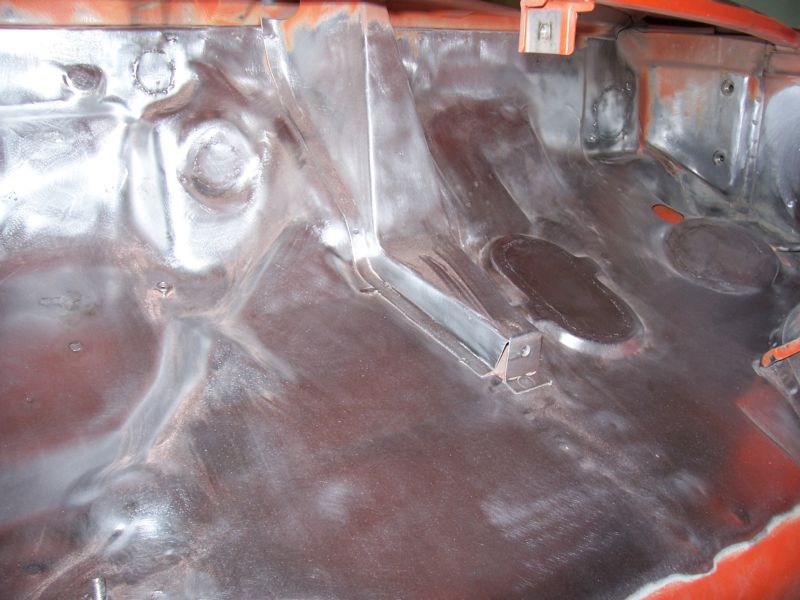

I stripped down the paint inside the cowl area.
Between the original owner and myself we managed to add quite a few extra holes in the cowl that needed to be filled.
Since the car will not have any climate control I filled the vent holes along with any extra holes that will not be needed.
It was tough working with the complicated thin metal but with a little high build primer it should turn out nice and straight.
Rand
post Aug 24 2008, 06:08 PM
Post #169
Cross Member
Posts: 7,415
Joined: 8-February 05
From: OR
Member No.: 3,573
Yah, such putrid rustage. OY!!!
Glad your tub is worthy. Keep it coming, ya freakin' weiner. (IMG:style_emoticons/default/laugh.gif)
Dammit, I'm an envious SOB. Grr. Sweet project. Go go go.

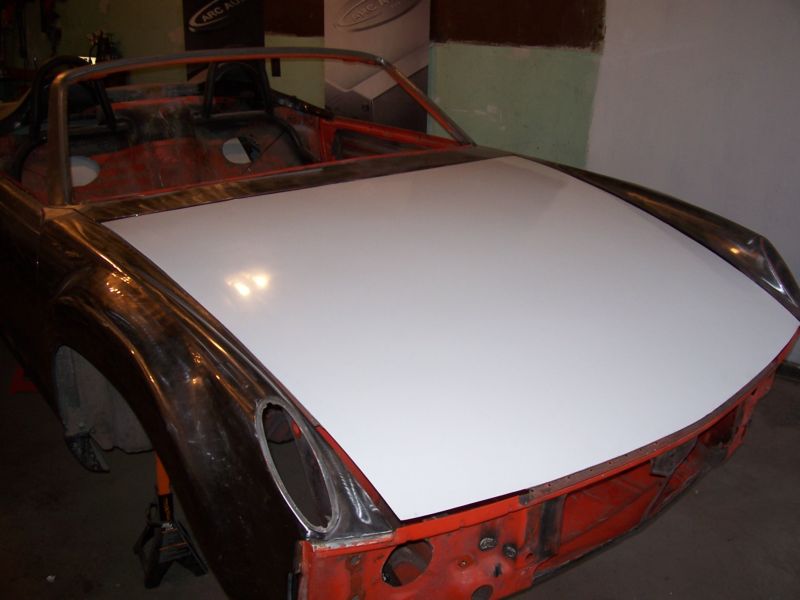

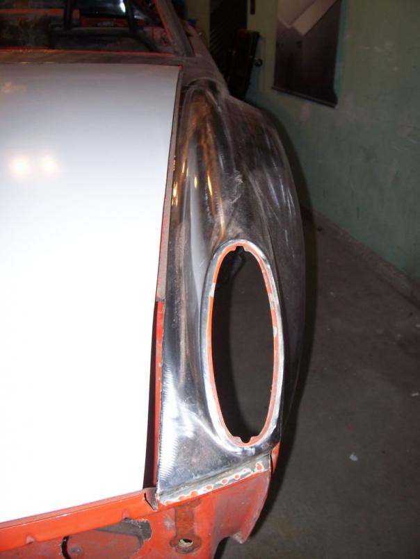

I also received a F/G GT-Racing hood, it weighs 12 pounds for a weight savings of 21 pounds.
This brings my weight savings total up to 427.9 pounds.
I am a big fan of Getty's work but for some reason they don't make a 914 hood with filled headlight holes so I had to buy a GT-Racing hood.
Over all the hood looks pretty good but it was cut way to small so I have to do a ton of work to make the hood gaps anywhere close to reasonable. Also the filled areas are not supported in any way so they are really flimsy, they really need some kind of inner bracing to keep them from ripping off at speed.
Seriously Getty step up, I know you are busy selling parts to the 997 guys but it is time to start making some filled hoods, this hood is going to take years to fix.

QUOTE(plymouth37 @ Aug 14 2008, 03:43 PM) *
Here's what you do:
(IMG:style_emoticons/default/av-943.gif) Too funny. What are you using to strip paint with Dana?

QUOTE(plymouth37 @ Aug 24 2008, 05:18 PM) *
I am a big fan of Getty's work but for some reason they don't make a 914 hood with filled headlight holes so I had to buy from GT-Racing.
My GT-R hood gaps needed ALOT of work and the lid to cowl edge rubbed too. I'm concerned about the flimsy corners lifting and am considering dual latches but I don't have much room with the Boxster rads. IIRC we both requested Getty CF full lids during the group buy but they just wouldn't make them. I went ahead and bought the CF front but abandoned the idea of trying to mold in fillers and match the weave...
