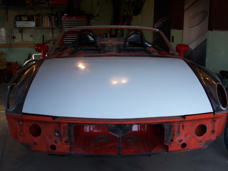

I'd be willing to bet that is the hood I sent back to them a month ago. I ordered form them for the same reason. No one else makes a race hood that I could find.
Chris made a hood using my stock hood and the headlight covers.
I would have loved to drop some weight but what can ya do?

I bought the hood used so I am pretty much stuck with it, on the bright side it was cheap enough to make fixing it worth while.
And no, the guy I bought it from had nothing to do with the poor quality and fit, it was this screwed up when it was brand new!
Time to pull out the 'glassing gear!

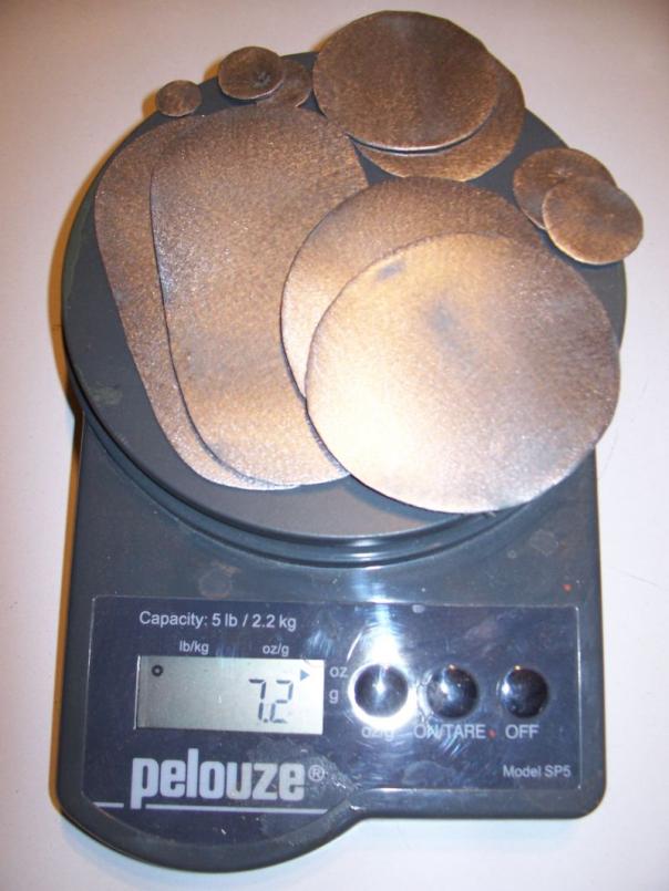

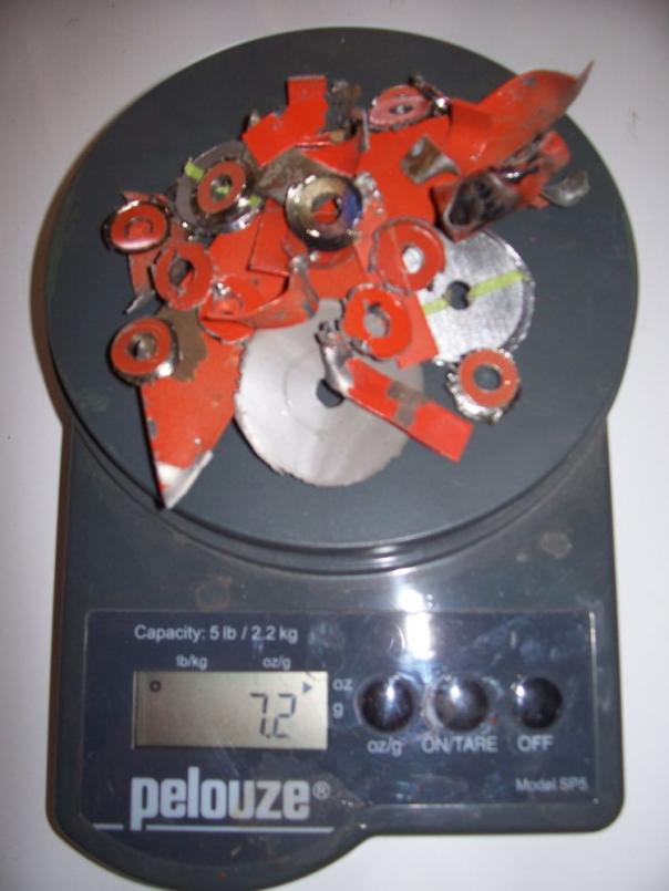

By filling the holes in the cowl area I added about 7.2 ounces.
Since this is a light-weight car I couldn't add this weight without cutting some weight too! (IMG:style_emoticons/default/sawzall-smiley.gif)
I cut off the remaining unused brackets and tabs, whipped out the hole saw and managed to trim off 7.2 ounces to counter-act filling the other cowl holes.
Here is the final product:
Yummy swiss cheese!
Expect to see a lot more swiss cheese in the future! (IMG:style_emoticons/default/chowtime.gif)

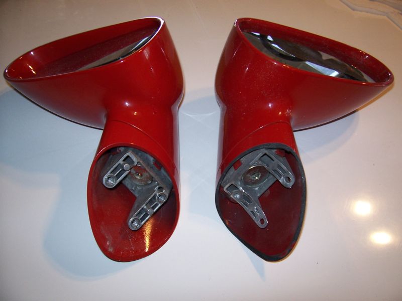

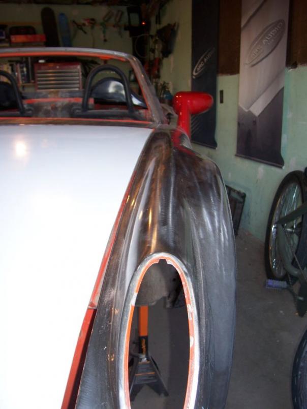

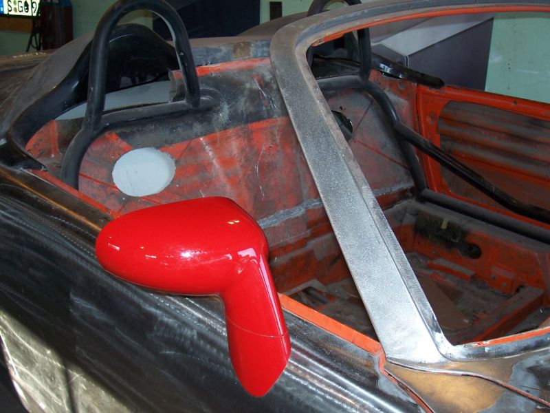

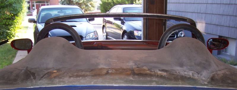

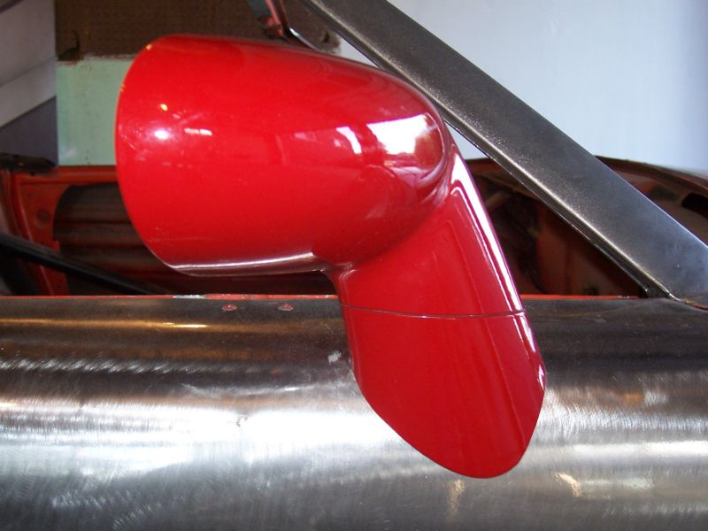

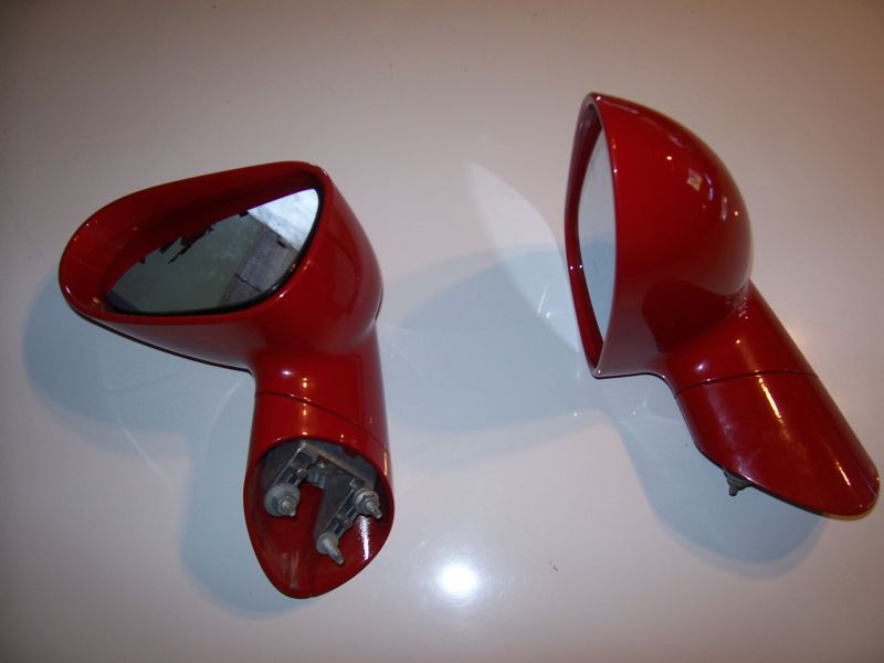

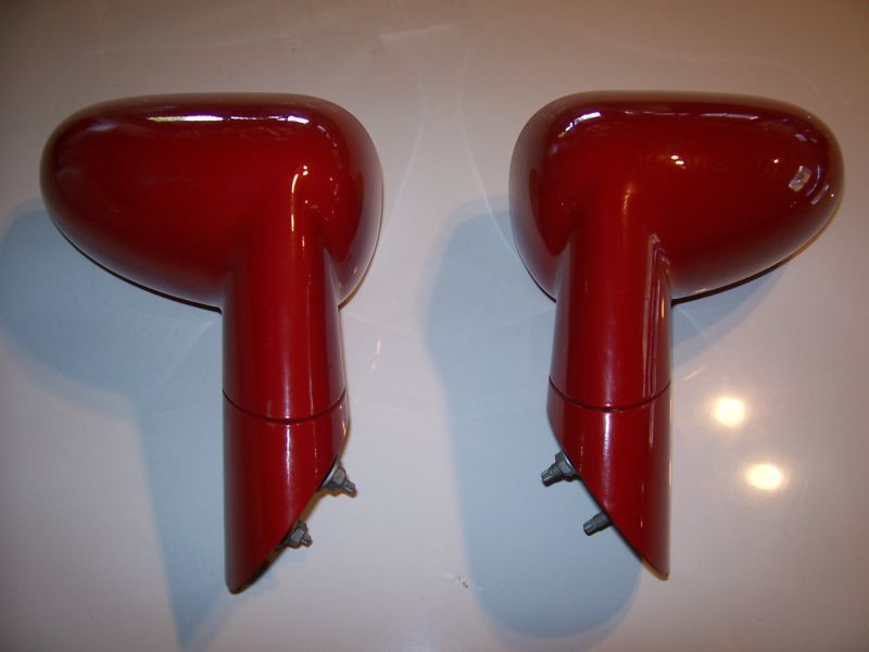

Since I am doing so much to update the the cars looks I couldn't just use the stock mirrors. There are a lot of choices out there but i finally settled on 2006 Pontiac Solstice mirrors, they are quite a bit smaller (and cheaper!) than the Porsche Aero mirrors and I think they fit the cars style pretty well.
Here is what I had to do to make them fit. I had to grind down the base to fit the contour of the door, then drill and tap deeper mounting holes. It was actually pretty easy to mount these mirrors, overall it took about an hour.

Those look surprisingly amazing.

Yup, I think they look good with the style of your build.

jesus dude, those look like a factory fit. nice work!
