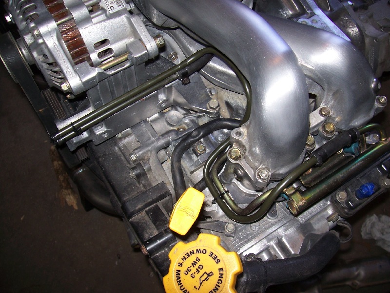

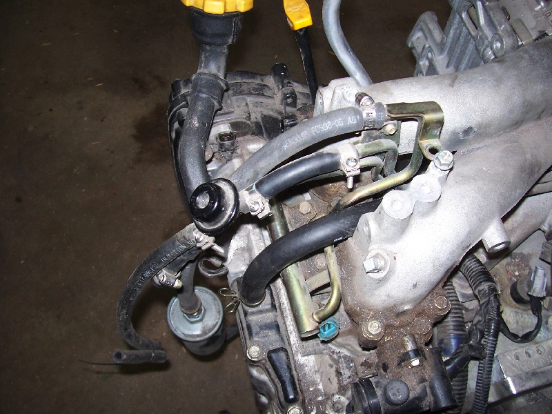

The WRX engine is not the best looking engine, I am trying to make it look as good as possible by re-routing and tucking everything I can.
I want to make the engine as easy to remove as possible so I am moving the connection points for all of the fuel and wiring to one location in the front of the engine.
Here is the original routing of the fuel lines.
I cut off part of the original lines and ran my own feed and return. Once I run the wiring to the "connection area" I will make a nice aluminum bracket that mounts both lines and the wiring to the alternator bracket

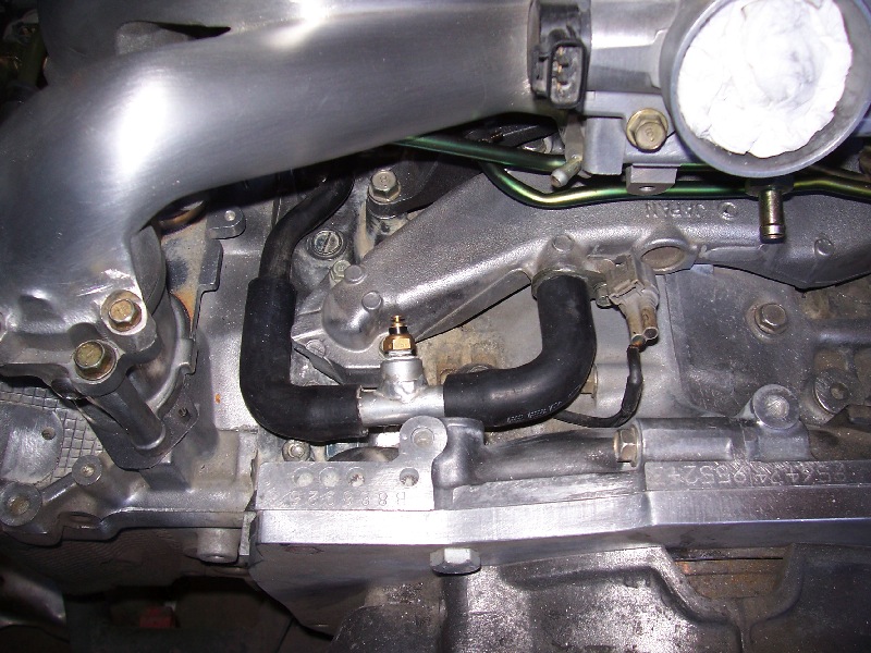

I also deleted the heater loop, I cut off most of the steel tubing for the system then replaced them with a couple rubber elbows and my temp sensor housing. I still need to find some sexy hose clamps since this area will be pretty visible.
Since I am not running A/C or P/S I cut down the accessory brackets so they are only set up to hold the Alternator, I lost 1/3 pound in the process.

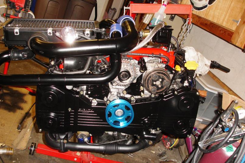

Awesome looking engine Ed, I remember welding up that intercooler kit for you like it was yesterday!

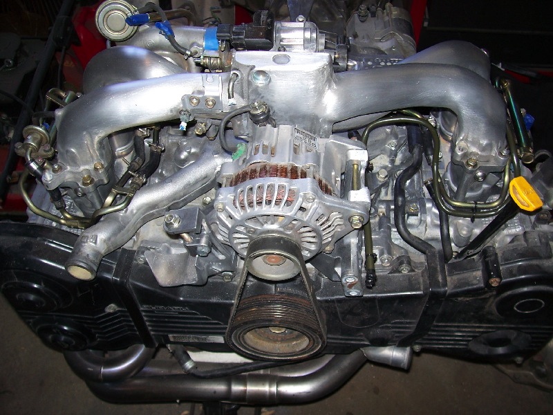

here is a quick pick to see if this works for you..
Yeah I have a long way to go before I see a running car..

QUOTE(d914 @ Feb 14 2010, 12:27 PM) *
Nice! I need to pick one up, that is exactly what I was looking for!

Yep seems like yesterday but it was in 2006! 2005 was my first ride in one of these conversions in your car in Vegas. I'll never forget that.
We did a ton of work cleanint/poslishing on this motor, and powdercoating everything we could. Unfortunately, after we got it in there you couldn't see much of it. But I know it's there...
One of the reasons for doing this was so the engine bay and underneath of the car would stay clean...NO OIL LEAKS.
So far I've put over 24k miles on my conversion with zero problems, except for one busted transaxle (my fault entirely....smoking those 11" tires is just too much fun).
Ed
