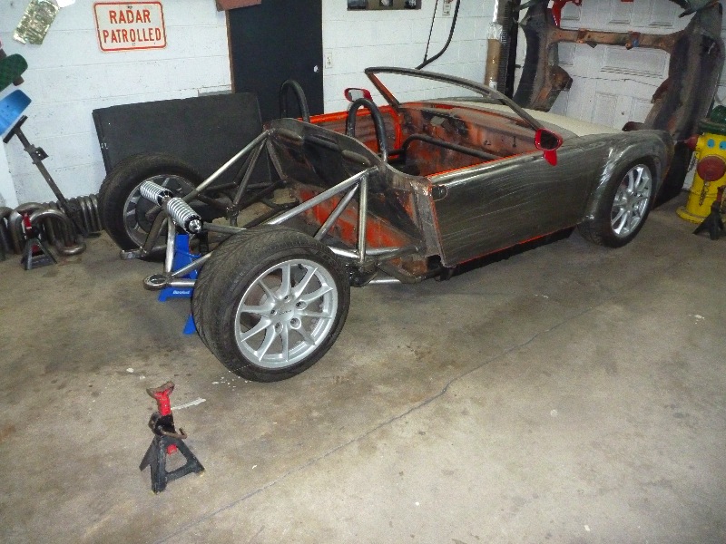

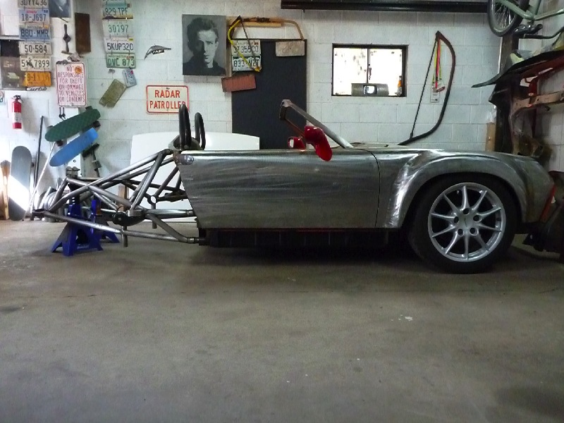

I made some progress today. I pulled the drivetrain, finished welding the frame, and made the new suspension mounting points. I should be able to mock up most of the suspension within a week or so but here is how things look now. It is hilarious being able to pick the car up with one hand while placing a jackstand with the other, this thing is going to be so light!

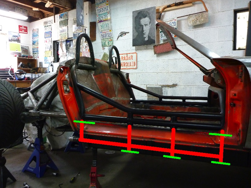

Can you post some more pics on how you connected everything into the longs?
I didn't manage to get any good pics of the entire inner structure so here is a crappy illustration. The red lines are the tubes that run within the frame rail while the green lines are the plates that tie them into the long.

There is a guy a couple blocks from me that has a good stock of tubing and a nice digital hydraulic bender that he lets me use. Although I did the passenger compartment cage myself with a hand bender while I was at Wyotech years ago.
The 1/8" steel bends pretty easy, I just tacked, then bent it a little around the contour and tacked it again about 1/2" from the previous tack weld, the heat from a couple tacks loosens it up and you can shape it pretty easily.

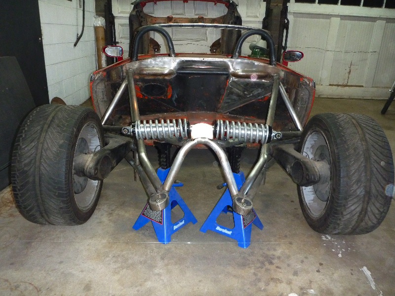

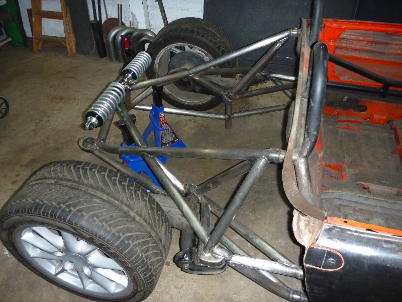

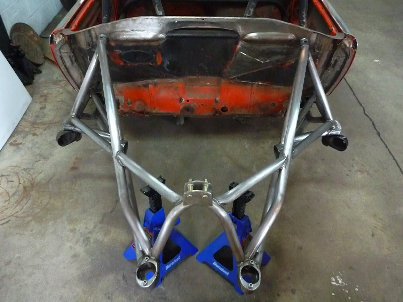

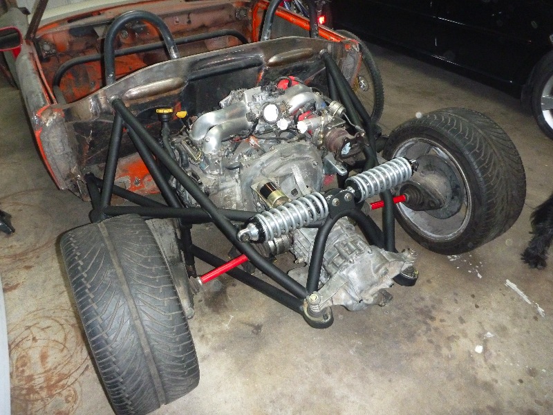

I made some progress over the weekend. I did a string and level alignment on the rear of the car and dialed in the the caster and camber. With the wheels aligned the bolts that hold the outer trailing arm mounts are exactly in the middle of the alignment slots so when the time comes to get it professionally aligned it should be an easy
(or at least possible) job.
I also tacked on the central strut mount and mocked up the struts.

looking forward to see what you are thinking with the pushrods and rocker assembly in the rear suspension.

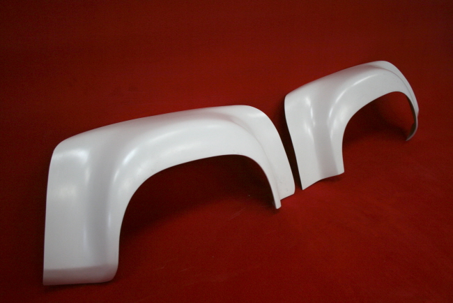

What are you going to do with the rear body? After seeing some cars on this forum, I'm in serious doubt about which rear fenders to use with the tube frame.

I am either going to buy stock looking fiberglass GT fenders or make them if I am feeling brave, then bond them to a lid to form a 1 piece tilt rear (kind of like a Muira). Then if I feel really really brave I will take a mold of my bonded rear and create a non-bonded 1 piece F/G rear.
My focus right now is on the chassis, I would like to get it drivable by next summer, then focus on fitting a body to the independent chassis.

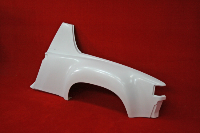

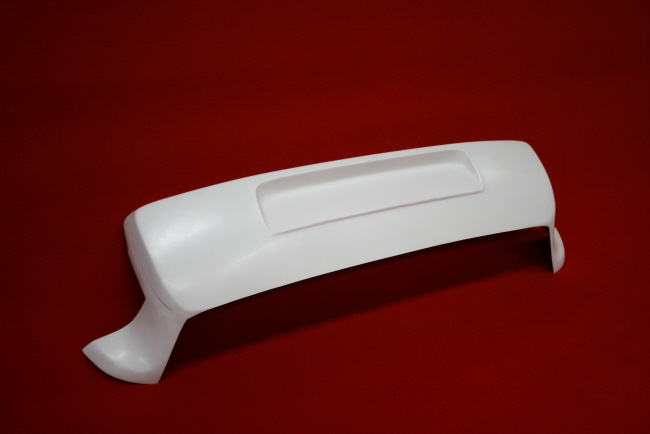

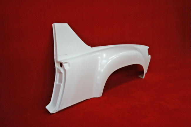

Brave undertaking!
I'm thinking about buying GT complete fenders from a German company here, They are not just the bulges but complete fenders including sail panel and door frame. According to the 914 parts guy here, they are of good quality. This company also sells just the rear bulges but then a tad wider then the GT. I'm thinking of re-crafting these on the GT complete fenders and also buying the rear bumper/lip that fit's the new width and after making these to an exact fit, have them reproduced in Carbonfibre. Then also the rear trunk in CF.
I love the Sheridan rear, especially the wider one, but i would like to be able to open the trunk, on the other hand, I guess it would also be possible to adapt the sheridan to single fenders...
Here's what I mean
The GT fenders
(IMG:http://www.914world.com/bbs2/uploads_offsite/www.f-s-h.com-12210-1285752456.1.jpg)
(IMG:http://www.914world.com/bbs2/uploads_offsite/www.f-s-h.com-12210-1285752465.2.jpg)
The tad wider fenders
(IMG:http://www.914world.com/bbs2/uploads_offsite/www.f-s-h.com-12210-1285752471.3.jpg)
And the bumper to match
(IMG:http://www.914world.com/bbs2/uploads_offsite/www.f-s-h.com-12210-1285752475.4.jpg)

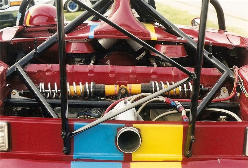

Great looking build.....your rear shock set up looks like what a friend of mine did to his race car....BTW this car is/was up for sale....unique center drive, hand built from the ground up 914 race car.....
