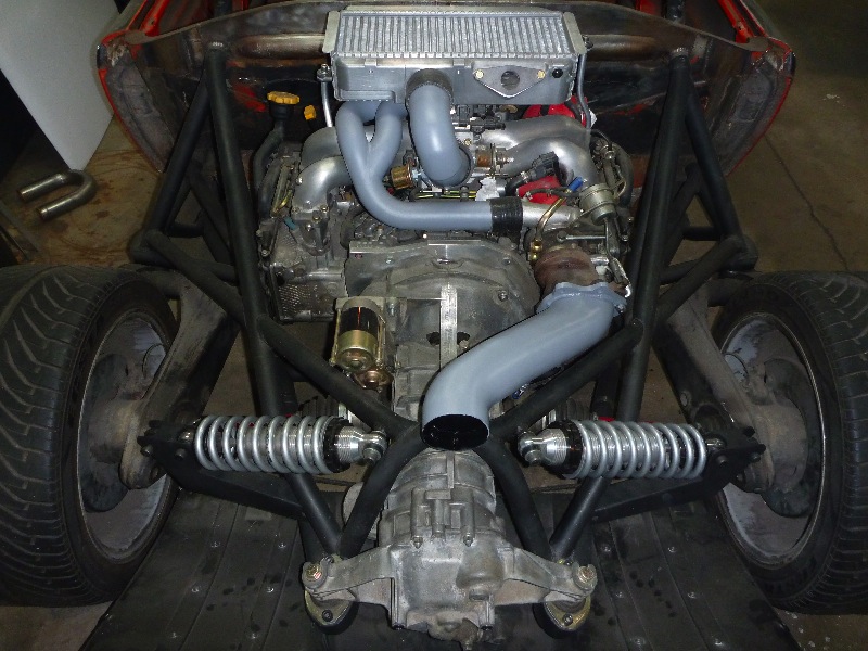

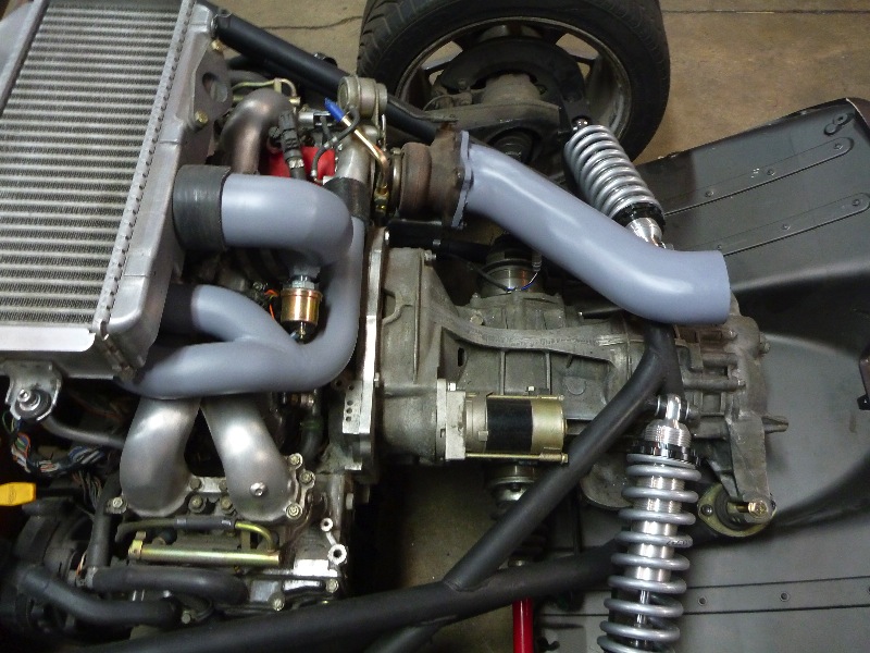

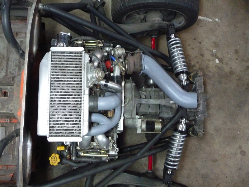

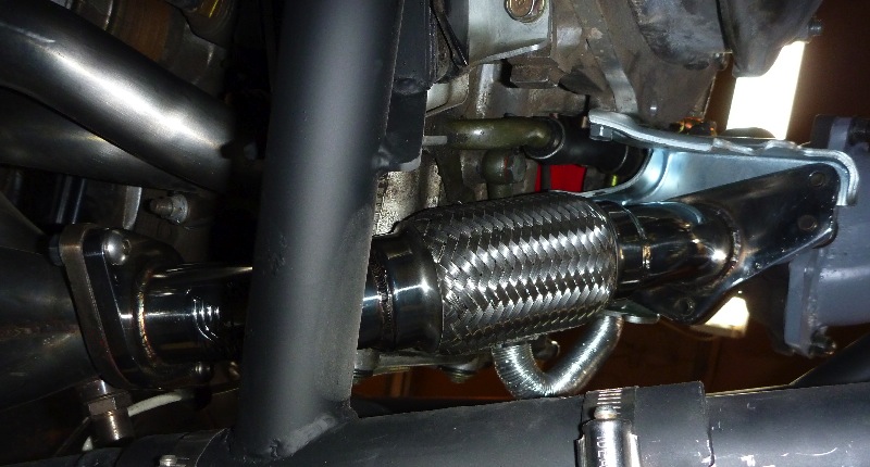

I finished the exhaust today. And here is a little diffuser action for you Kelty (IMG:style_emoticons/default/biggrin.gif) .

QUOTE(plymouth37 @ Dec 20 2010, 05:22 PM) *
Ohhh, you're such a tease. (IMG:style_emoticons/default/wub.gif)
Happy Holidays Dana......now get back to work! (IMG:style_emoticons/default/welder.gif)

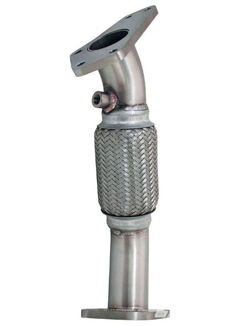

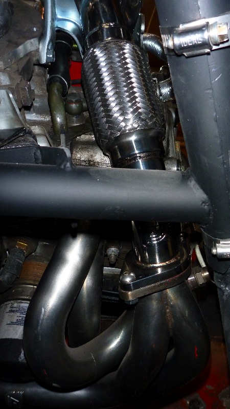

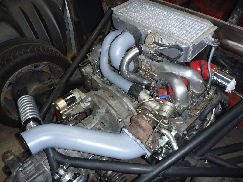

I got the last piece I needed for my exhaust system for Christmas, a stainless DC Sports up pipe to match the stainless header I have from them.
I managed to pull 4 out of the 5 studs from my renegade up pipe with out damaging them. Unfortunately one got a little galled while I was pulling it and cost $8 to replace! (IMG:style_emoticons/default/blink.gif)
I am glad I only had to buy one!

nickle high temp neversieze helps with stainless and aluminum and steel exhaust bolts and studs when you need to take them apart.

QUOTE(charliew @ Dec 27 2010, 02:27 PM) *
Good tip! The factory studs sure were in there good, had to drench them in PB blaster, double nut them, and use many big tools and swearing to get them free, it is a miracle I only damaged one of them!

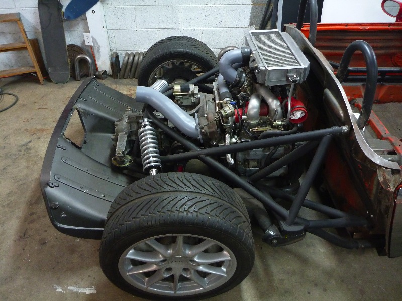

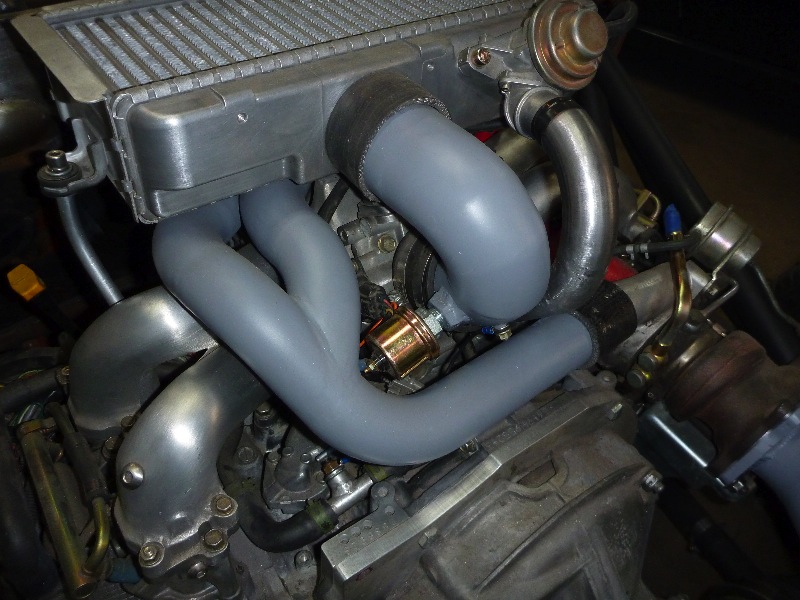

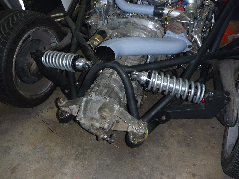

I only got in 3 or 4 hours of work today.
I welded up the blow off return tube and welded in the cantilever arm mounts.

I also built the grounding harness for the boost and coolant temp sensors.

Plymouth, where did you get the adapter to bolt that engine to that trans? What trans did you use?
plymouth37
post Dec 30 2010, 09:21 PM
Post #717
Posts: 1,825
Joined: 24-May 05
From: Snoqualmie, WA
Member No.: 4,138
QUOTE(AMG @ Dec 30 2010, 03:53 PM) *
The adapter is from Kennedy , the box is the stock 914 with stock ratios. You have to be careful with first but with as light as the car is, and the torque curve of the subie engine, I feel pretty confident running it.
