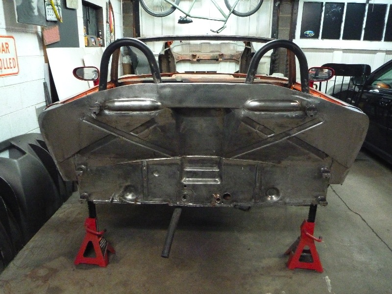

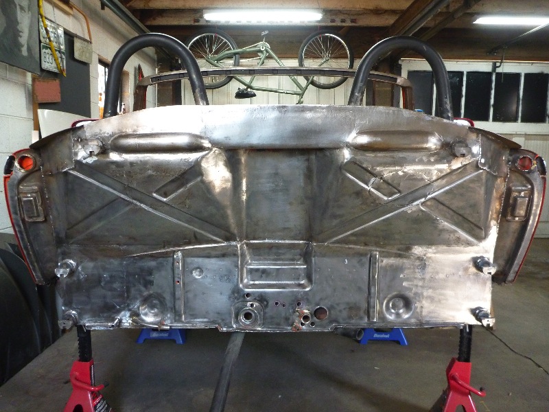

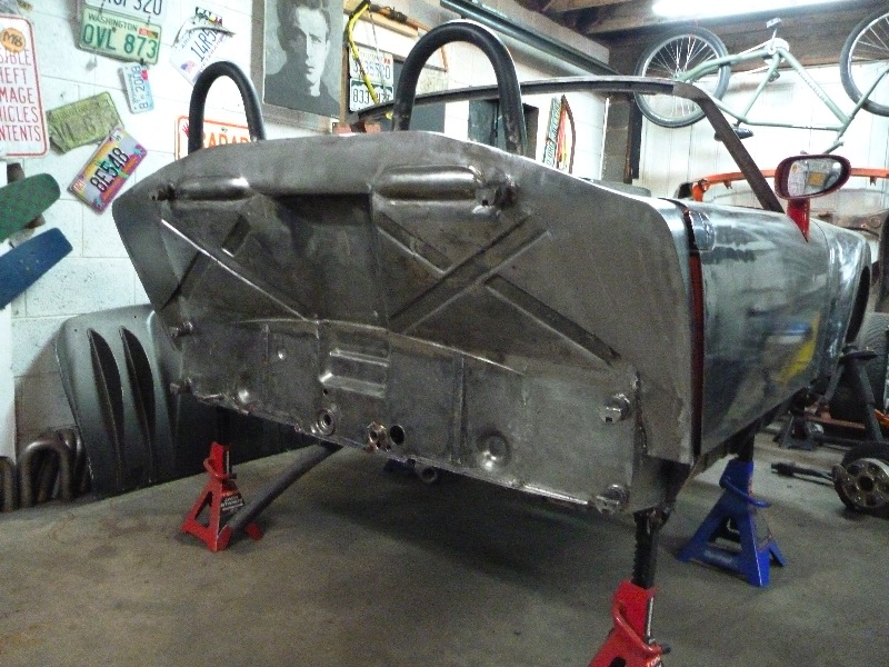

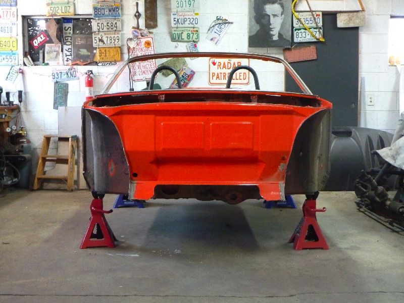

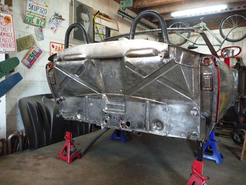

Spring break is upon us and by some miracle I have absolutely no obligations for the next 5 days, time to get some work done!
I pretty much wrapped up the firewall today, I boxed in the outer portions of the firewall and made a solid sealing surface around the bulkhead for the tilt up rear to rest on.
After welding all of this up the tub was noticeably stiffer and the door jambs fit much better.
Stay tuned for 4 more days of huge progress!

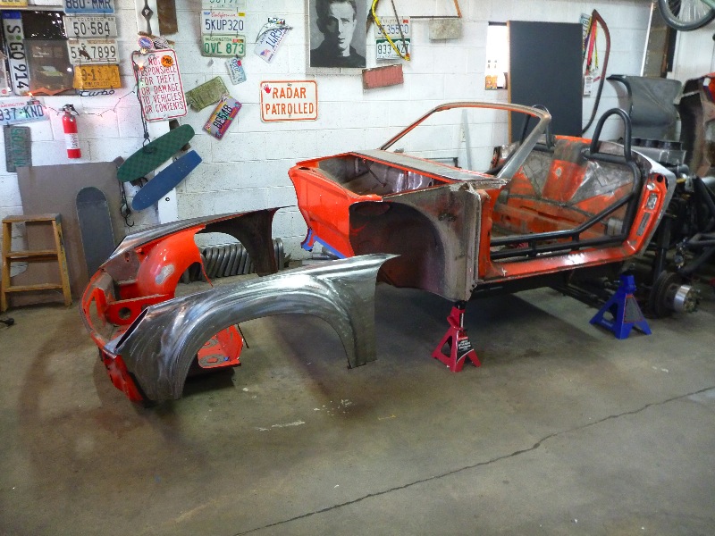

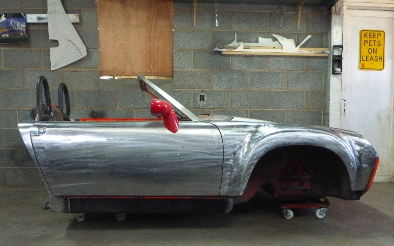

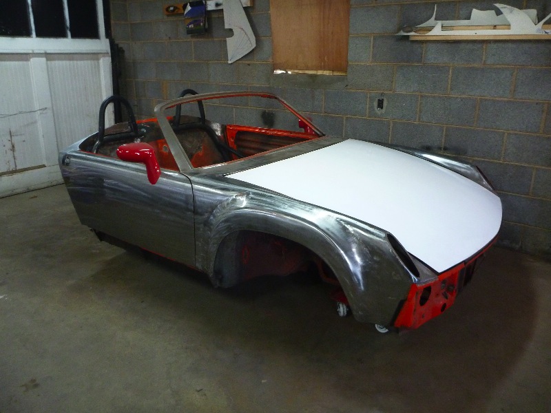

I finished welding up a couple details on the firewall, then got the tub down off of the jack stands to turn it around.
It is always startling to take a car off of tall jack stands, it is so tiny!

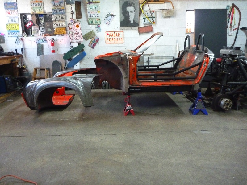

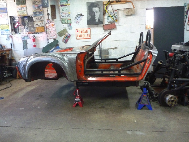

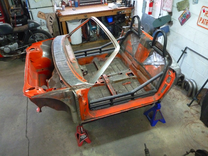

I turned the car around, put it back up on the jack stands, then pulled the doors.
I built a front suspension jig then taped out the cut line to remove the nose from the tub. Lots of cutting to do tomorrow!

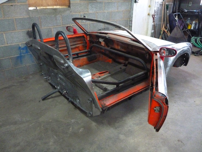

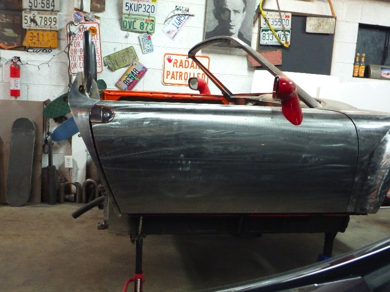

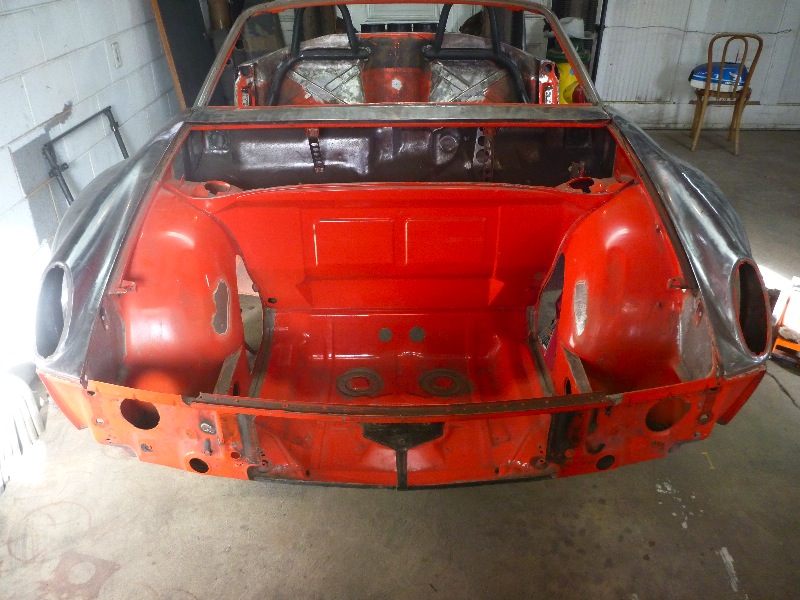

(IMG:style_emoticons/default/sawzall-smiley.gif)
If anyone was wondering, the nose as you see it weighs in at 52 pounds.

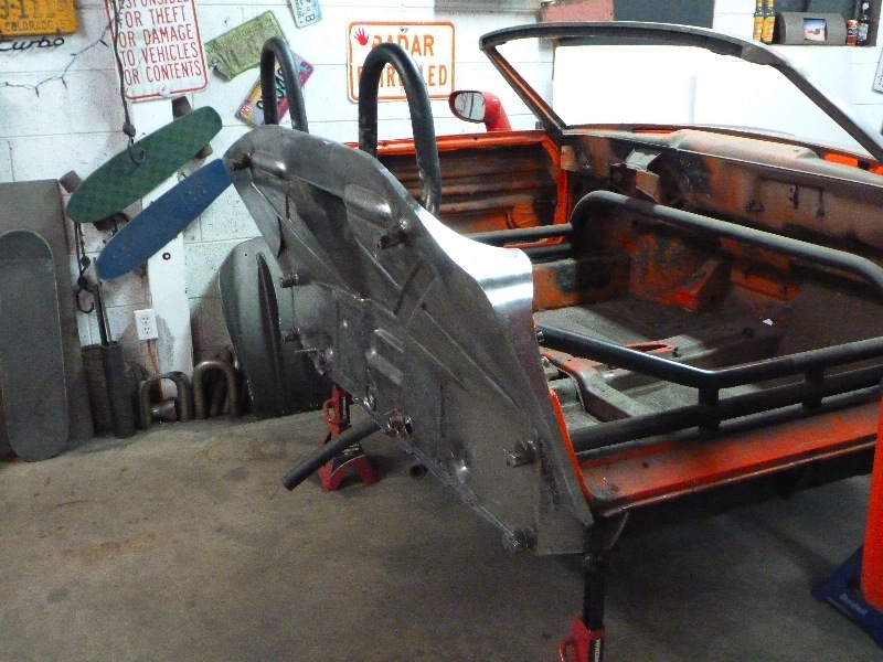

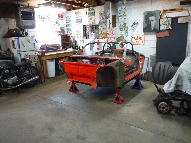

Another advantage to cutting your car into thirds, you can park it sideways in the garage and still have plenty of room for the wife's car!

QUOTE(plymouth37 @ Mar 23 2011, 01:10 PM) *
So does this mean it's going to have a flip open front with wish-bone suspension?
