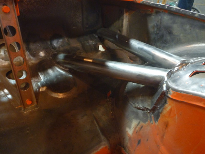

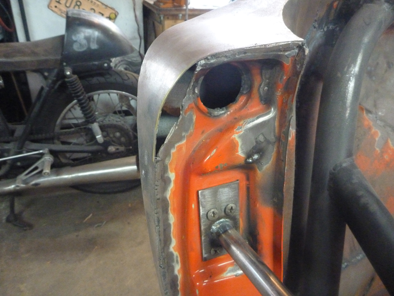

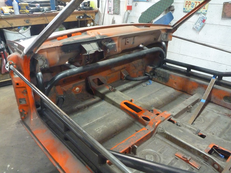

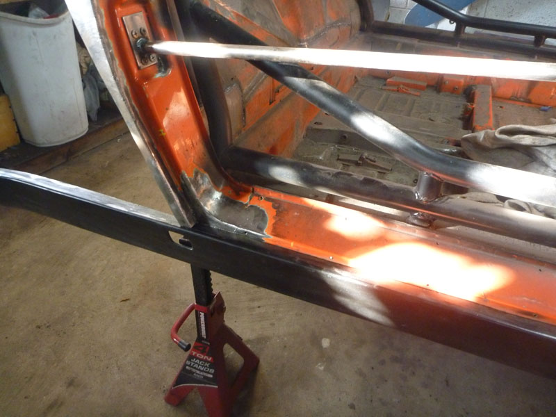

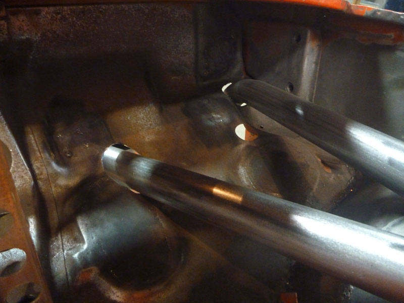

I have finally managed to make some time to work on the car!
I had an entire day so I decided to finish the last section of the cage; the connection between the front shock mount and the existing cage.
This is a pretty tricky spot to run tubing through on the 914, especially with my low knee bar but I did the best I could with it.
I started out by welding in base plates for the cage.
Not my best welding work by far but welding 1/8" plate to sheet metal is super tricky.
Next I welded in a tube from the knee bar to the shock tower.
Finally I welded in a second bar to triangulate the connection.

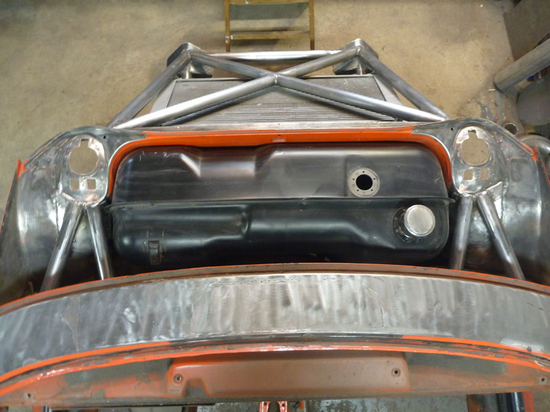

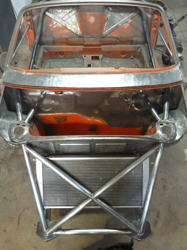

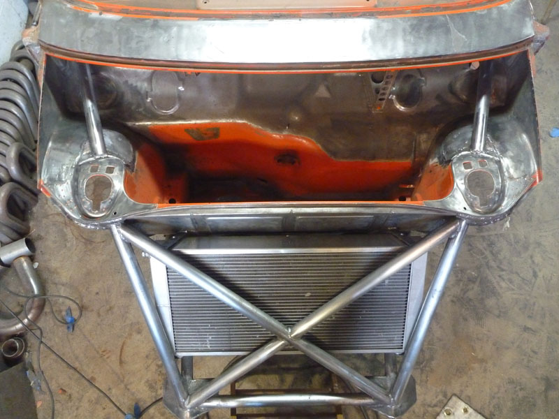

Here is a quick mockup with the tank.

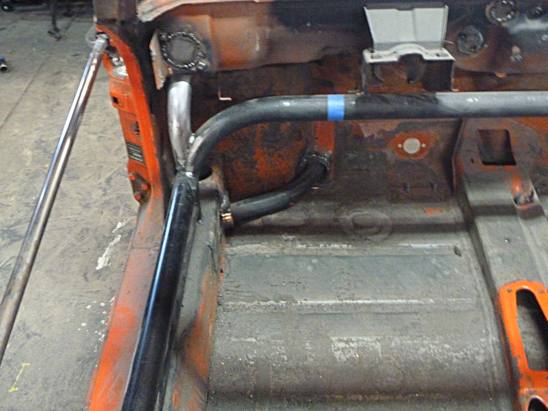

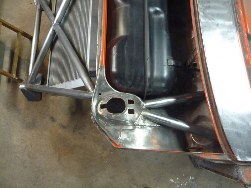

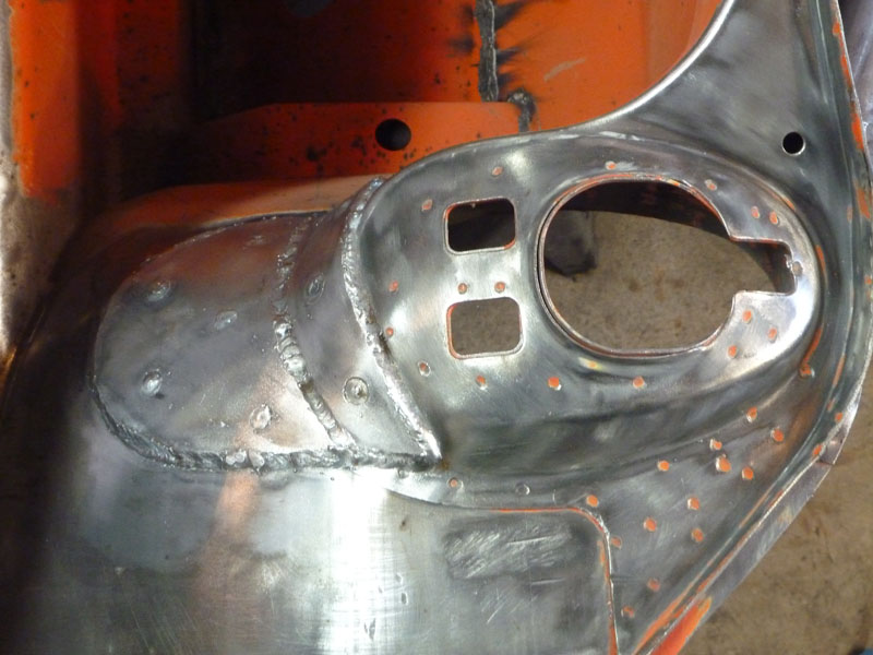

Not a ton of progress made today, I had a job interview this morning so I only had a couple of hours to work on the car this afternoon.
I didn't get a chance to seal off the holes where the tubing runs under the dash yesterday so I tackled that today.
I am glad I am pretty much done welding in this area of the car, access is a nightmare, welding upside down in a footwell sucks!
Before:
After:

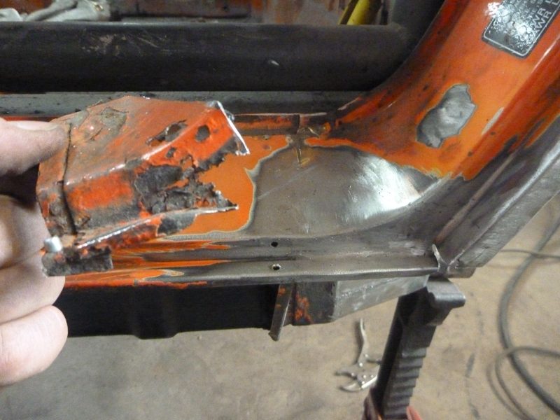

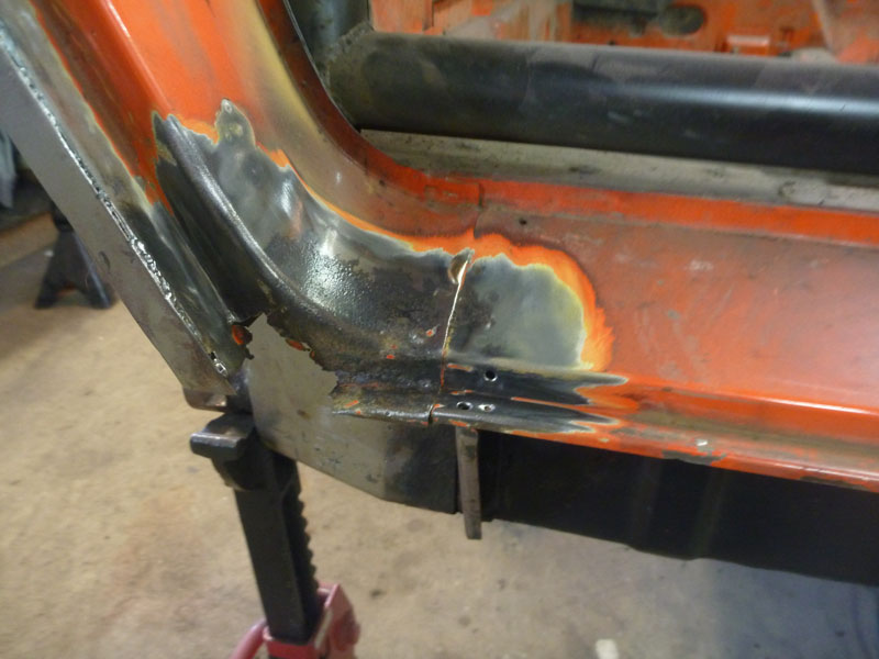

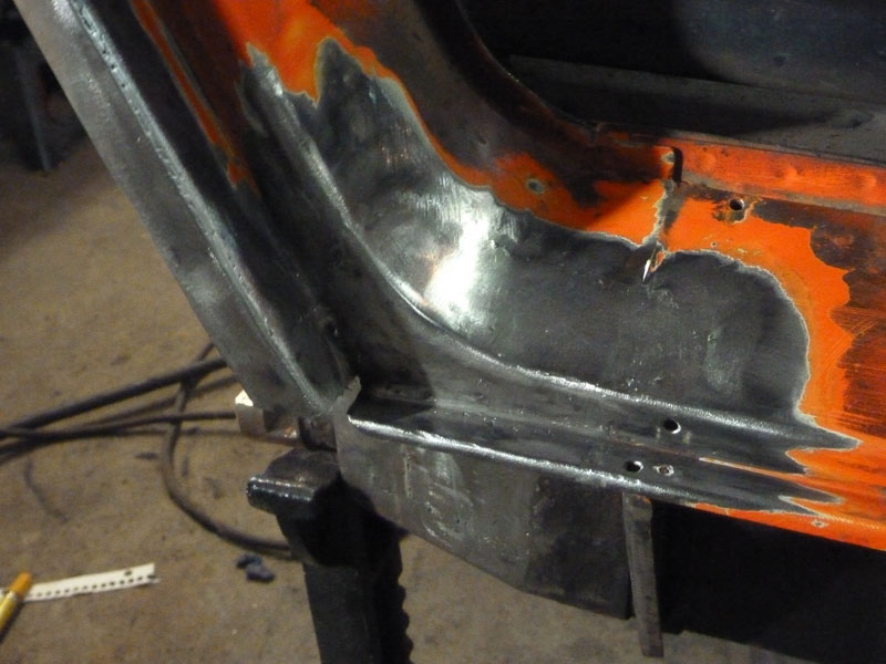

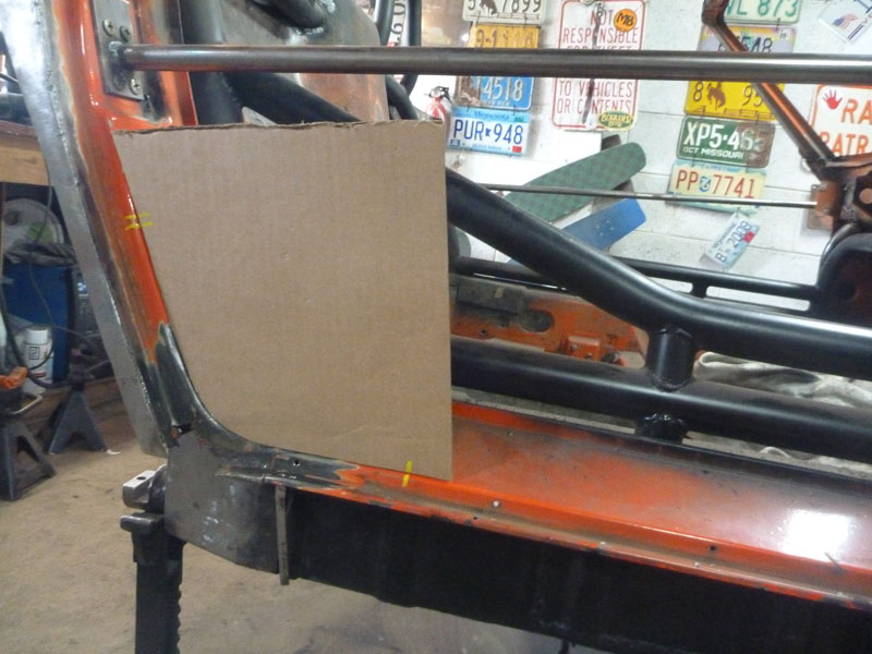

Today I started tackling the rusty spots on the tub, luckily most of my car's rust was on parts that I removed but there is still a little eating the door sill.
First I made a template of the opening to ensure everything lined up once I was finished.
Then I rebuilt the rotten area.
Finally I test fit the rocker.

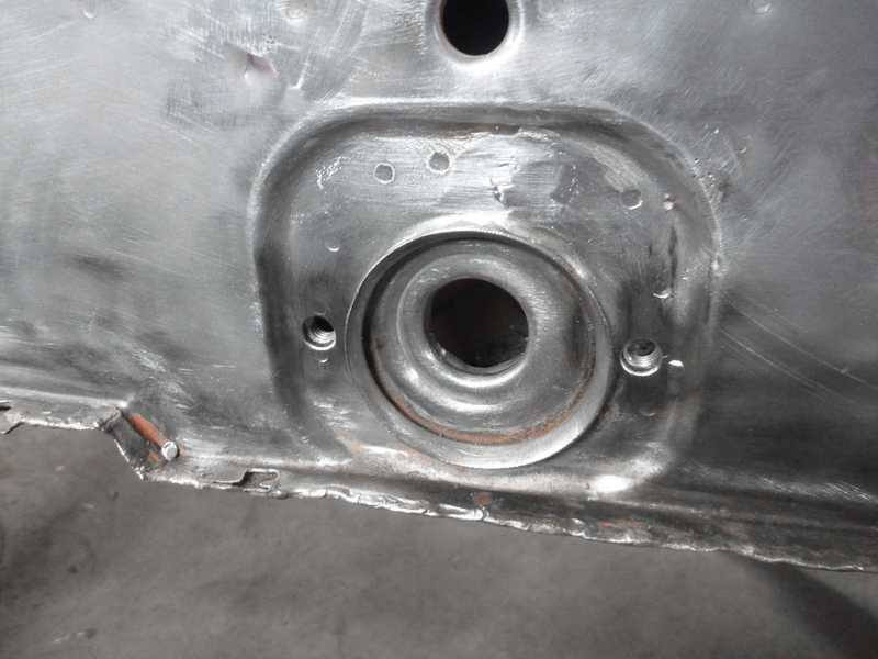

Today I repaired the other door jamb's corner that was rotted out.

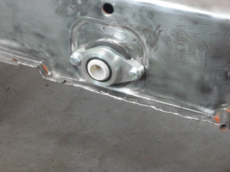

I also welded in nuts to mount the Jwest shift rod bushing.

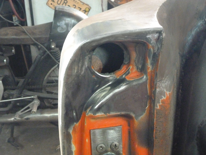

I never really finished the area around the door handle recess when I built the firewall so I decided to clean that up on both sides.
I am shaving the door handles so I filled the area where the recesses used to be and generally cleaned everything up.

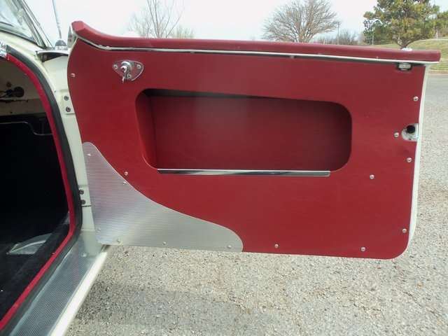

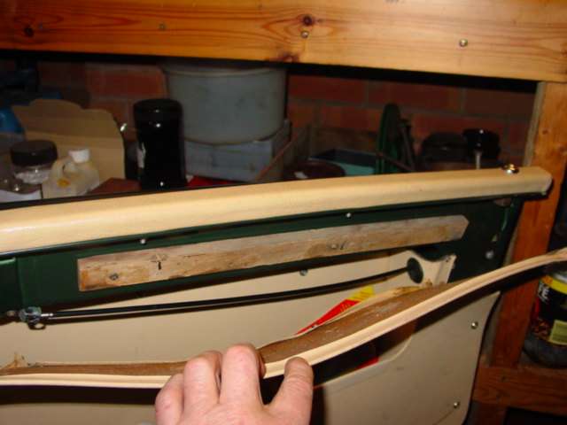

Member No.: 13,143
Awesome work. Where and how are the door popper's being mounted then?

QUOTE(513mugsy @ Jan 30 2012, 05:29 PM) *
Since the car will be a true roadster I am imitating the MGA door setup.
The doors will be hollow with a cutout for storage, inside the cutout will be a cord that runs horizontally through the door.
It will be anchored at one end and attached to the latch mechanism at the other. To get in you will just reach in the car and pull the cord. Super simple, super light.
MGA door cutout:
Cord behind door panel:
